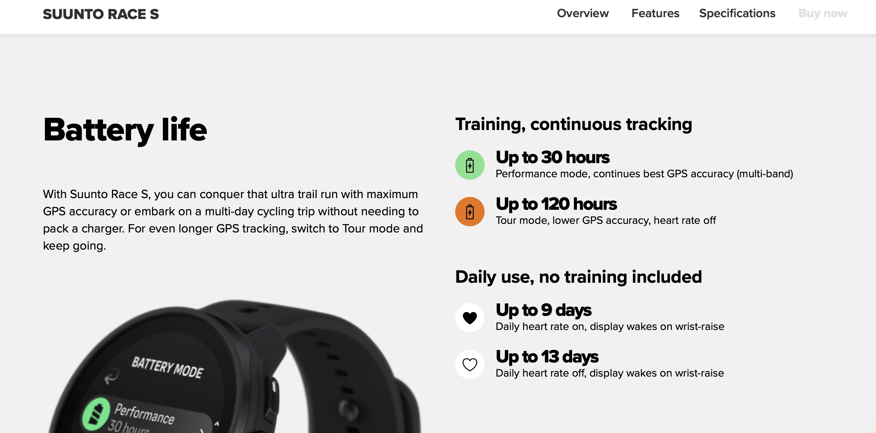

      24 hours ago I charged my Race S to 100%. I had 3 runs with the total duration of about 4 hours with external HR. The battery is now at 66%. This doesn’t seem normal at all. By the way, last night it was at 80%, and after that I had only a short 20 minute run. The first two runs were with external HR, the last run with WHR.
      4 hours of running should account for 13.3% of battery use. That means the battery discharged over 20% in the remaining 20 hours.
