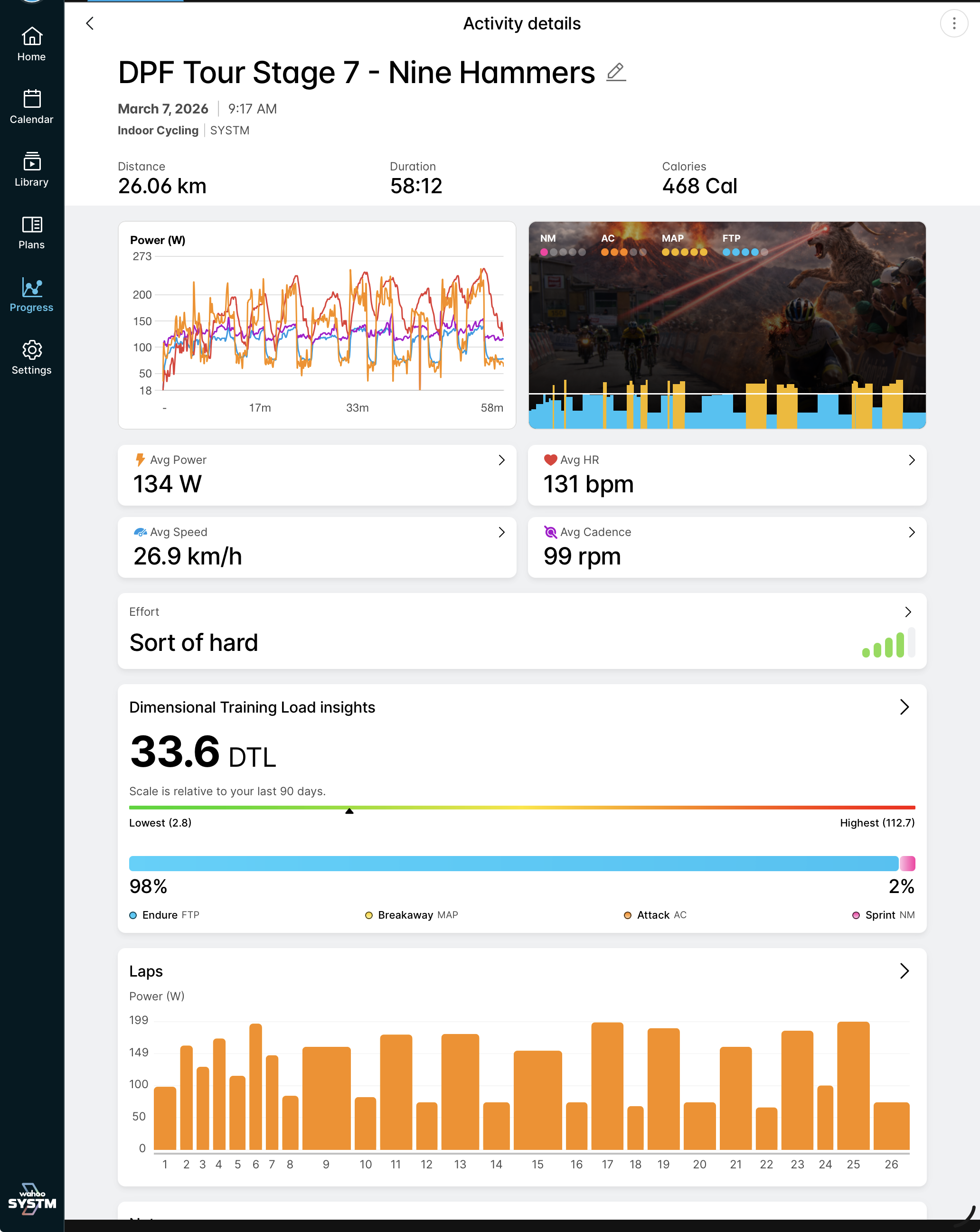

                      @Dwartus Ah, using it for “wear” info makes sense. With my Stages SB20 bike, I have a belt drive and it’s pretty low maintenance. Could you use simple cumulative elapsed time for this? Either just “do X work after Y hours,” or convert hours to whatever you think your “average speed” is? Or even use cumulative kilojoules?
                      As I noted above, if you also use an app that gives you a distance metric, then you can try adding/editing that into the final session results. You can do this in the app post-session.
                      For example, I do sessions using Wahoo SYSTM. It gives a speed/distance result which I ignore. On a recent session I get the following, along with Total Work 468kJ (Wahoo uses work energy in kilojoules for their calorie estimate).
                      So I could do the following estimates:
                      1 hour of riding = 500kJ = 30 km (rounding up)
                      Or one can use cadence. In this session I had average cadence of 99rpm so 58 * 99 = 5,742 revolutions. Either just count total revolutions or multiple by whatever distance factor you need.
                      atoponceA 1 Reply Last reply Reply Quote 0

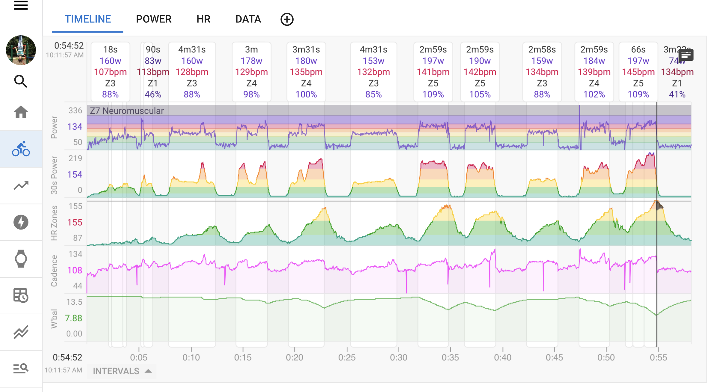

                          Here’s an example, a short ten minute warm up session I did today:
                          Notice I have two pushes of one minute each where I average 171w and 177w. At the timestamp I’ve reached my HR peak of 149bpm.
                          Meanwhile, I dual record with Suunto, and it gives me less info, only a HR graph and a fake “speed” graph that uses the reported distance (Suunto guess at it and always overestimates this but I edit it to match) and no ability to see power at all, much less get defined intervals.
                          As I need to use intervals.icu anyway for these sort of things, my motivation with the Suunto app is to get as much relevant data to it as I can natively. So I wanted so the Wahoo import you’re proposing. Even at intervals.icu I don’t show the “speed” graph in my analysis as I don’t see how it can provide me with anything actionable. The session I showed above from Wahoo, here’s how it looks at intervals.icu:
                          I could turn on a speed graph, but what purpose would it serve me?
