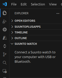

                    If the watch is connected to your pc, there is an option to look at the logs in the SuuntoPlus extension in VS Code. You can find it in “Explorer -> Suunto Watch”

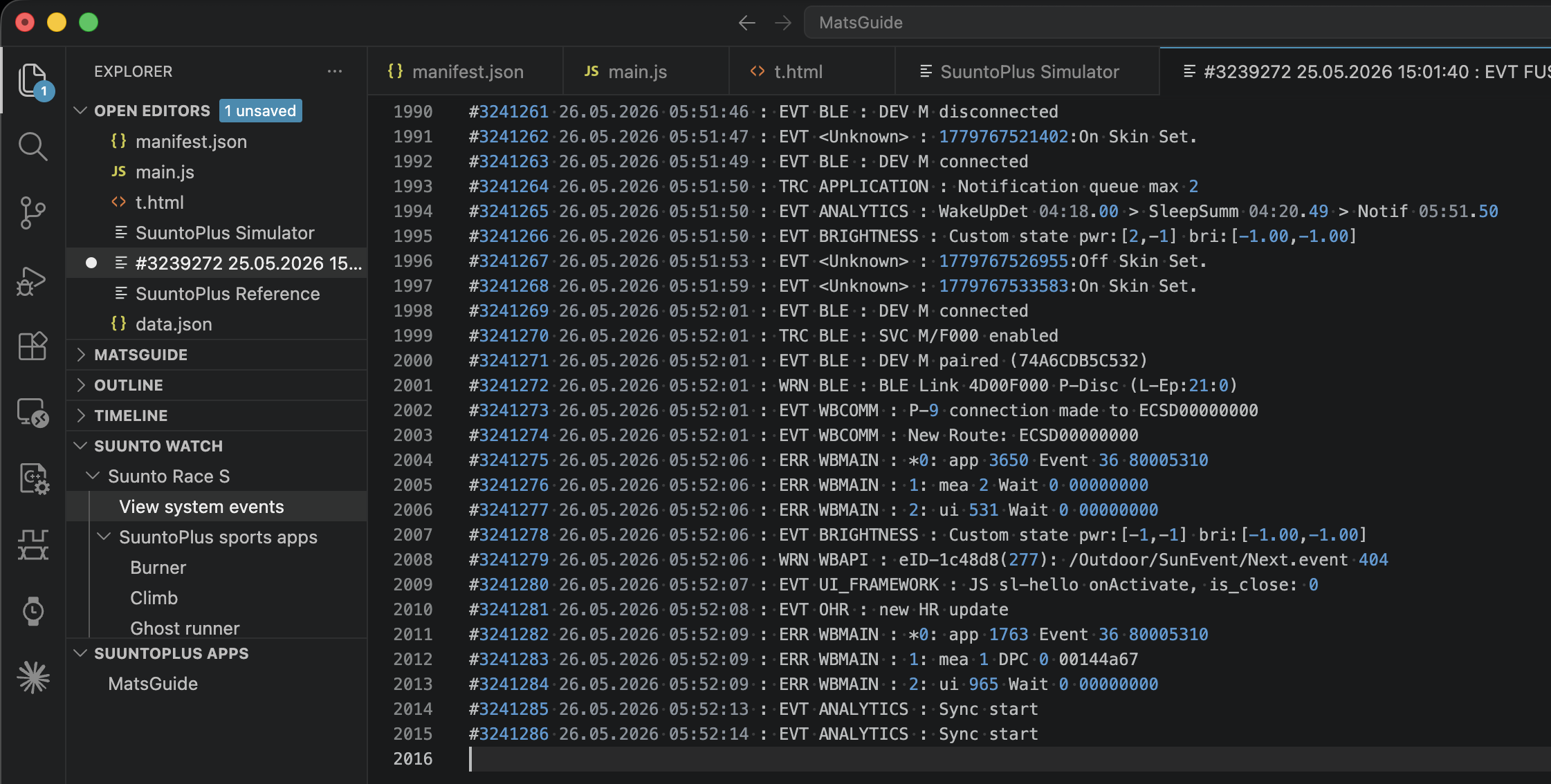

                      • M Offline
                        matram Bronze Member @surfboomerang
                        @surfboomerang
                        Many thanks.
                        For anyone else, select View system events and you get something like this …
                        M 1 Reply Last reply Reply Quote 0

                          Inserting systemEvent() was quite effective in pinpointing the point of failure once I understood how to do it. But I do not really get any error message, just something like this. [MR] messages are inserted by me, so I can see something happened after “G4a”, but not what the actual error was.
                          #3251371 26.05.2026 17:44:39 : EVT UI_FRAMEWORK : JS [MR] G1
                          #3251372 26.05.2026 17:44:39 : EVT UI_FRAMEWORK : JS [MR] G2
                          #3251373 26.05.2026 17:44:39 : EVT UI_FRAMEWORK : JS [MR] G3
                          #3251374 26.05.2026 17:44:39 : EVT UI_FRAMEWORK : JS [MR] G4a1-not-supported
                          #3251375 26.05.2026 17:44:39 : WRN UI_FRAMEWORK : JS
