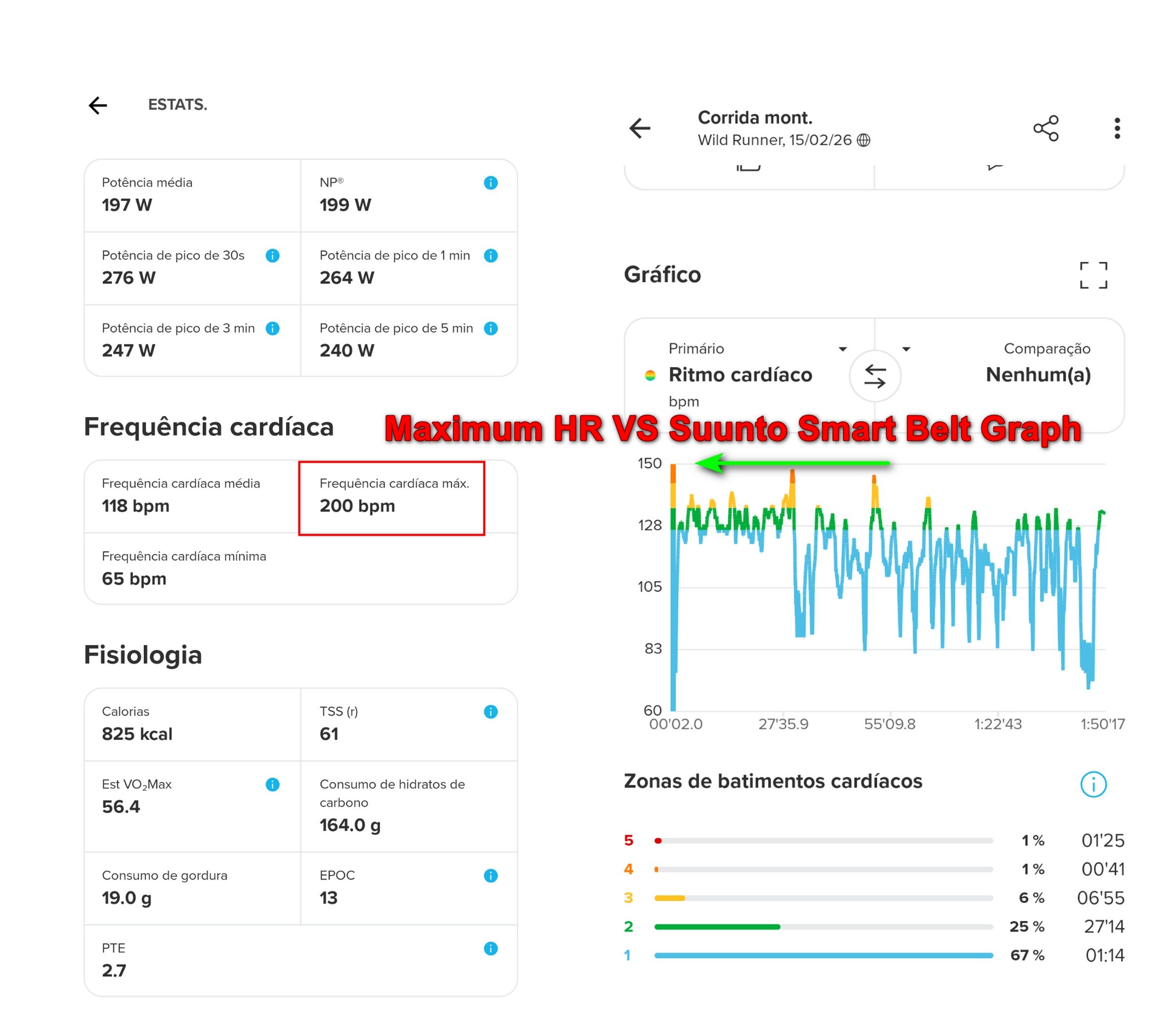

      Data Mismatch: The app shows a maximum HR peak (likely from the OHR) that is not reflected in the graph (which should be using Suunto Belt data).

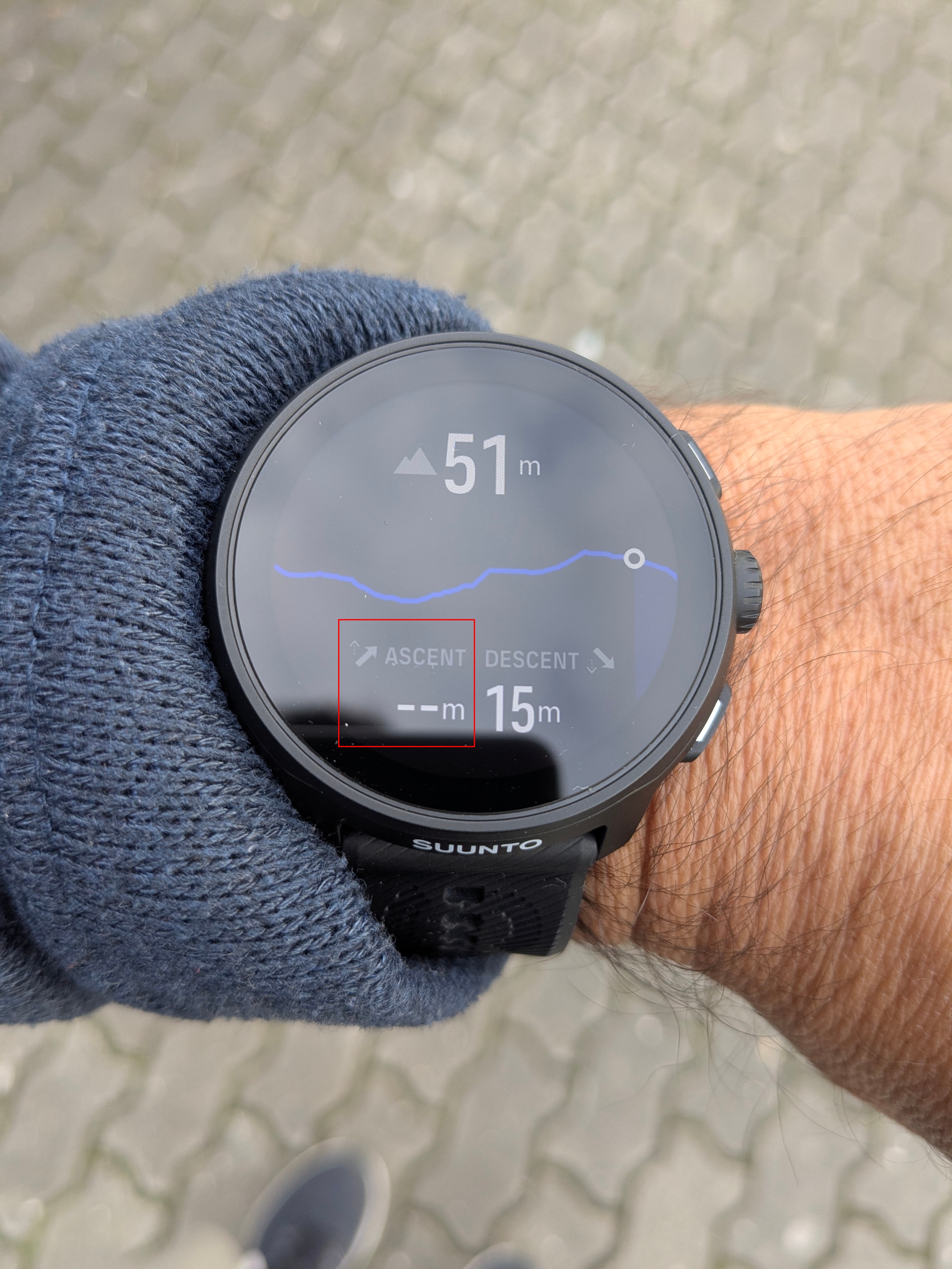

      Remaining Ascent: This field remains blank when following a course planned via the Suunto App, regardless of the sport mode used.
