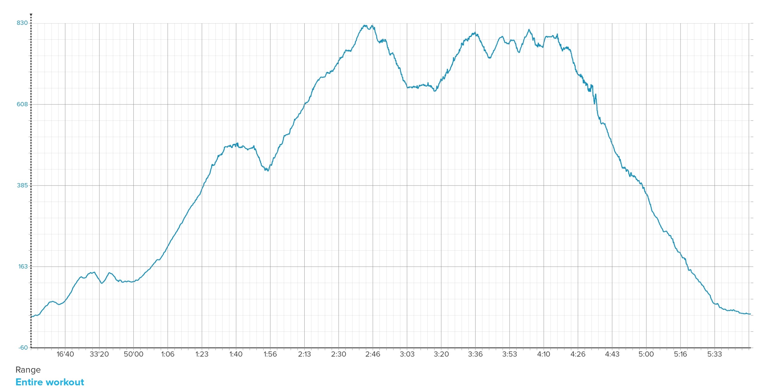

      In very strong winds, the problem still persists, but the error is much smaller. In this case, it was about 250m too high. According to the Suunto Vertical, 1185m – it should be around 900-950m.
      I’m generally satisfied; previously, my ascent totals were often over 1000m higher than the actual total. But there’s still room for improvement.
      It can be clearly visible at the upper part of the mountain, where the wind was definitely the strongest, that the graph is very jagged and hence the inflated results.

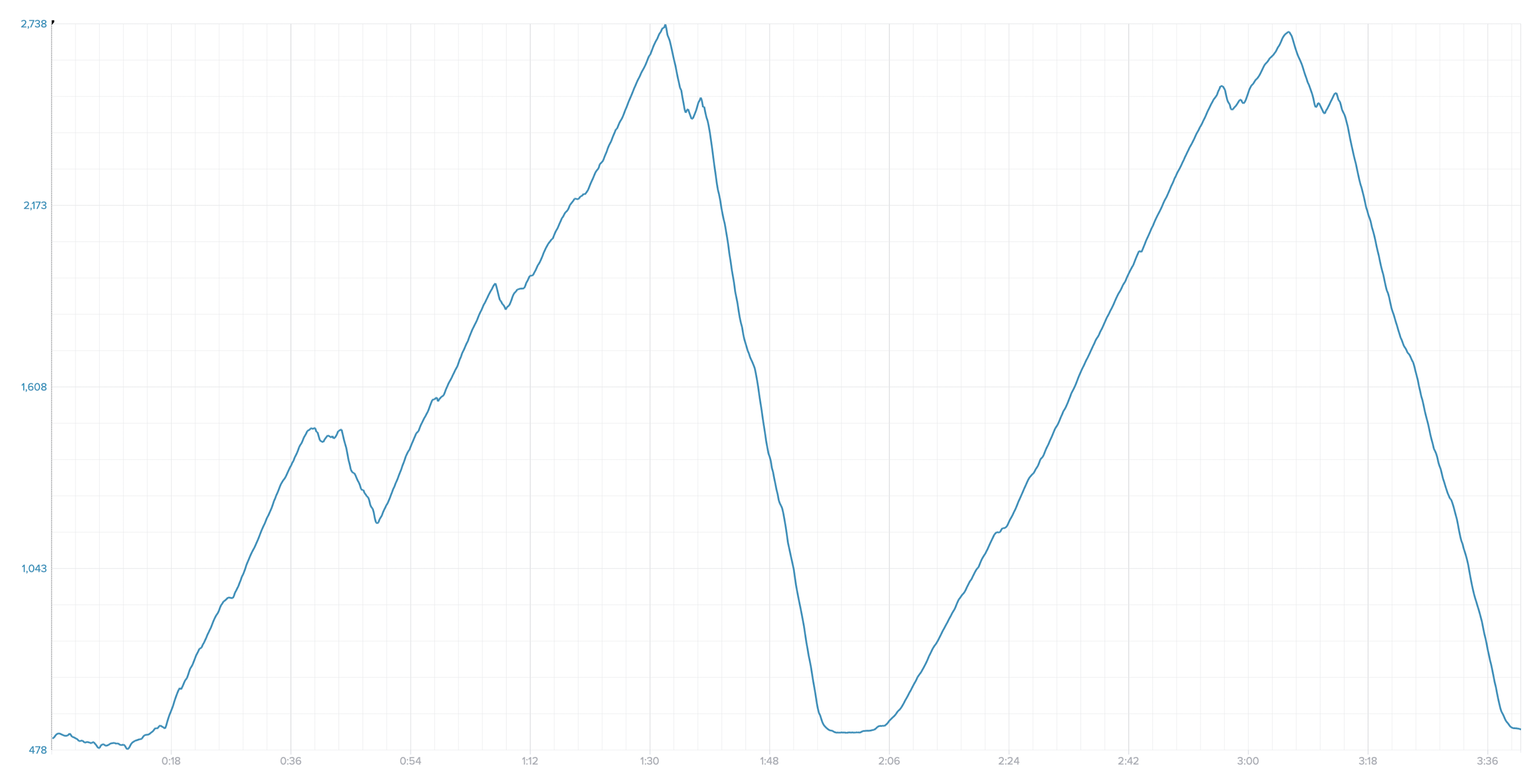

                        @maszop I’ve had a pretty good experience after the last software software update. The ascent/descent is a bit more accurate than before.
                        Here is a graph from today’s trail run. There was a strong wind at the top (above 2500 ft), but there is no jaggedness:
                        This trail run had 5100 ft (1550m) of ascent, which is very close to what I expected. By the way, in my experience the estimated ascent shown in the Suunto App for the route is always at least 10-15% lower than actual, if you compare to that. But I agree that in your case there is a clear jaggedness at the top, which likely adds extra ascent.
