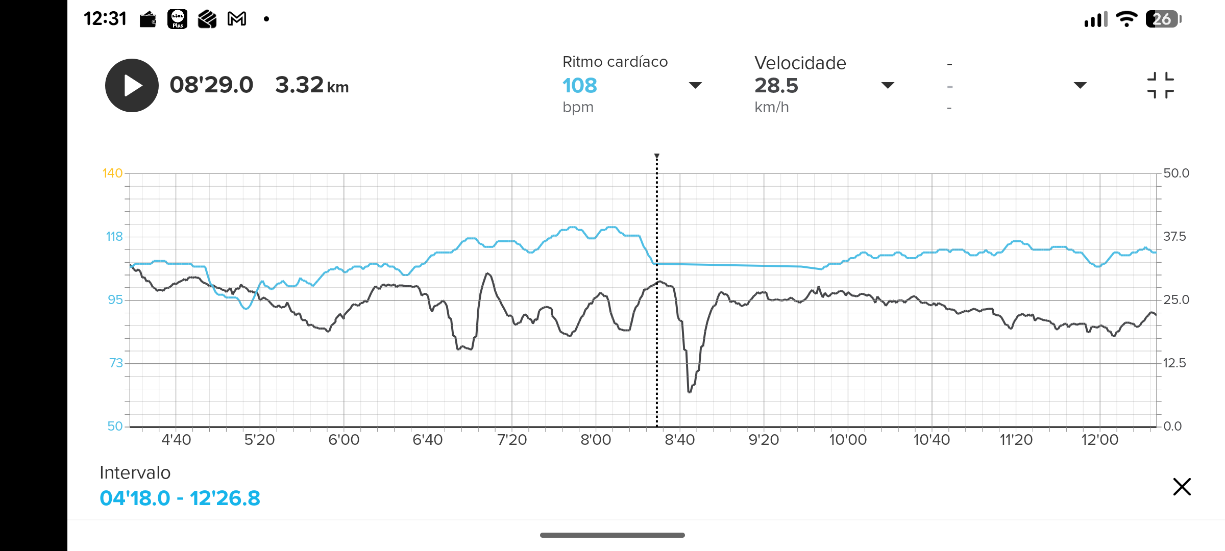

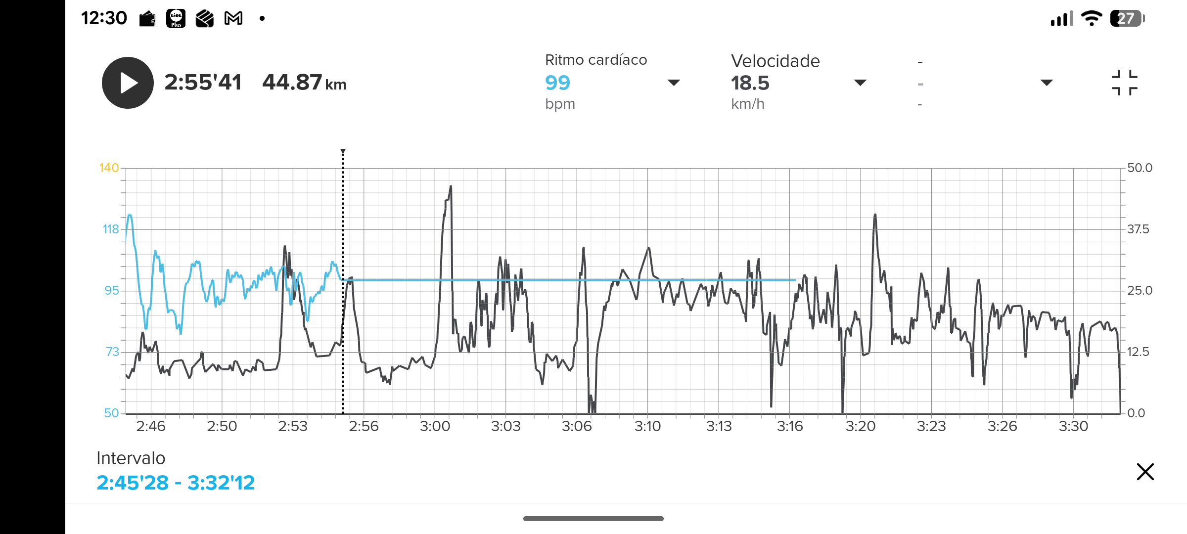

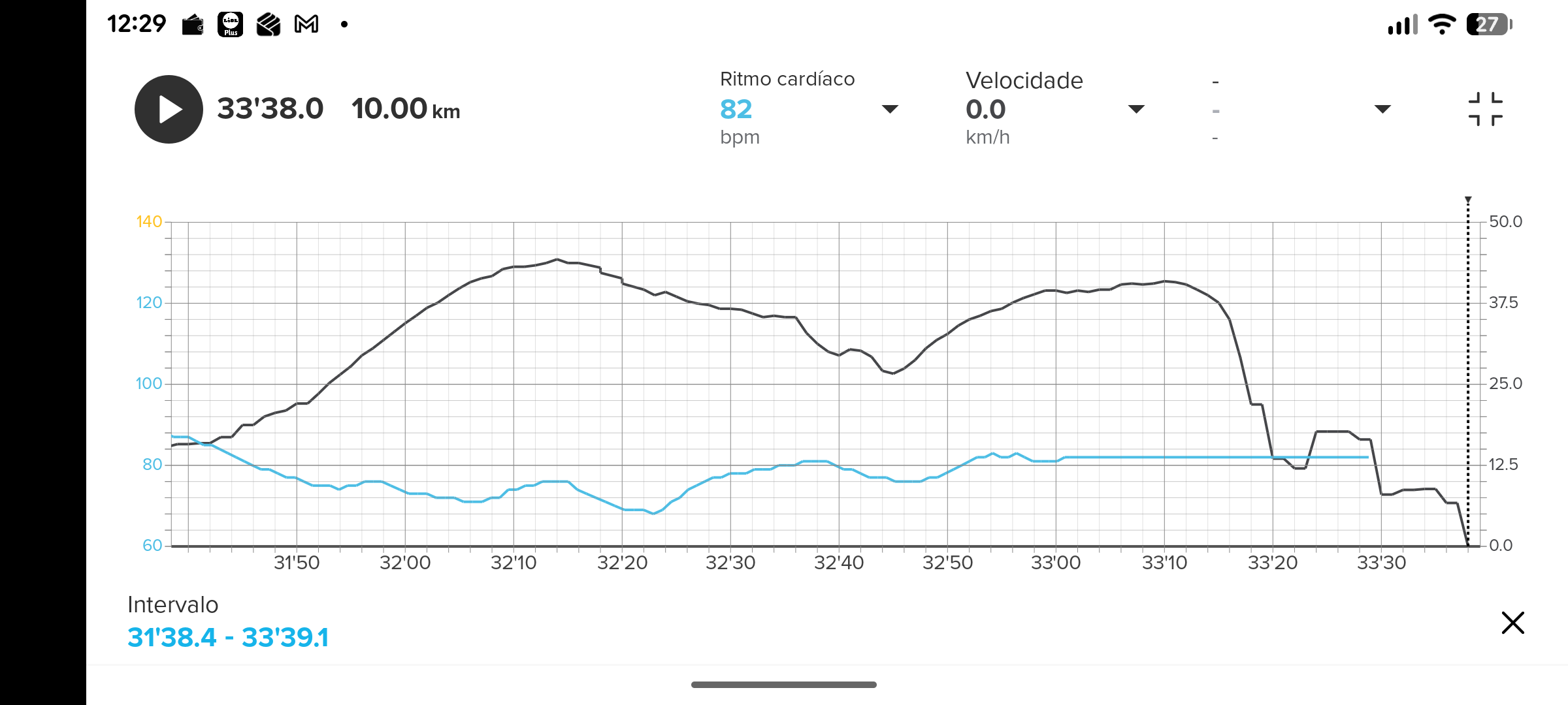

                  Update from my latest training. The Suunto Chest Strap looses connection and doesn’t sync afterwards event tough I wait 3 minutes for the rest HR. It happens mostly at the end of the training but can also happen in the middle.
                  Screenshot_20260302-122944.png Screenshot_20260302-123021.png Screenshot_20260302-123141.png
                  Brad_OlwinB 1 Reply Last reply Reply Quote 0
                  • Brad_OlwinB Offline
                    Brad_Olwin Moderator @Nelson Diogo
                    @Nelson-Diogo I have seen this as well and filed a bug with Suunto. They are aware of the problem. When this happens again send your logs to Suunto and note the problem. You can DM me with the time and date your logs were sent, please note the time zone as well and provide your Suunto app email (username). I can make sure that the information gets to the right developers.

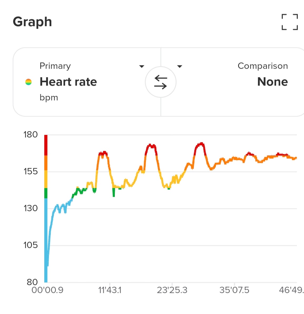

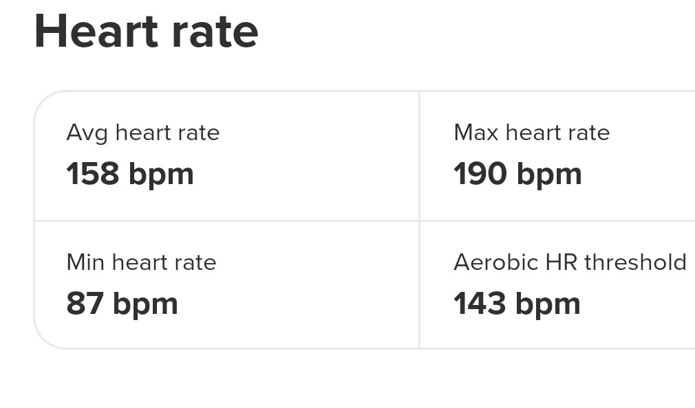

                      Apologies if this isn’t the right topic to be posting this issue but it is certainly pertinent to the use of external HR sensors with the Suunto Run.
                      Putting aside the issues i have had with the Coros armband which i have posted about in that specific topic i have also experienced issues when using a chest strap.
                      The HR graph normally looks absolutely fine as expected but i am usually given a different max heart rate in the run summary.
                      Screenshot_2026-02-22-18-21-23-970_com.stt.android.suunto.jpg Screenshot_2026-02-22-18-21-44-133_com.stt.android.suunto.jpg
                      This example is from a run where i chucked in three sprints and as the graph shows my heart rate doesn’t go above 180 which is inline with what i expect for the effort. With a chest strap the Heart rate summary seems to always be different to the graph.
                      What’s odd is when using a chest strap, which works perfectly with my other watches, i get this max heart rate discrepancy and the synced data in Strava will show a mix of the correct max heart rate which is reflected in the Suunto produced graph or it will show what i’m sure is the incorrect max heart figure as produced in the Suunto app summary.
                      There seems to be something going on here with the relationship between watch and external sensors and how the data is all displayed within the app.
                      Is this something seen before on Suunto or unique to how they process the data? My experience with Suunto only extends to the use of the Suunto Run having used Garmin for years.
