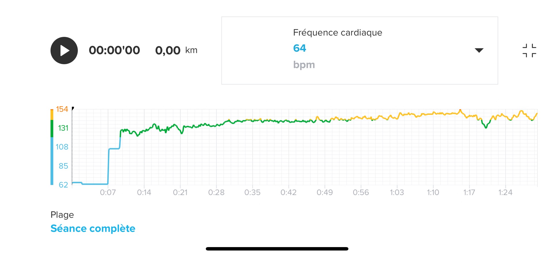

      I have a Coros armband and a Coospo belt. I’m going to test whether I also have HR spikes.
      • ADidierA Offline
        ADidier
        Tested today with Coospo belt – seems fine to me : (just when starting up, but it might be because of the belt)

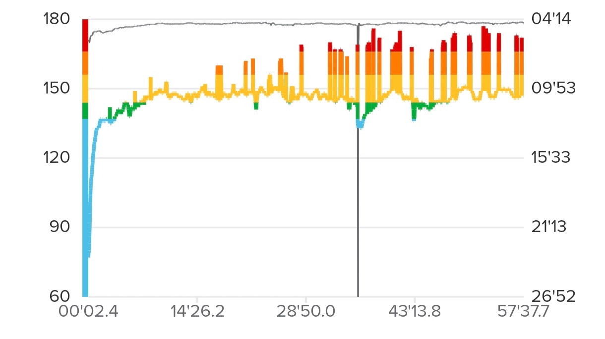

            Also having issues with the Coros Heart Rate Monitor armband with the Suunto Run.
            Abnormally high spikes appear out of nowhere and certainly not in keeping with the effort/pace etc of the run. These spikes frequently jump up 20 beats in a second before falling just as quickly.
            Sometimes almost the entirety of the run in terms of the heart rate graph will look fine apart from the end of the run when these spikes will just appear.
            Given the fact others have reported the same with both the Coros and Polar heart rate armbands there is clearly an issue here.
            Coros Heart Rate Monitor is on the latest most up-to-date firmware as is the Suunto Run.

                  Today I ran with the Suunto Run and Coros HRM together and with my Garmin paired with a Coospo chest strap.
                  The graphs look very similar with some very slight differences as to be expected comparing optical with a chest strap but again the Suunto Run with the Coros HRM produced a spike not present on the other combination.
                  It showed a brief spike elevating my heart rate by around 20 BPM.
                  Tomorrow I’m going to replicate the run but with the heart rate monitors switched to see what is going on. I’ll provide some pictures after to show the issues I’ve had.

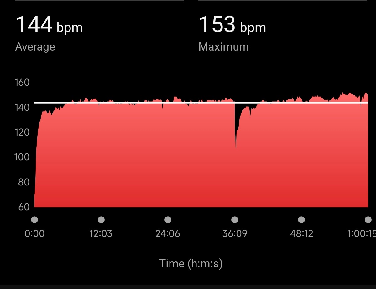

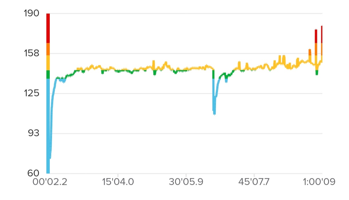

                            Steady run today with the Coros HRM paired with the Suunto Run. Again almost spot on but like every run it seems with this combination i get this rogue spike or spikes. I used a Garmin Forerunner and a Polar H9 on the other wrist with that graph not showing this spike.
                            The Run/Coros combo produced a max HR of 180 compared with the chest strap at 153.
                            Another example of this issue and i have a few more.
                            It is incredibly frustrating and unacceptable given the importance of heart rate data and the fact it is a basic function of running GPS watches going back many years and something which shouldn’t be an issue for modern watches at all.
                            I bought a Coros HRM because it has a reputation for good accuracy and improved comfort. As is i cannot continue to use it with the Suunto Run. Also when using the Run with a chest strap i often get differing max heart rate information that doesn’t match the graph or summary figures in the app. I shouldn’t be needing to wear two GPS watches and two external heart rate monitors during a run to validate the data produced on a new model watch. My Garmin is over 5 years old and more basic but has never had any issues at all like these experienced with the Run.
