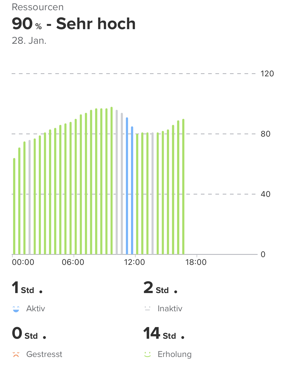

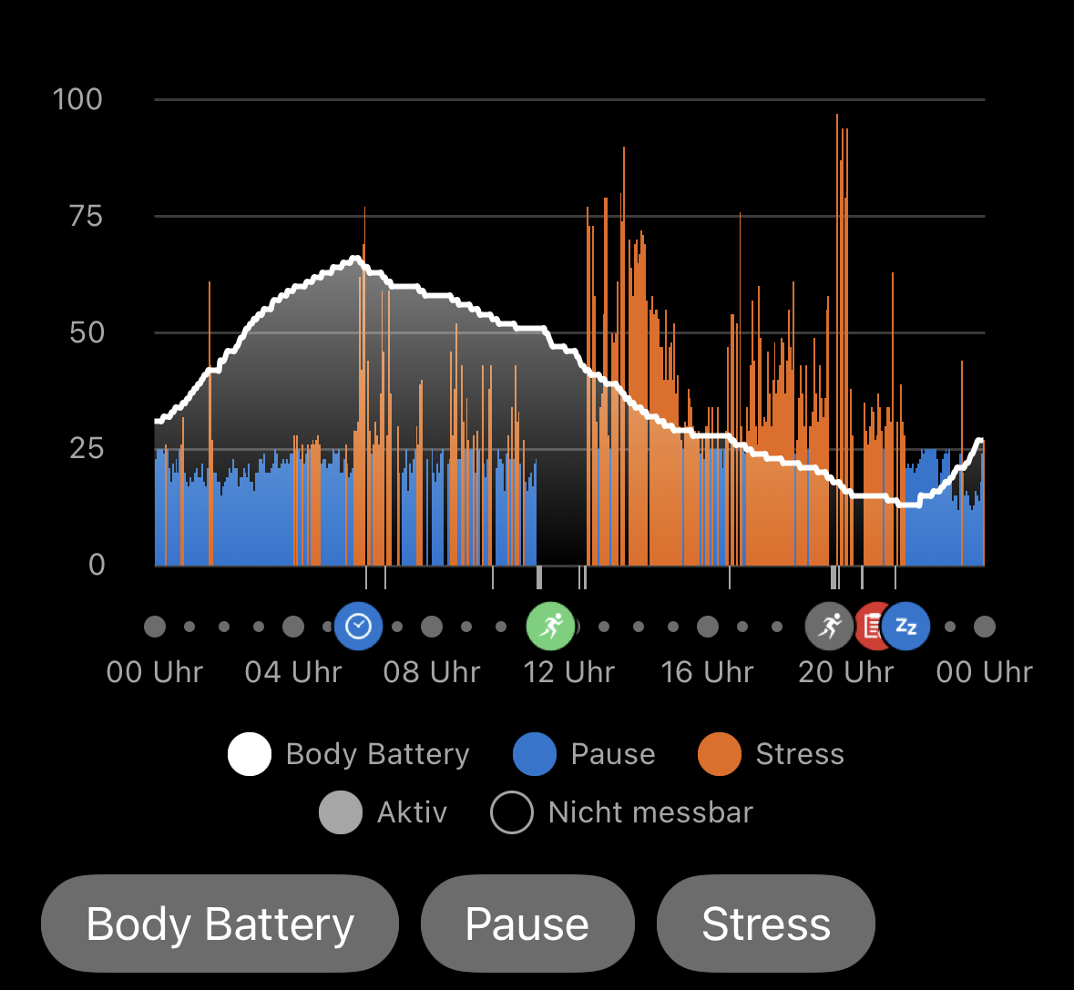

      I don’t know when it stopped to be reflecting the reality, but I remember Resources being almost as good as Garmin’s Body Battery. Possibly with the new OHR algorithm?
      Lately I have recovery almost all the time. The other day I felt a bit ill and have gone to bed early. Garmin did reflect this quite well. And today has been filled with stressful moments and I see this in Garmin:
      93d59461-887c-4f01-82d6-9f2fac660cdb-image.png beaa1173-1dd2-4fa2-9a96-ae084586b00b-image.png
      Same days with my Race S:
      dcf12df1-2465-4a4d-a971-0db8d24bf910-image.png 48efa587-7e84-4909-821e-d2a585fae70c-image.png
      I mean at the moment Garmin thinks that my Body Battery is down to 16, what I think is a bit low for how I feel. Suunto on the other hand says 97. I think a 40 is realistic…

        @2b2bff i have the same high resources. Always up to 99 and never goes below 80. There is something really off with how the recourses are calculated.

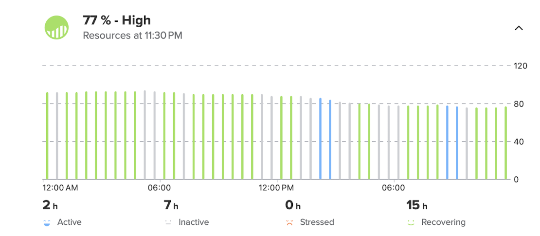

          @2b2bff Here are my resources while my body fought Covid (a few weeks ago) and I had fever:
          I wonder why I didn’t go for a run?
          By the way, why does the graph vertical scale goes to 120?

              @sky-runner said in Resources used to be better:
              Because it looks better that way. If it would only go to 100, it would look rather compressed. But it is not helpful that the graph doesn’t scale the same all the time, but sometimes up to 90 or so, if your resources are low enough…

                        @2b2bff said in Resources used to be better:
                        No, it is actually more compressed when the scale goes to 120. If the scale went to 100, it would be more stretched out vertically. As a thought experiment, imagine the scale going to 1000 while keeping the vertical size of the graph the same - would that make the graph less compressed as you say?
                        And if the concern is having some space on the top of the graph, that can be achieved by having some margins above the graph rather than by having a wasted space inside the graph.

                            @sky-runner I’m sorry, I didn’t mean the graph would look compressed, rather the complete UI would, as it would reduce the whitespace below the headline. If you look at the Android representation, you have a 100 line, but whitespace over the line. TBH I think it looks better with the 120 line and the whitespace. My problem is that the range is shifting around on iOS…
