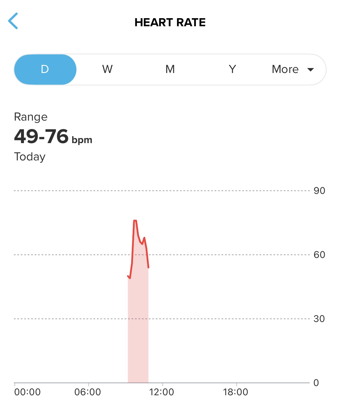

      Since the latest update and the hotfix, I experienced the HR unexpected off three time… all the time I activated a soft reset and the sensor started to work again quickly.
      Luckily I noticed the fact as I started the training record and the HR was not synced…
      I hope a new hotfix could delete this annoying problem…crossed fingers here!

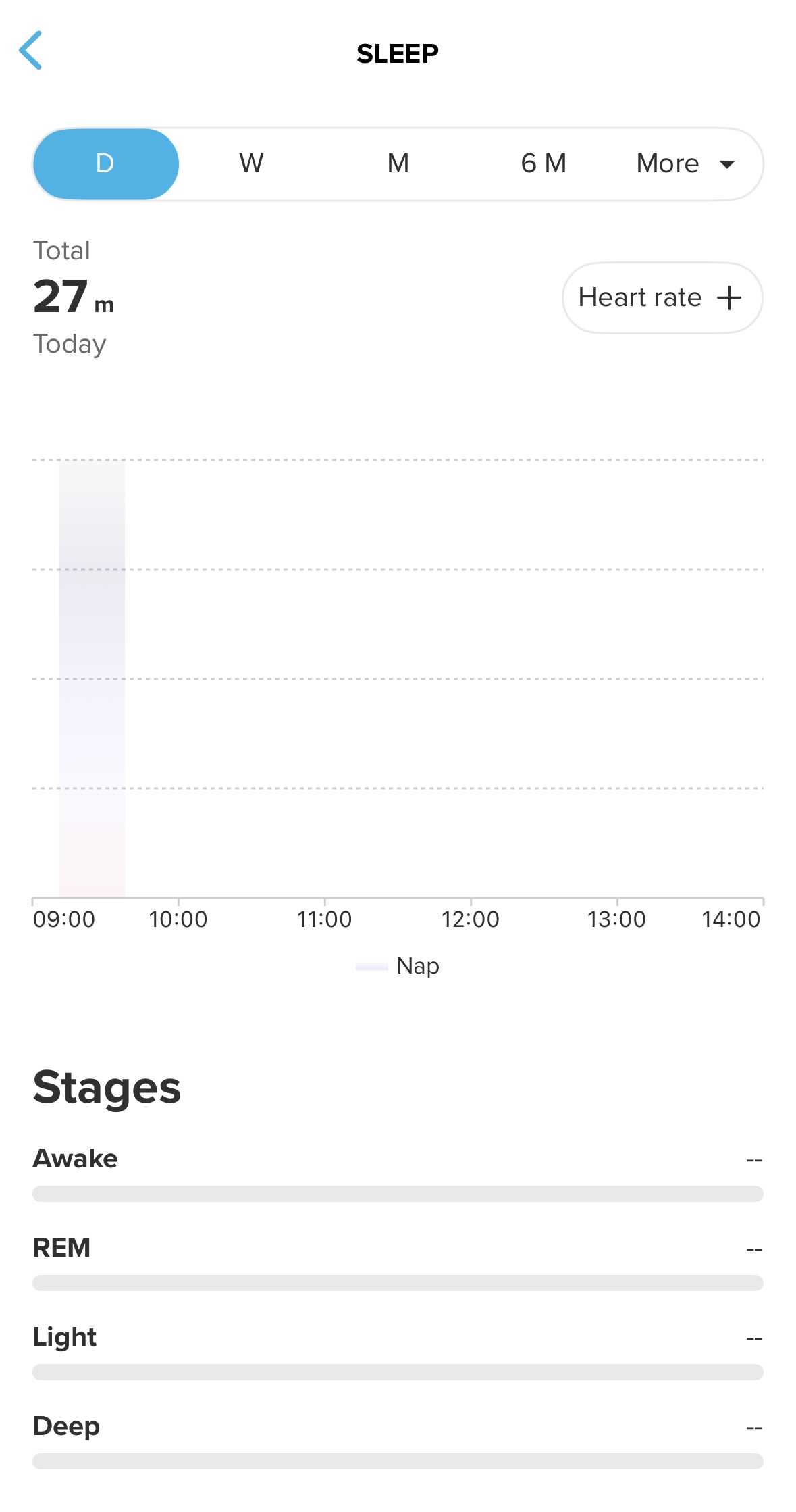

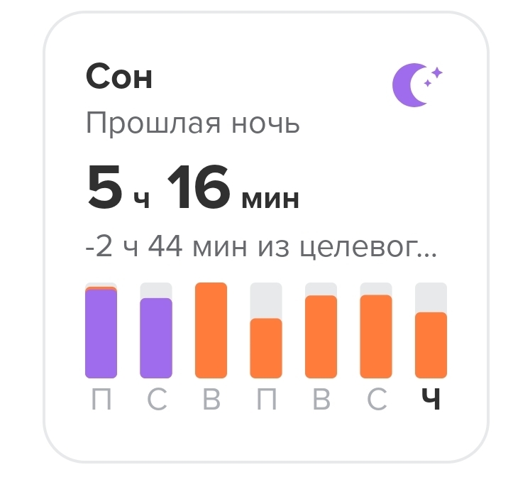

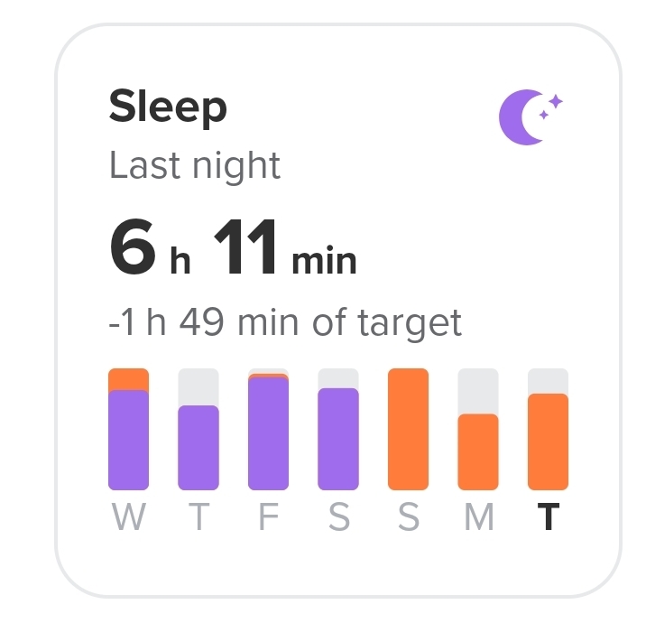

                      Race S, no issues until the latest hotfix. Now issues with sleep detection. There is also no data on the watch. Should I open a separate thread?
                      2 1 Reply Last reply Reply Quote 0

                        @OutdoorMan no need to open a new thread. It is already known to Suunto, it seems… https://forum.suunto.com/post/185192

                          @2b2bff I see, thanks. Let’s wait then…

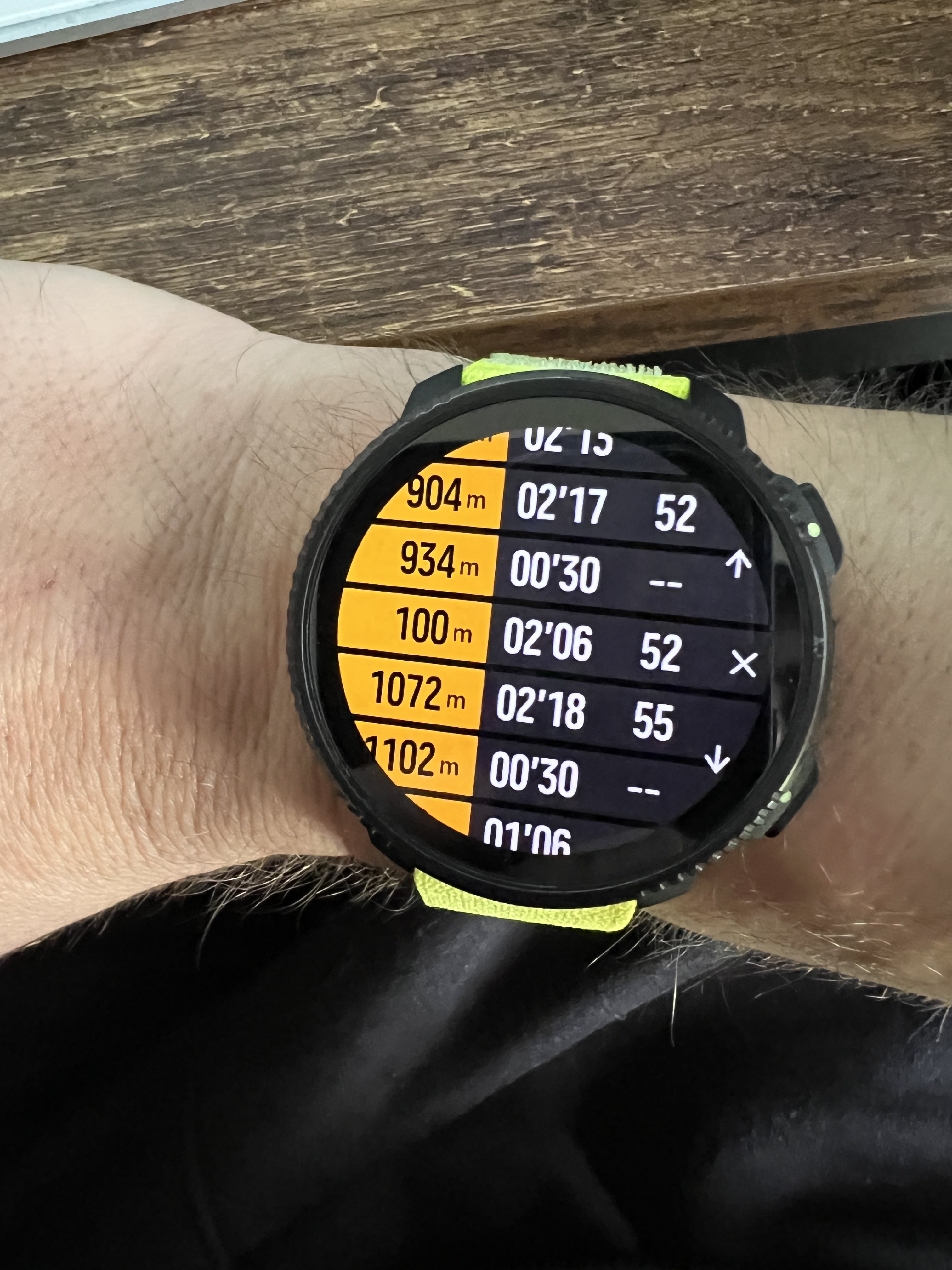

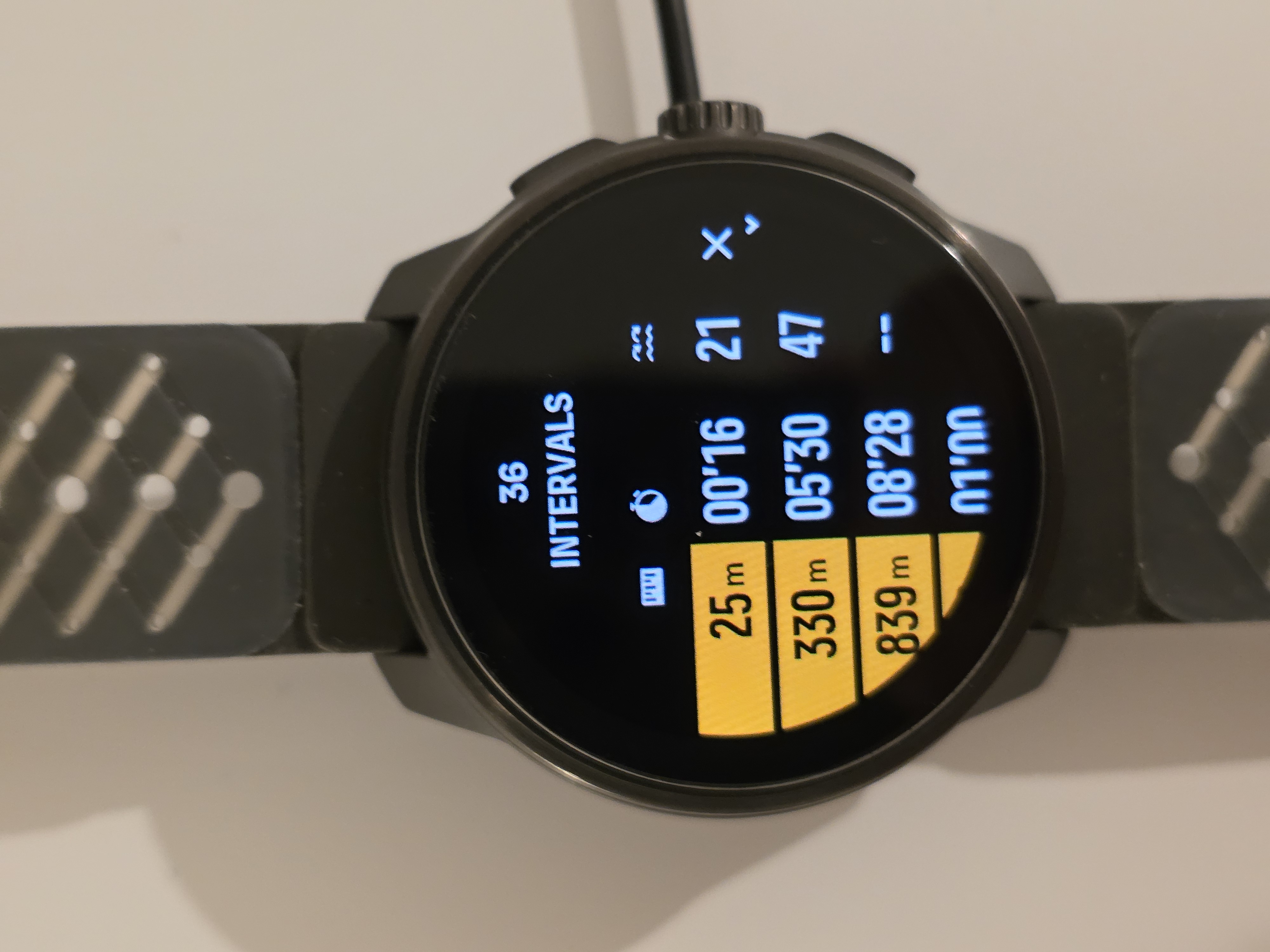

                                        Interesting bugs today, probably easy repeatable if someone wants to check.
                                        Imported a Suunto guide from intervals.icu and set up a run with a route. Firstly, I previously had media on, and it wasn’t possible to turn off from the menu when running (long press bottom right).
                                        Secondly, every time a new section started of the training, the watch would tell me it was off route, before confirming I was back on route about 10s later. Which if you combine with the vibration from getting into the correct zone, vibration to start the interval and so on, is a lot of buzzing on the wrist, especially if you have a short (100m or so) interval.
                                        I’ll try and replicate it whenever I do a quality session next, probably earliest the weekend or next week I guess.
                                        Suunto Spartan Trainer Wrist HR / 9PP Refurb

                                            Just to add, had the same issue yesterday with the route dropping temporarily when in conjunction with a guided so every new interval caused a “route lost”/“back on route” combo.
                                            Also, the watch hung on a zonesense screen, with nothing happening when buttons were pressed. Happily before I soft reset I tried the long press bottom button to escape to a menu, and then exited out, all was fine. Avoided the zonesense screen the rest of the run, but if someone else has that they may resort to soft resetting.
                                            Appreciate it’s a bit late in the cycle of watch updates to report, but any idea if these have been fixed in new SW update or are unreported? @egika @dimitrios-kanellopoulos
