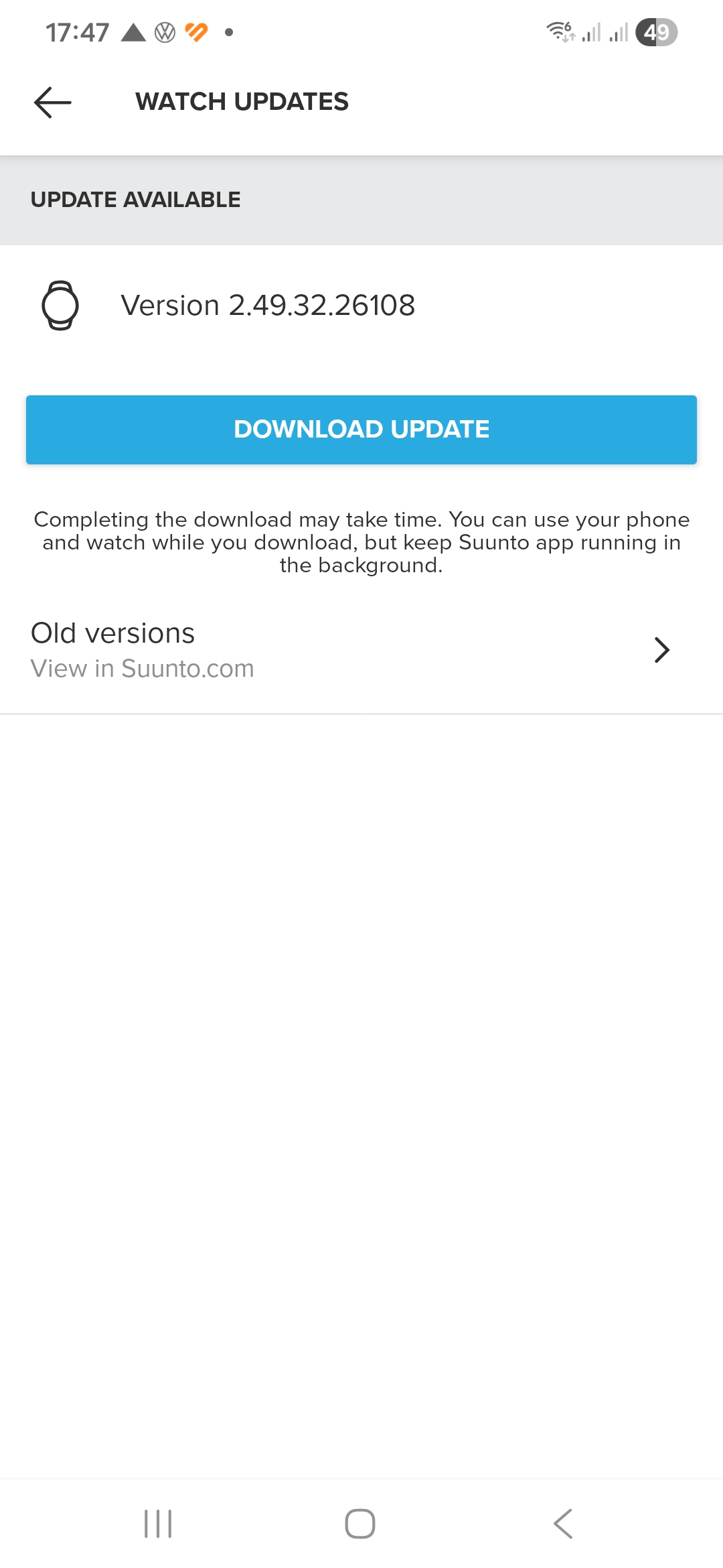

New Firmware is available… 2.49.32.26108 (Valentines day update…

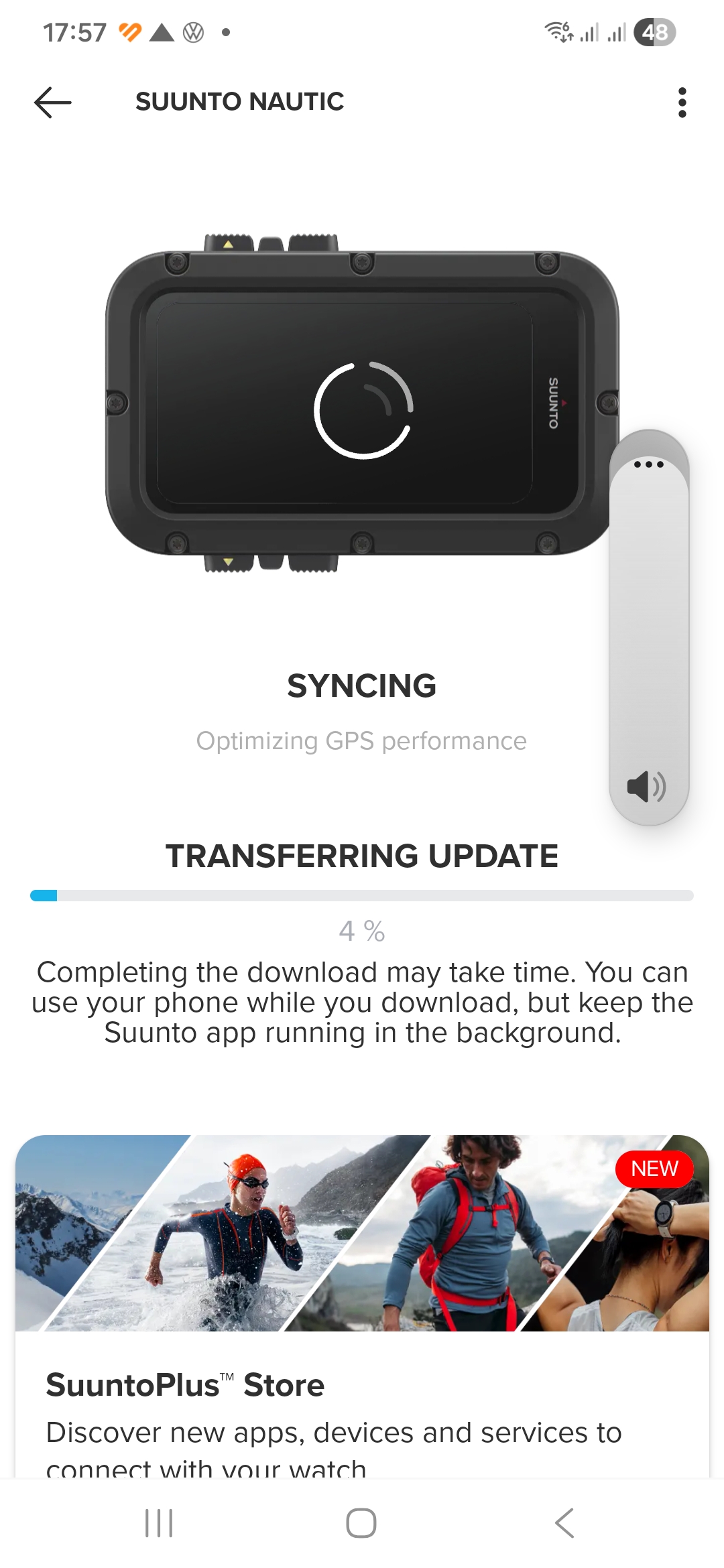

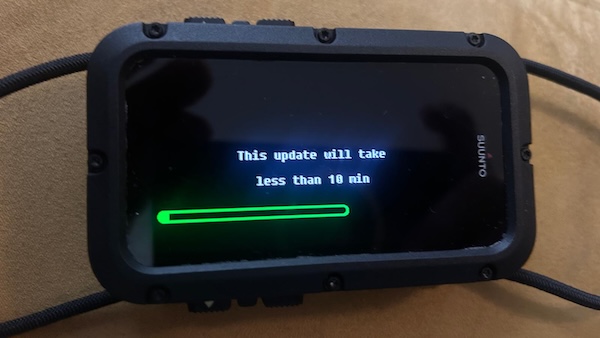

In case of problems while updating Nautic:
-Make sure the Nautic is connected to charger
-Make SURE the power save function on the phone is OFF since it interferes with the app in a serious way in my case. Probably has to do with the power save function settings of the Suunto app.If it still fails, try turning off and back on the WIFI and BT on the phone. After reconnecting the process should resume. In my case i see the percentage increasing at least every minute. (Samsung s21 ultra)
