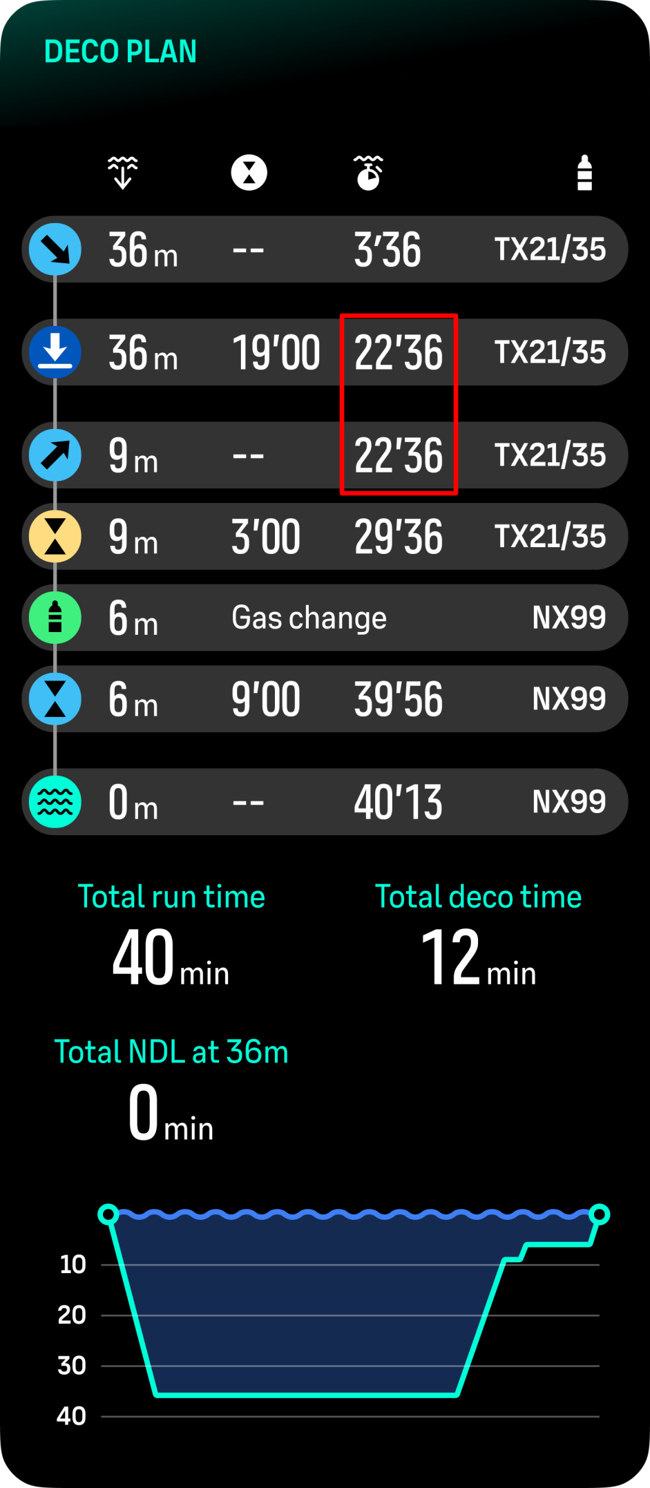

          Regarding the breakdown schema, in the case of a decompression dive, the cumulative time for ascent segment does not seem to take into account the 10 meters per minute ascent rate, as mentioned in the footer of the screen.
          Currently, the cumulative time displayed at the first ascent stop is identical to the bottom time, which is counter-intuitive.
          For example, in the Nautic manual, a sample dive of 19 minutes at 36 meters is presented. The ascent from 36 m to 9 m should not display a cumulative time of 22’36. Since a 27-meter ascent at 10 m/min takes 2’42, the displayed cumulative time should be 25’18 instead.
          Therefore, the next stop should display a 28’18 cumulative time rather than 29’36, and so on.
          Don’t you think?

            Haha, good catch @el.Fakir !
            Maybe the next firmware with provide teleportation feature. Beam me up to the surface!
