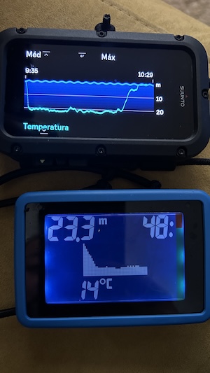

              First dive with Suunto Nautic Vs Scubapro luna 2.0 AI
              Suunto Nautic
              Bühlmann ZHL 16C GF
              Gradient factor 40/85
              Dive time - 48 minutes
              Max depth - 23.1
              Water Temp - 13min 15max
              CNS 10%
              OTU 29%
              Luna 2.0AI
              Bühlmann ZHL 16C GF
              Dive time 48minutes
              Max depth - 23.28m
              Water Temp - 14min 14.4Max
              CNS 13%
              OTU 43%
              it was nice to compare this 2 dive computers, the Luna gave me 2 more minutes of NDL using the same Gradient factor.
              The suunto should review their way to manually change gas with less steps, and built a dedicated diving app for the Nautic and Nautical S.
              The Nautic Maps are in their beta, and need a big upgrade to compete with Garmin
              Tides are not available (nautic or app)
              PDI not working (Nautic)
              Turn by Turn Navigate to POI not working (Nautic) or if just using the compass is very limited
              My biggest critic at the moment in the Suunto Nautic, is not having dedicated app for diving and not able to share with SSI app

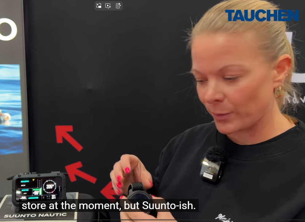

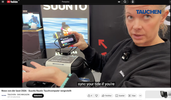

                This video from ‪bootduesseldorf‬ at 6m27s the Suunto Nautic already has the Tide Option
                youtube suunto boot duesselforf
                N EgikaE 2 Replies Last reply Reply Quote 1

                    @Nandodiver had to lough hard when the “soonish” was transcripted into “Suunto-ish” 😂 😂 😂
