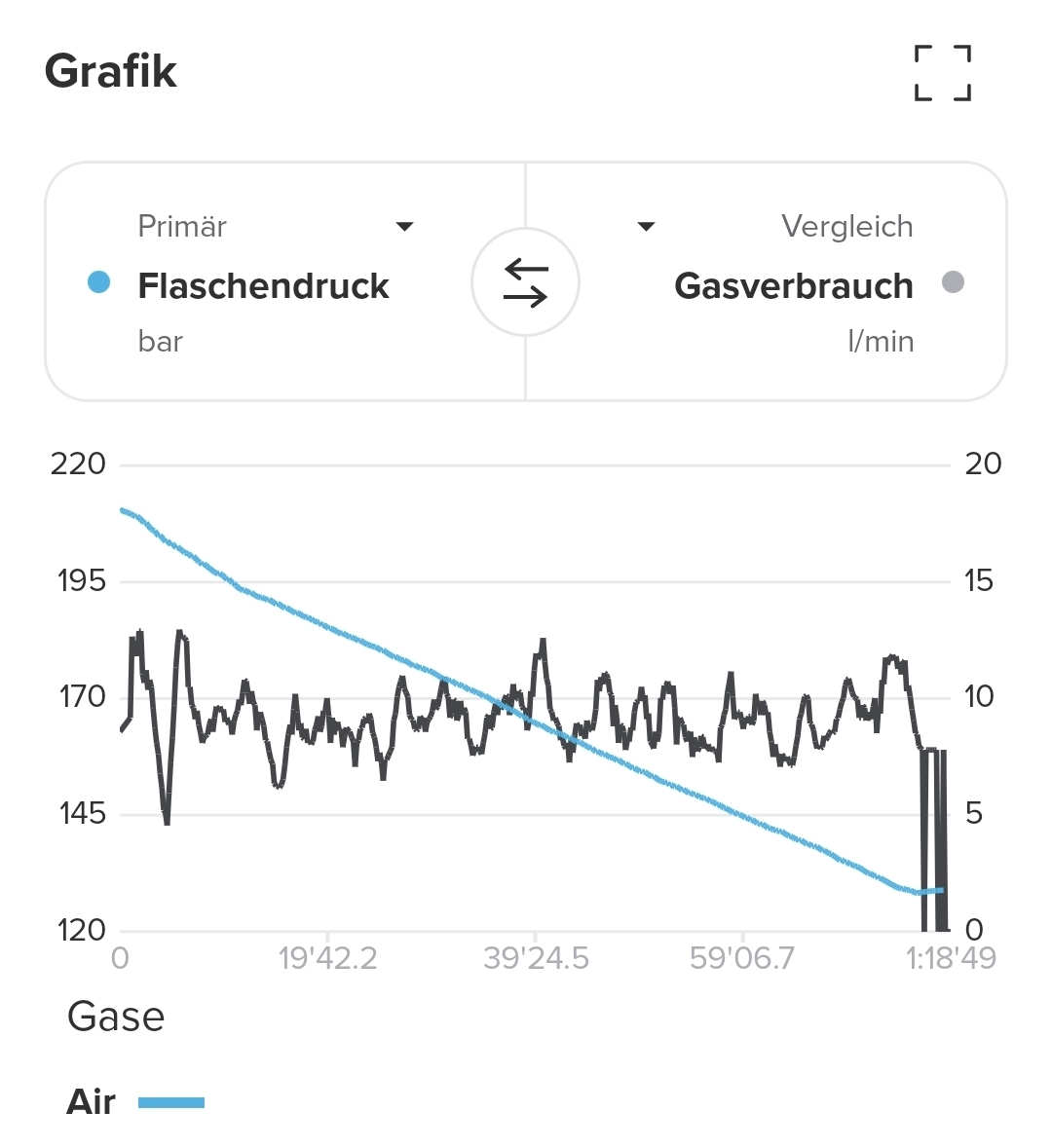

                @Tsarit
                Exciting 🙂
                What do you see when you display the bottle pressure and gas consumption?
                Do you also get a diagram like that?
                Please excuse me, mine is in German 😉
                Blue = pressure
                Grey/black = gas consumption
