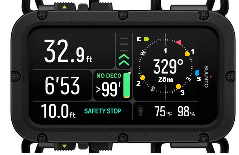

      Of cause there are golden solution with maps, contours etc…
      BUT… under most diving a simple extended Suunto Compass (like a planetary location wheel) we be more than enough.
      Offend we just roughly need to know:
      1. GPS Location of the actual Starting Point (S - blue).
      2. 1-3 POIs from a pre-dive defined location table (1-3 Orange)
      3. End Point POI or same as Starting Point (E - green)
      4. A POI selector indicator
      5. An estimated distance from the current position to the POI
      The sensor fusion of this nice device should make this possible.
      Even without a gps-update from the satellites.
      AND everything can then be inside the current area of the compass….
      … and navigation can be done with all other important info on the screen simultaneously.

        @Niels-Søren-Bøgh Good idea

          Yup, that’s a great suggestion!
          To be colorblind proof and limit visual noise on the compass, probably better to place the 1, 2, 3 waypoint numbers within the yellow dots, and use a start/end icon instead of a S/E letter close to the blue and green dots (and reserve them for South and East).
          A bit like what is proposed with the dive planner icons (see user guide §10.2 p. 60, for instance the surface icon to represent the end).
