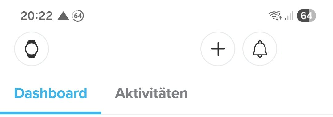

      My Vertical synced flawlessly for a couple of months, since a couple of days or a bit loner, however, the Suunto App only shows an “empty watch” symbol in the upper left corner:
      and a completely empty screen after I tap it. The watch still receives notifications (so the issue might be the same as this, all I can add is that in my case, the problem is gone right after I reboot the phone and comes back “sometime later”. Turning bluetooth off and on again doesn’t help either.
      Android 16 “Samsung latest” on a Galaxy A54
      Suunto App 6.5.7 (6005007)
      Vertical Firmware 2.48.16
      Maybe this behavior already started to happen after that firmware update. Is it possible to downgrade to cross-check?

        Meanwhile, I downgraded to firmware 2.44.52 (see here for how that works) but also had to reboot android for the problem to “go away”. We’ll see if it remains “fixed” in which case firmware 2.48.16 would be the reason.

            Same problem with Race 2. You don’t need to reboot the phone, just “force stop” the SA.

              @Armin-M Same here, also with Race S, so it seems Suunto App bug related and not watch software related.
              Reboot phone is not necessary, you can “simply” stop and reopen Suunto App.

                @jjpaz I am not 100 % sure if it SA or the watch f/w. Some people reported that they downgraded their watches to a previous f/w and the problem went away. Regardless, it is something that Suunto should fix.

                    I have had the blank watch sync issues with V2 so guessing it is SA related. I heard someone say you can restart SA and this will solve the issue without restarting the phone.
                    I only had this happen once and restarted the phone.

                      @Audaxjoe correct; you can “force stop” the app (SA) and it helps.
                      Btw. I had this problem for a while, but it disappeared around two weeks ago. Maybe, the new version of SA solved it

                          Restart the App should be enough, they said
