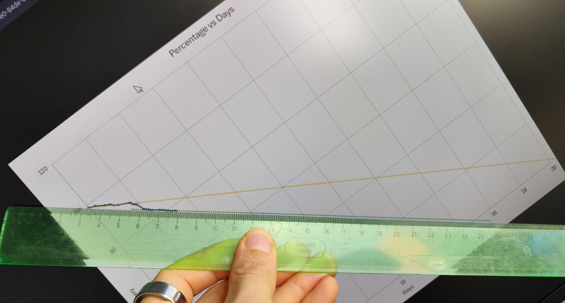

        @Horizontal_2
        Yes, I understand what you’re saying. The thing is, when I put a ruler on it, I can see that the green trend line starts at the same point as the yellow one. From this, I conclude that activity was also included in the battery balance calculation.
        It is quite questionable how to calculate the energy balance in batteries. The problem is that it depends on consumption. Higher performance requirements reduce the possibility of effectively utilizing the amount of energy in the battery.
        If you calculate the battery capacity at low consumption, you will get a higher capacity than at higher consumption. That is, if the consumption is X and the battery runtime is Y, then if the consumption is 2*X, the runtime will be less than Y/2.
        This is a problem of the battery’s internal resistance. The higher the current, the greater the internal energy consumption of the battery.
        It seems to me that Suunto tries to take into account how the user uses the battery when calculating the battery status so that the estimates are not too optimistic.
        I am curious to see the continuation of your measurements 🙂
        Translated with DeepL.com (free version)

          • Horizontal_2H Offline
            Horizontal_2 Bronze Member @segi_pn
            @segi_pn Thanks for the picture. It made me smile. I appreciate your time.
            I think it’s a coincidence. During the green line I had the watch with many functions off, so the consumption should be low. Also, one run shouldn’t eat 5 days away.
            The previous cycle I made a graph as well, and the same occured on different percentages (and only after a run). The difference then was that the drain was bigger and a soft reset helped.
            It’s still following the green line. I’ll do a short run in a bit. Maybe that’s what the watch (or I) need! 🙂
            We’ll see in a few days! I’ll keep sending Suunto batterylogs every cycle till the problem is solved 🙂
            segi_pnS 1 Reply Last reply Reply Quote 1

                            • segi_pnS Offline
                              segi_pn Bronze Member @Horizontal_2
                              @Horizontal_2 I’m interested in seeing some of your new graphs.
                              How did you make the graph? Which software do you use? Maybe I’ll try taking my own measurements with my Suunto Vertical.
                              Suunto Core (17y)
                              Suunto Vertical Ti
                              Horizontal_2H 1 Reply Last reply Reply Quote 0
                                @segi_pn I’ll update in a day or two. I’m trying to turn on the Flight mode for the night, maybe longer. Just to see if the drain comes from connectivity. The graph of previous cycle was more exciting because sometimes it did get the 5% per day easily 🙂
                                It’s just Excel. Everytime I see the battery drop 1% I note the time in my phone. One or two times per day I update the sheet and voilla. Sometimes I skip a percentage 🙂
                                SquirrelS 1 Reply Last reply Reply Quote 0
