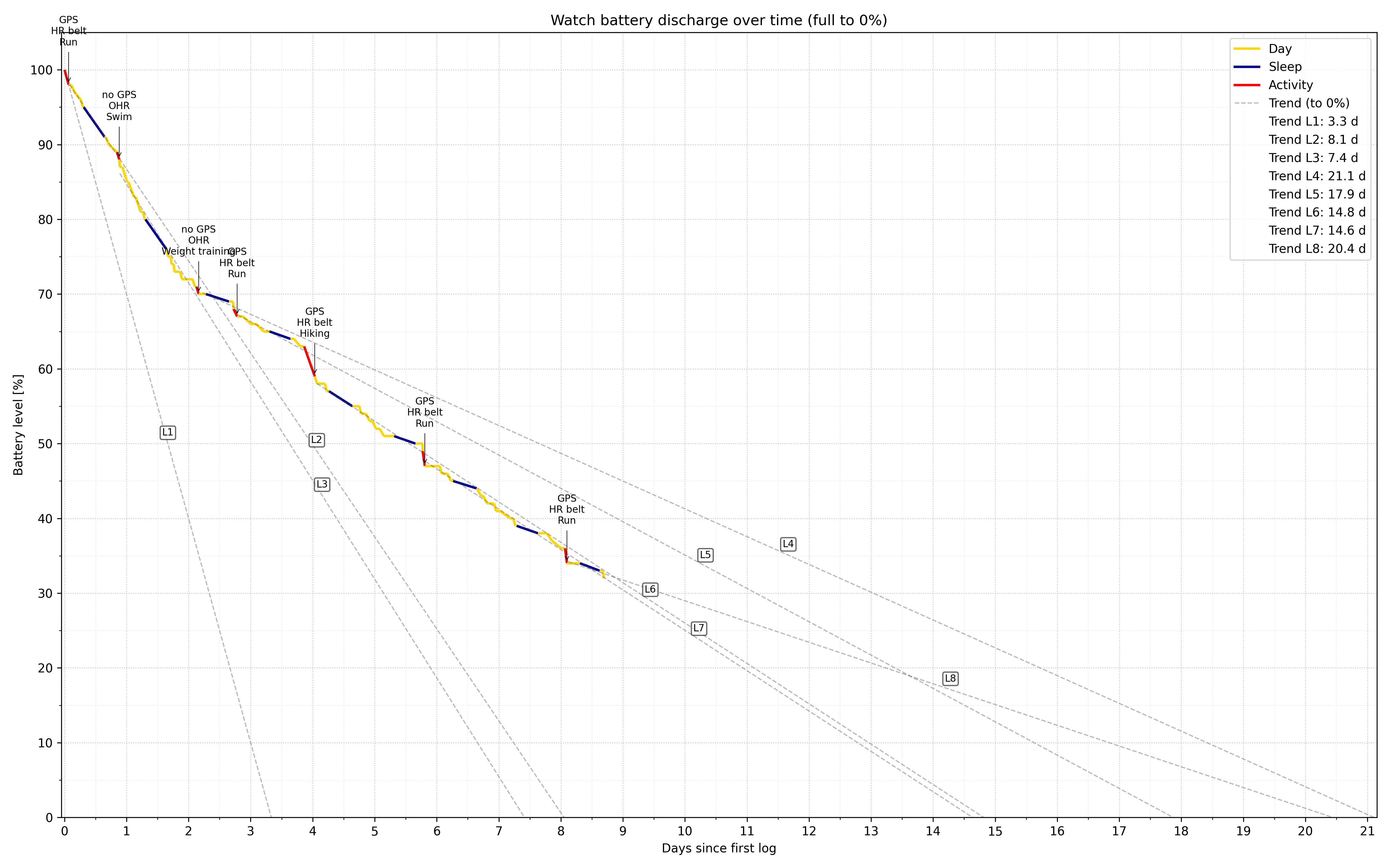

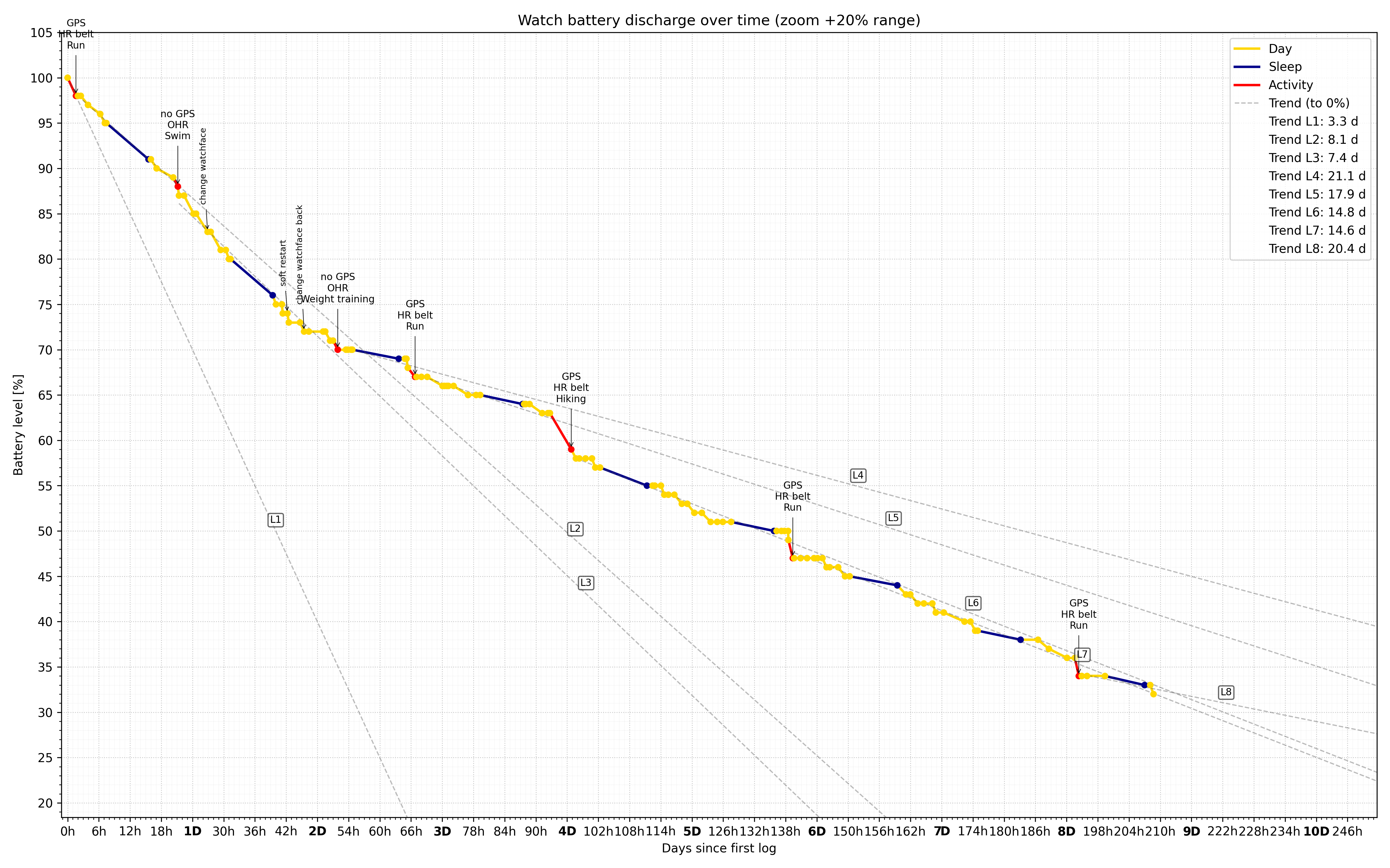

                        • segi_pnS Online
                          segi_pn Bronze Member @segi_pn
                          Hi,
                          I continued monitoring the battery discharge and found an interesting twist.
                          If you look at my previous post, there was a turning point in the discharge rate -> faster discharge.
                          said in Software Update 2.48.16 (2025 November Rain release):
                          The trend lines show consumption trends separated by activity (in the first case, charging and activity). It is clear that after the first activity, the steepness of the trend lines is significantly steeper.
                          Now I had the exact opposite effect: fast -> slow.
                          I have marked some of the things I did. After a soft reset, it changed. However, I also replaced the chest strap and removed the old paired strap (some activities worked with the new one without any problems, but one only started working after removing the old strap).
                          I had done soft resets before, so I think that removing the paired BT, or perhaps a combination of removing the BT and doing a soft reset, was what improved the battery drain.
                          I am attaching the graphs:
                          PS: I corrected the incorrect values in the legend for the trend lines.
