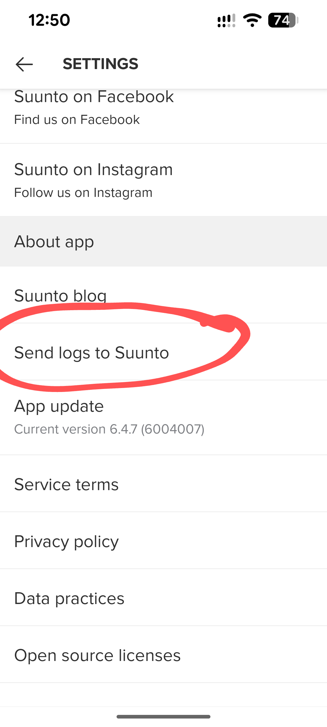

                                      • G Offline
                                        Gideon Kaempfer @Ecki D.
                                        @Ecki-D. Sending logs still exists under account (right top picture of a person) -> settings:
