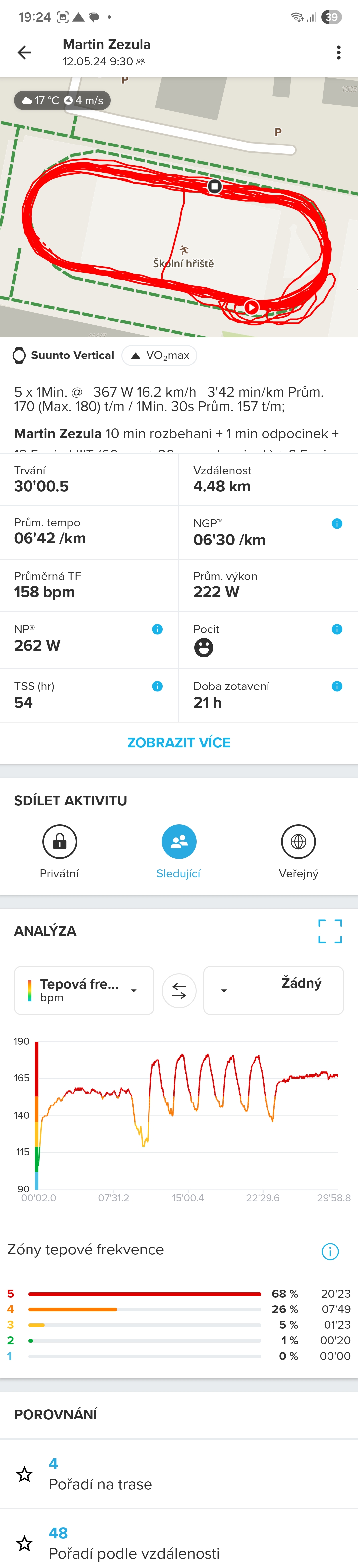

      There seems to be a problem with a calculation (estimation) of the statistics that many sportsmen are closely monitoring - VO2max. According to Cooper test (SuuntoPlus app) estimation, based on a distance achieved during a 12 min run at a maximum effort, my value is at about 44 (derived from 2460 m distance achieved, corresponding to values/distances mentioned by many various sources). However, the general VO2max estimator within the watch (in my case Suunto Vertical Titanium Solar) shows me much higher values and even within the same activity / run when Cooper test was done, it showed 46.1… Furthermore, it shows even bigger values of VO2 estimates based even on activities like walking(!), in my case often above 47 or even close to 48. I know - all of these are just estimates - but there is quite a huge difference in physical condition of an athlet with a VO2max of 44 and 47. I am really unable to overtake me running with a maximum effort by 180 metres during a 12 min run (i.e. achieving 2630 m instead of 2460 m recorded by me) or to improve my pace from 4 m 53 sec (per 1 km) to 4 m 34 sec, corresponding to VO2max of 47.5… Moreover, given the scale used in a graph on a left part of the screenshot, you can see almost nothing there… Suunto_VO2max.jpg

          @Tieutieu Thanks for the information. Yes, I always use the HR belt and how could be seen on the screenshot, measurement of both HR as well as distance (GPS data) during my typical interval training is really perfect - congrats, Suunto! However, when returning to VO2max estimates (I know, exact values must be measured in a lab), values given in a standard way by the watch itself are far from values produced by traditional VO2max approximations presented by various sources / methods, giving, however, similar results (e.g. by Cooper, based on 12 minut run or Balke, derived from 15 min run). Furthermore, when watch gives me a VO2max estimate just based on a slow walk with a pace of 11 minut per 1 kilometer, it seems to me really strange… Screenshot_20251103_192438_Suunto.jpg

                        @LGoSo Thank you very much for your info. All the underlying data for my complaint regarding the strange estimation of VO2Max are in the top of this page, on a screenshot with a result of Cooper test on the left side and a table converting distance run at 12 min to a respective VO2 max level on a right side. Screenshot below relates to another running activity (HIIT) and it is just showing that both the key inputs for the VO2 max estimation (i.e. heart rate and the distance achieved were measured with a very high accuracy, in case of heart rate using HR belt). The belt was of course used also in the case of realized Cooper test with data provided on the screenshot on the top of the page, furthermore, this Cooper test run was also made on a straight road and not on athletic stadium, just with an aim to maximaze accuracy of the distance measured. It means, the input data were highly accurate and the problem is just with a calculation / estimation of the VO2max within the Suunto Vertical watch. Cooper test (SuuntoPlus app) shows 44 (which correspond also to other VO2max estimates made by me manually using more different methods), whereas Suunto Vertical general estimator shows 46.1 for the same (!) activity (could be seen on the screenshot as well) and even higher values for almost all other activities I have made. Everything above 44 looks really strange in my case, out of my capabilities.
