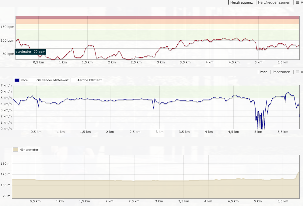

                                @ChrisA it is my only Suunto, yes. But I had a couple of Race S in here during a back and forth phase with my Epix Pro. Actually, it is my third Race S. They behaved more or less the same. The other watches had a crown that was somewhat hard to turn. So, I kept this one as the crown turned smoothely as it should.
                                This is one of the first recordings, so different Race S than I currently have. Just a walk in the park, no real pace changes, just flat land. In fact the last couple of meters I walked up the stairs to the forth floor in our house. Not reflected in the HR graph…
                                Suunto Race S
                                ChrisAC 1 Reply Last reply Reply Quote 0
                                • ChrisAC Offline
                                  ChrisA Platinum Member @2b2bff
                                  @2b2bff ah, I see - not very steady (looks like Polar’s Webapp?) So it seems that it’s really You and the Race’ sensor being not matching somehow
                                  Currently Race I
                                  2 1 Reply Last reply Reply Quote 0
                                  • 2 Offline
                                    2b2bff @ChrisA
                                    @ChrisA it is Runalyze… yeah, possibly it’s a me problem 😉
