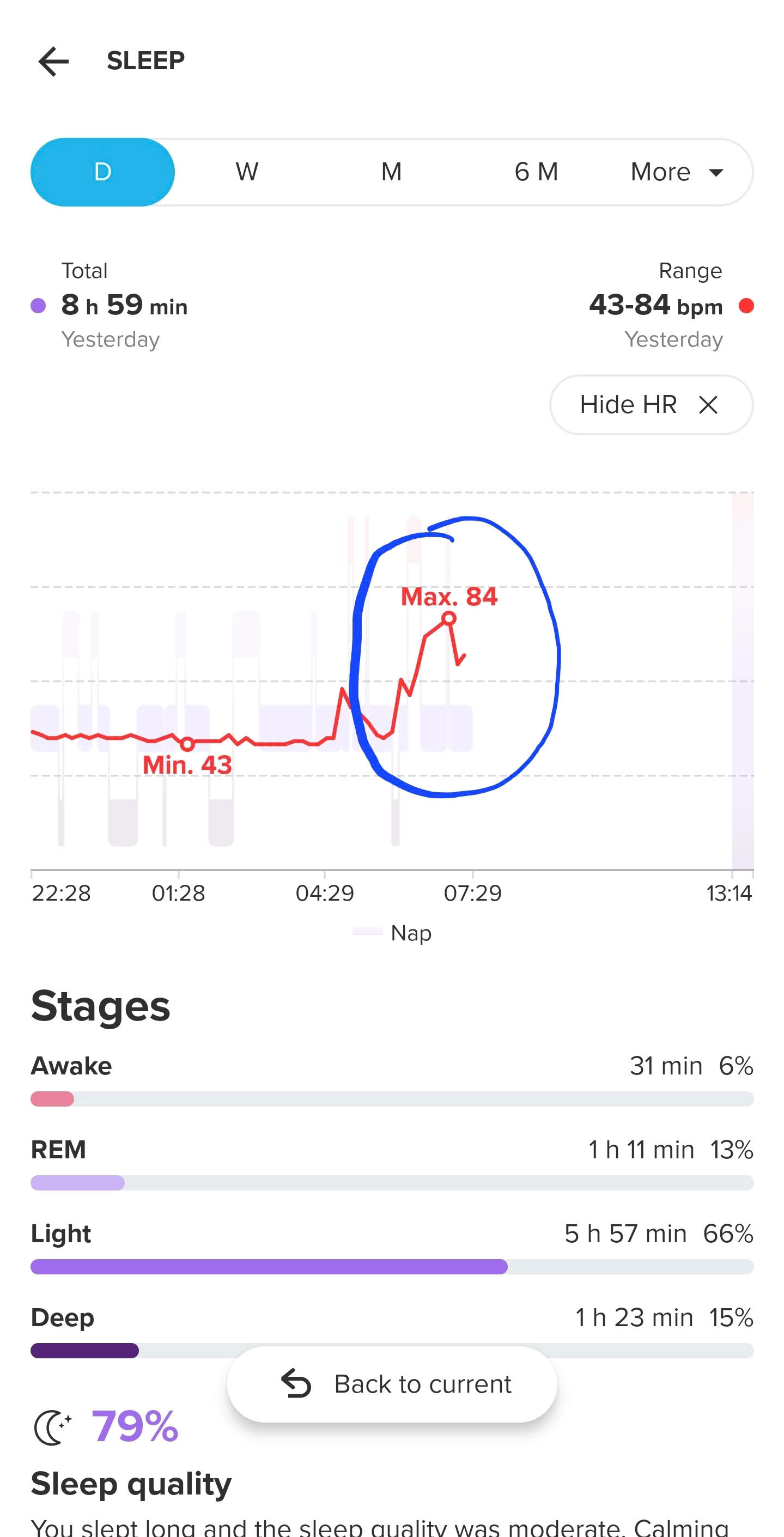

      I’m using a Suunto Race S (2.44.52) to track my sleep, and I noticed something strange last night.
      I went to bed at 10:28 PM and woke up ~ 6:00 AM. The watch recorded my sleep quite accurately up to that point. After waking up, I exercised for a while, and around 6:35 AM, I took off the watch and left it on my desk. Then, at 7:29 AM, I plugged it in to charge.
      However, after syncing the data, I saw that the watch continued to record my sleep until 7:29 AM, and marked 6:00–6:35 AM as “awake” time — as if I had gone back to bed!
      Has anyone else experienced this issue? Could it be a firmware or sensor glitch when the watch is stationary off the wrist?

            • V Offline
              vietpq Bronze Member @aiv4r
              @aiv4r Thanks! I double-checked, and it seems the watch actually continued to log heart rate data while it was just sitting on the desk.
              That makes me think the algorithm doesn’t fully validate HR data against wrist detection — so it keeps assuming I’m asleep if there’s no motion during typical sleep hours.
