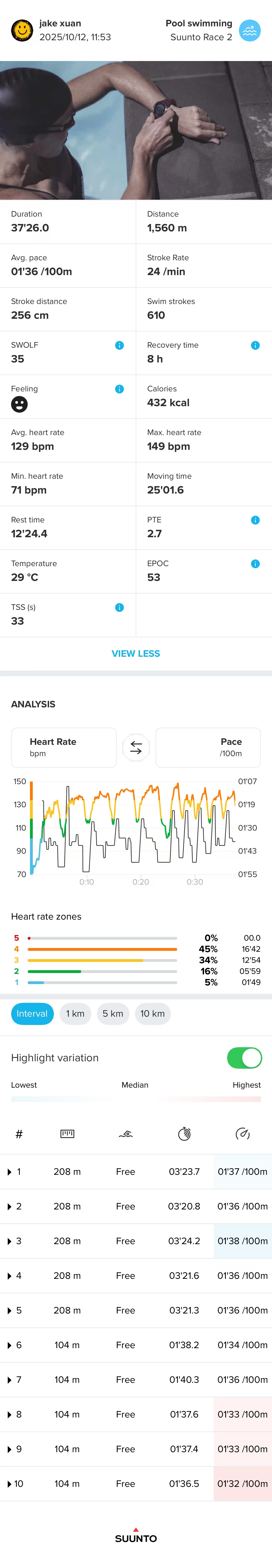

          • jakexuanJ Offline
            jakexuan
            And here’s what the data look like from suunto app after my pool swim yesterday.
            Sorry about the strange interval length coz the pool is 26m~
            I did 5x200m in 4’20"/set, and another 5x100m in 2’10"/set.
            To start AND complete the session by pressing the top right button, on top of that, i don’t have press any button during the whole session, but focus on the timing to push out on time. Normally i’ll keep the watch face at “interval list” so i will see how many intervals i’ve done and how long it took, simple it is~!c1bf1b3ee63e99929b35f06fb9c6977.jpg
            T 1 Reply Last reply Reply Quote 0
