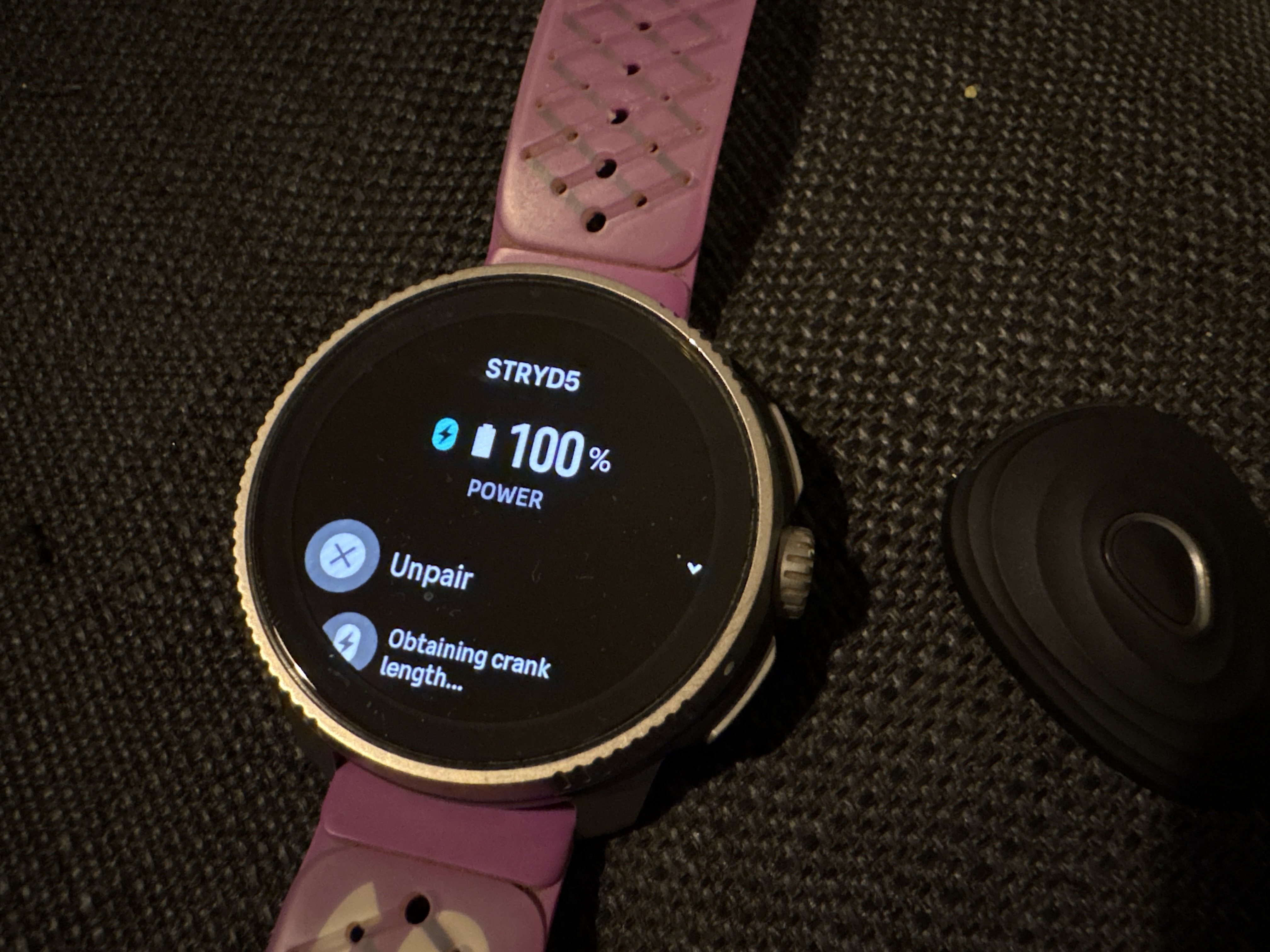

                I have the exact same problem. My StrydX works flawless, but I can’t get the Stryd5 to work properly. It looks like Suunto recognizes the Stryd as a bike power meter. The icon is also different when trying to pair. I’ve contacted Stryd last weekend on this issue, but no conclussion so far.
                By the way, this happen on my Suunto Race and my girls Race S. Same software under the hood, but still…
