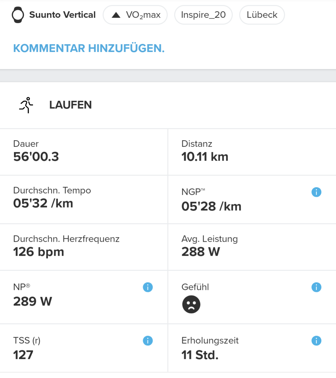

                                  • S Offline
                                    Shrek3k @Tieutieu
                                    @Tieutieu said in Software Update 2.44.52 (2025 Q3 - HOTFIX):
                                    @Shrek3k older activities have not changed. I’ll see if next runs are ok. I had tried to change the pace zones, but with the settings I have set my race should have been tagged has long aerobic. Hard aerobic is clearly linked to my HR
                                    Understood. I did a ‘new’ run (10,1 km) after the update, which still is on VO2max with an average HR of 126 and 5:32min/km.
                                    Checking the next run (unfortunately due to work/travel only next Tuesday or Wednesday).1000073963.png
                                    using a Suunto Vertical & Suunto Wings; mostly running (AKA stomping around) and cycling through the northern german "wilderness", and wherever else I have the chance to do so
                                    OS - Android 16/Pixel Pro 7
                                    S 1 Reply Last reply Reply Quote 0

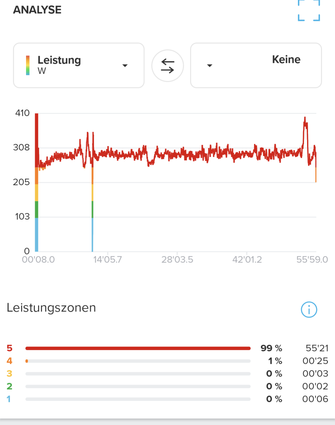

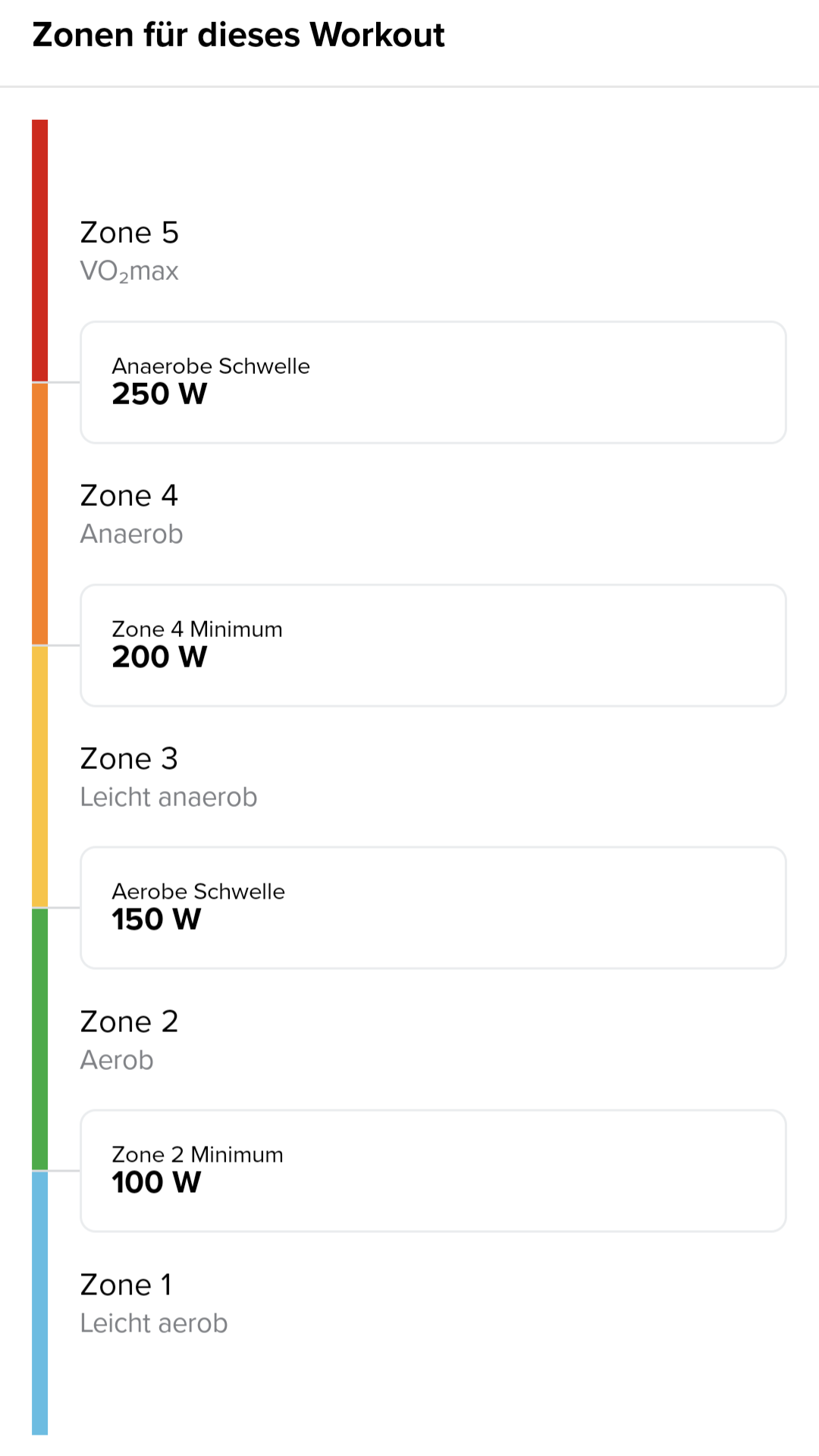

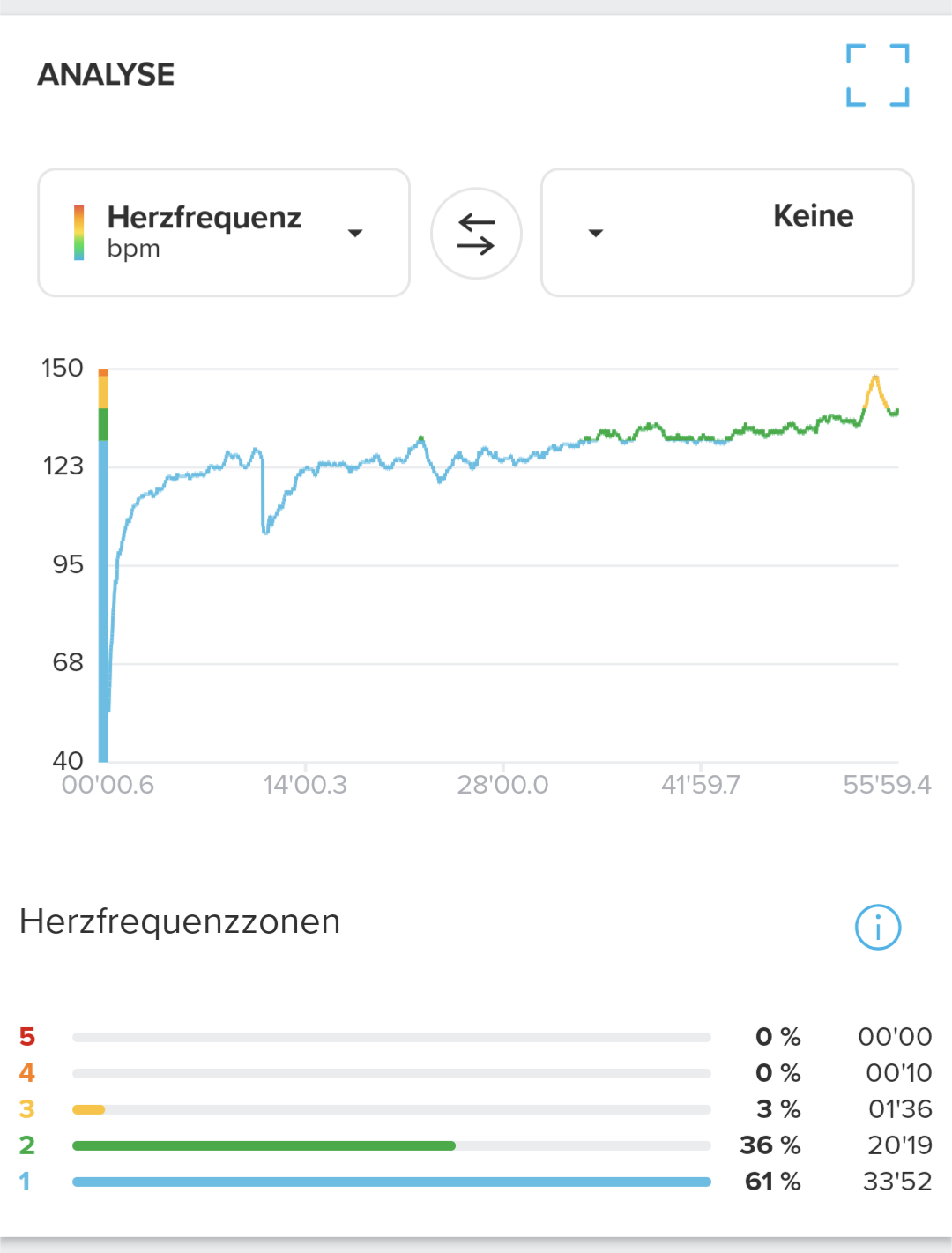

                                        • S Offline

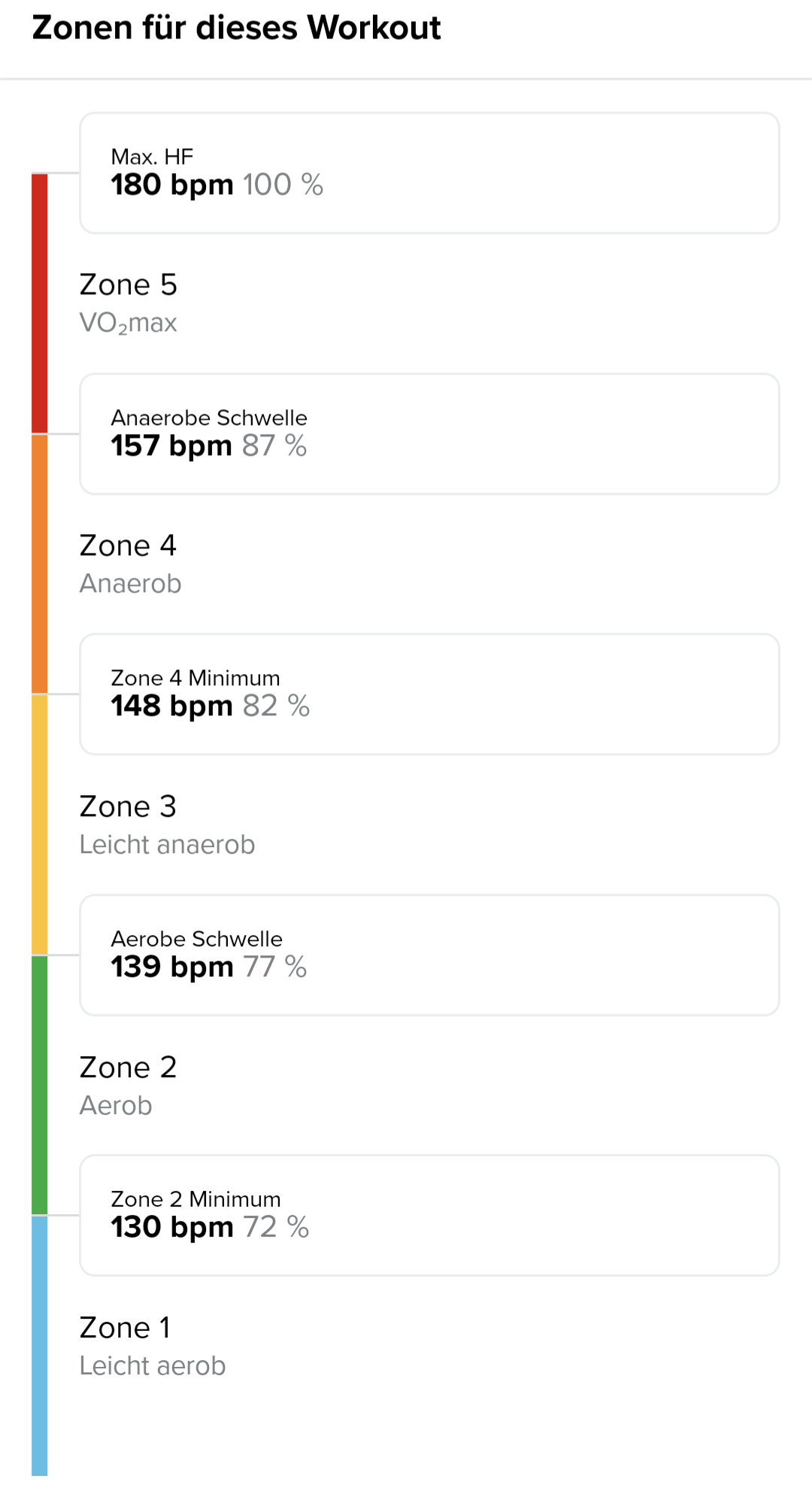

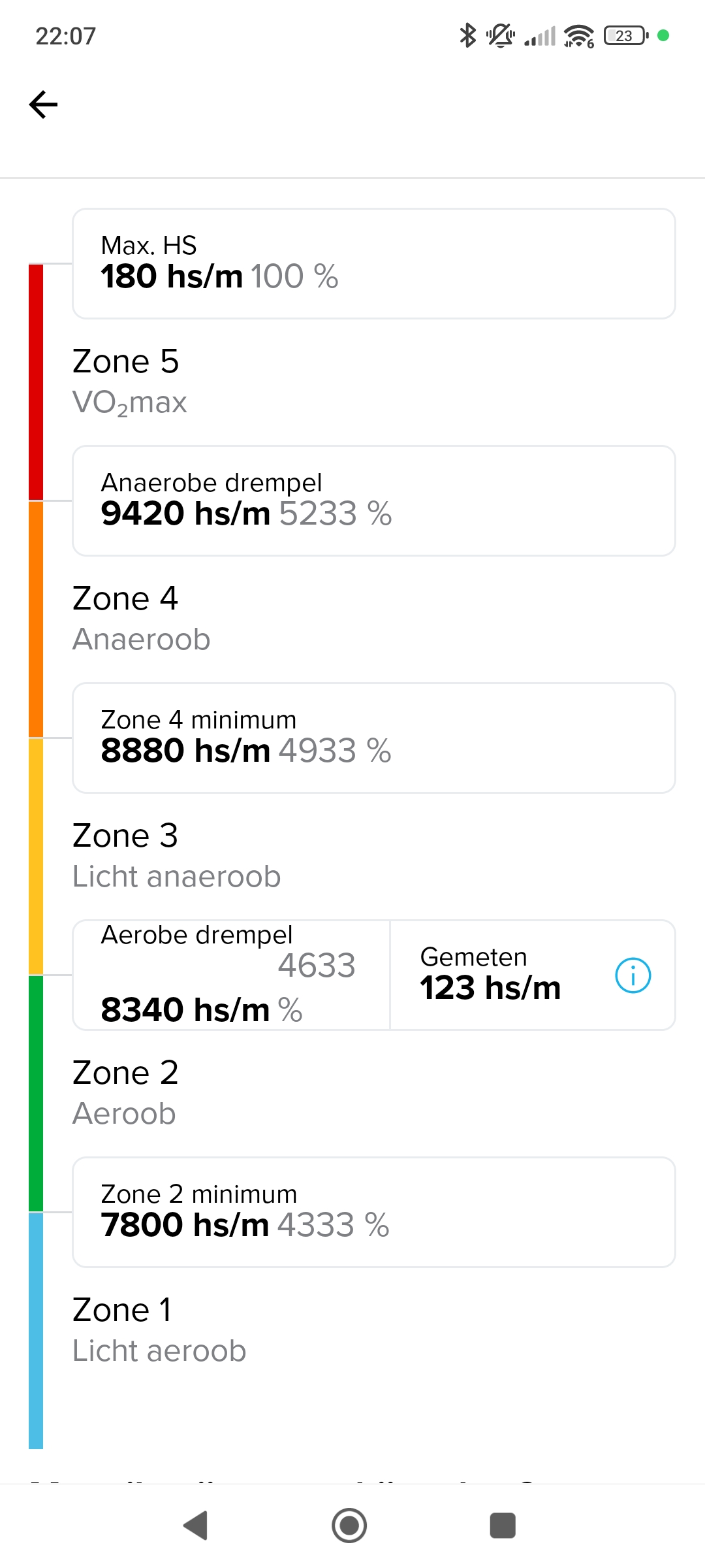

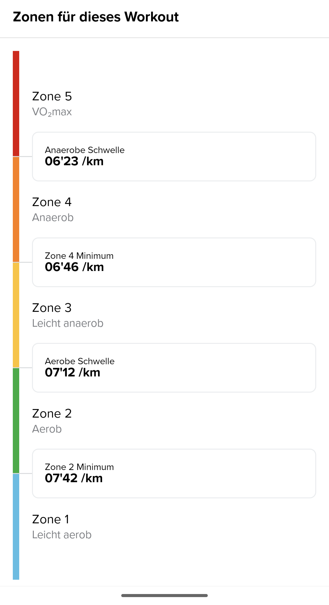

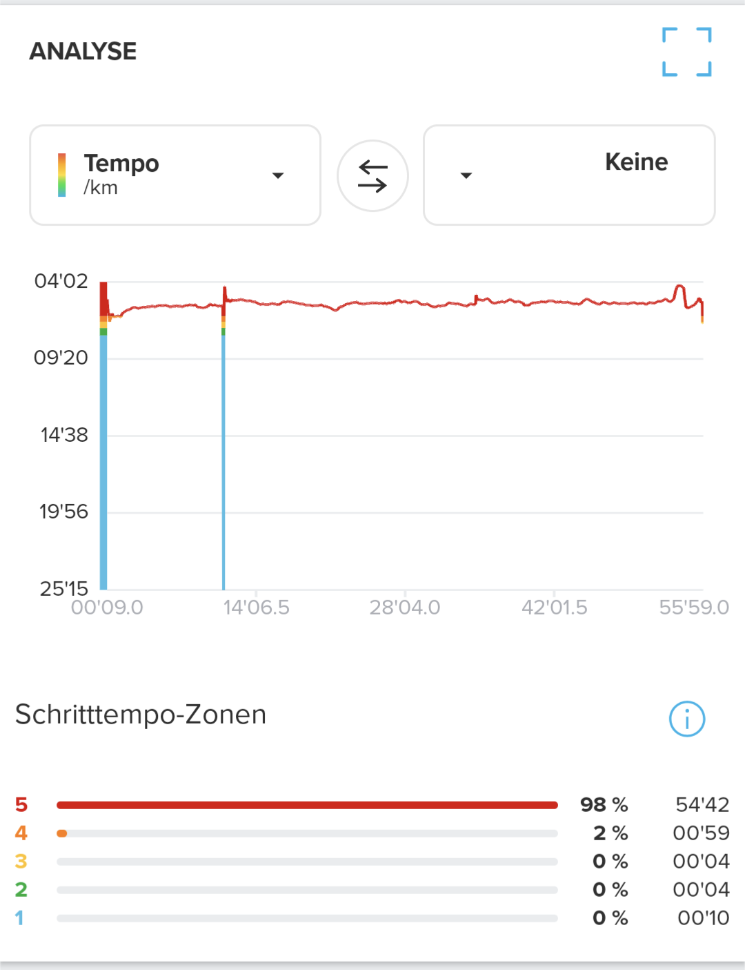

                                          Shrek3k @soisan

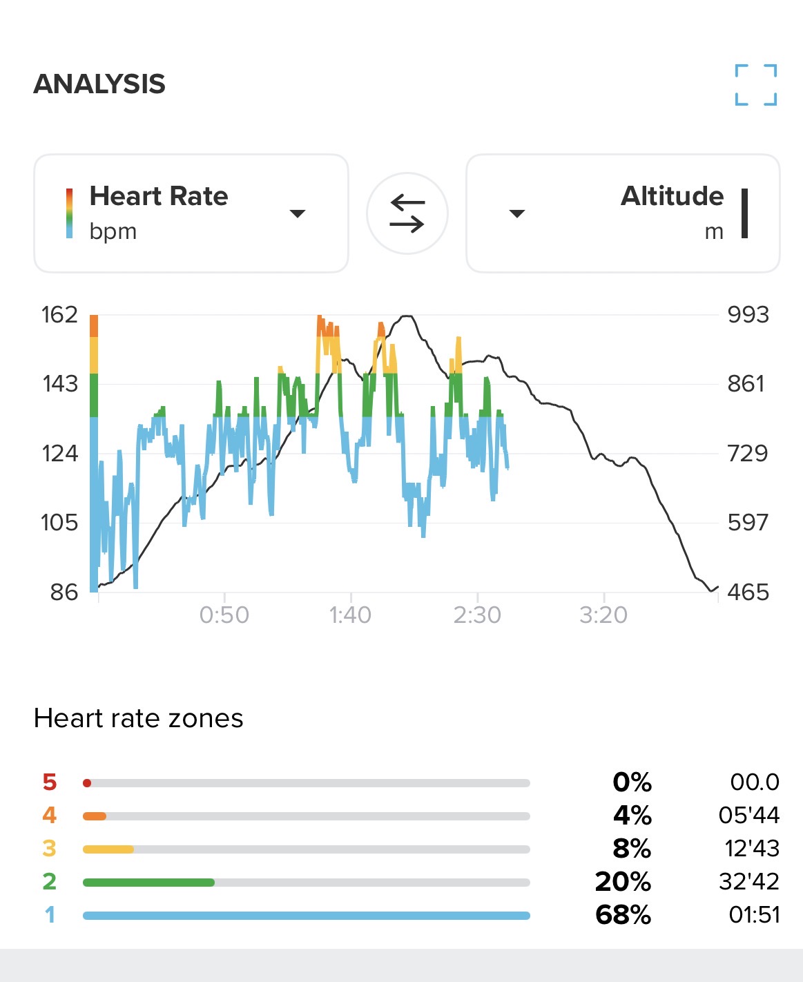

                                          @soisan I hope I have the right information (lost in translation might be an option).
                                          And no: I had not adapted the power / and or pace-zones ever before, as I expect(ed), that the App uses the defined/adapted HR-zones (only).
                                          Otherwise I expect to receive a strong recommendation that SA is unusable if not all zones are adapted (HR, power, pace) which will most probably make SA nearly unusable for all amateurs and every-day-users. Just my two cents.
                                          1000073976.png 1000073975.png 1000073974.png 1000073973.png 1000073972.png 1000073971.png
                                          S 1 Reply Last reply Reply Quote 1
