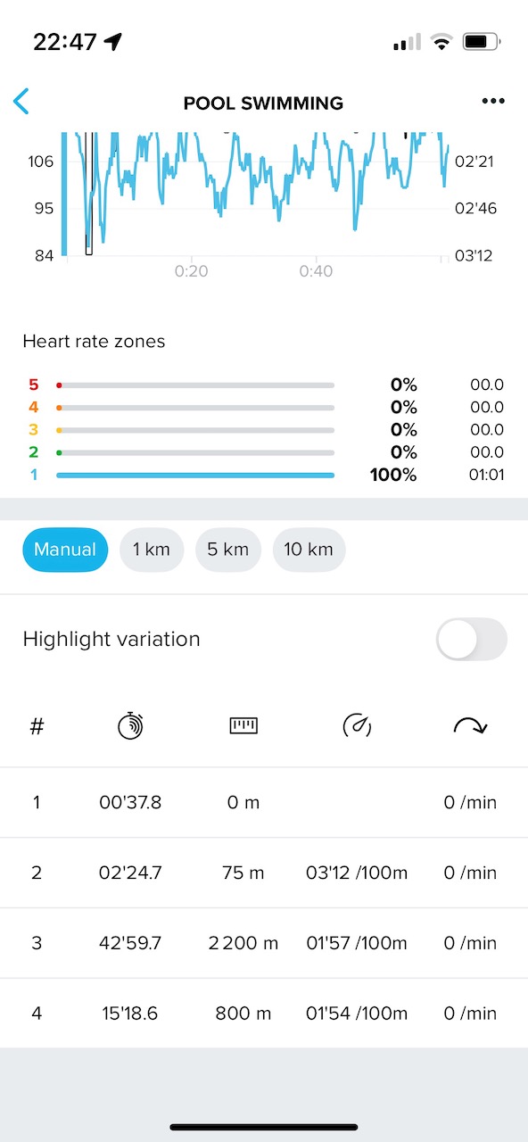

                  I seem to have the same exact problem: I cannot get info from my pool swims.
                  I did a swim of 3100m, broken into 300m warmup, with multiple stops at the wall, followed by 3 blocks, 1000m + 1000m + 800m, each continuous and divided by a 30-40 sec stop at the wall. My app shows none of this. Under “Manual” laps - I used the bottom button to try to mark some of the sets - it shows 75m + 2200m + 800m, which do not match my bottom button presses (I pushed the button according to the blocks I mentioned above), and they don’t add up to the 3100m total distance:
                  I have also seen in screen captures from users here in the forum a dedicated column for the swim style (freestyle, breaststroke, etc) which I cannot see in my activity. Also, in those screen captures (using other watches than the Run) there is a column called “Interval”, while I just see the “Manual” “1 km” “5 km” “10km”.
                  Is this expected ? I assume the Suuton Run is capable of auto detecting laps, stroke styles, pauses, etc, just like its specs pages says it does, for pool swimming ?

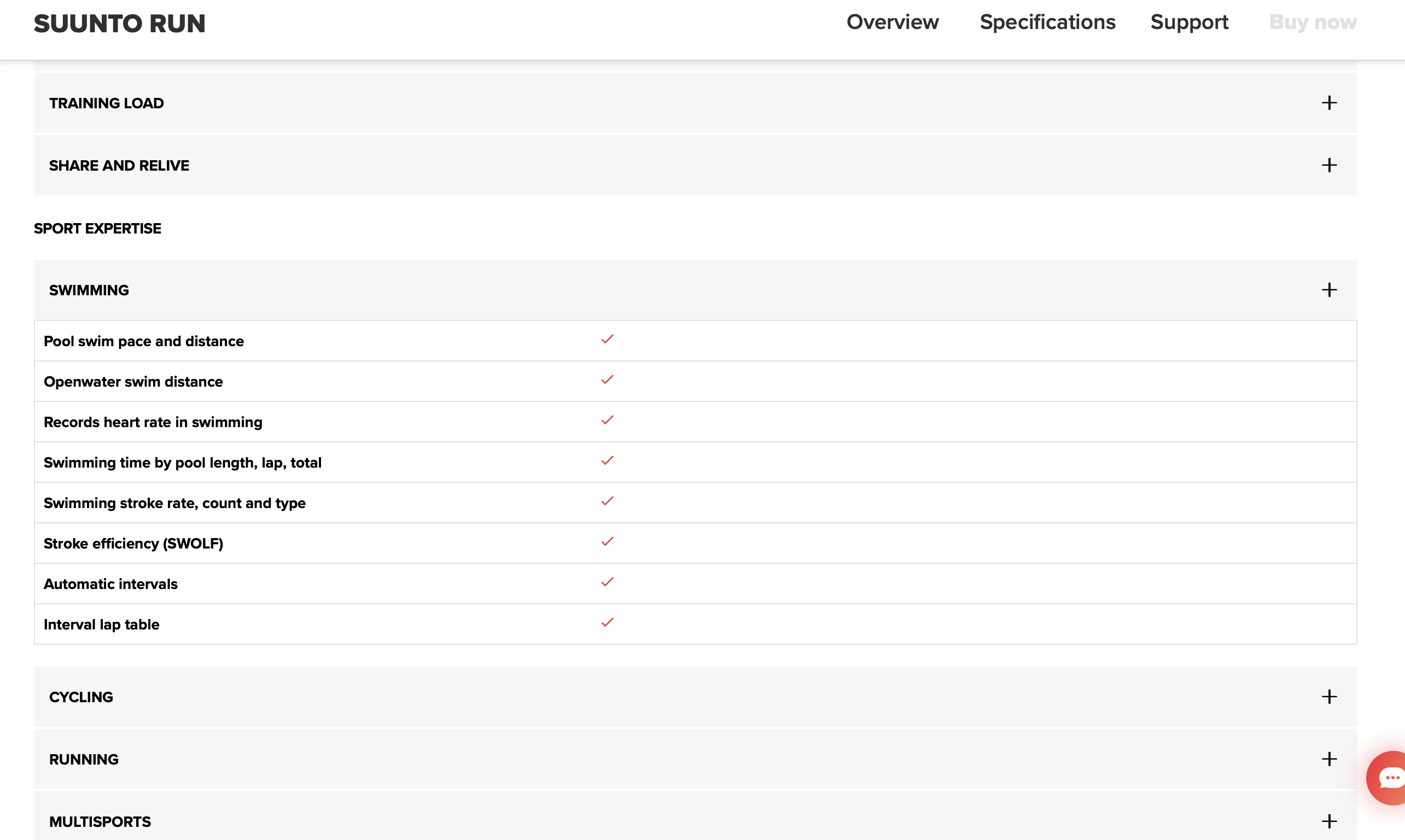

                    @herlas why do you write this ? According to the specs page for the Suunto Run, it’s supposed to do that and much more:
                    It should get metrics by length in the pool, as well as stroke type and automatic intervals. I currently also have trouble with mine, in seeing all this detail - I don’t.

                      But, I have the same problem as reported here: the specs on the product page of the Suunto Run for Swimming advertise that the Suunto Run should detect swim strokes, swim style, pauses and breakdown a pool swim into multiple intervals if there are pauses in between. Mine does none of these…

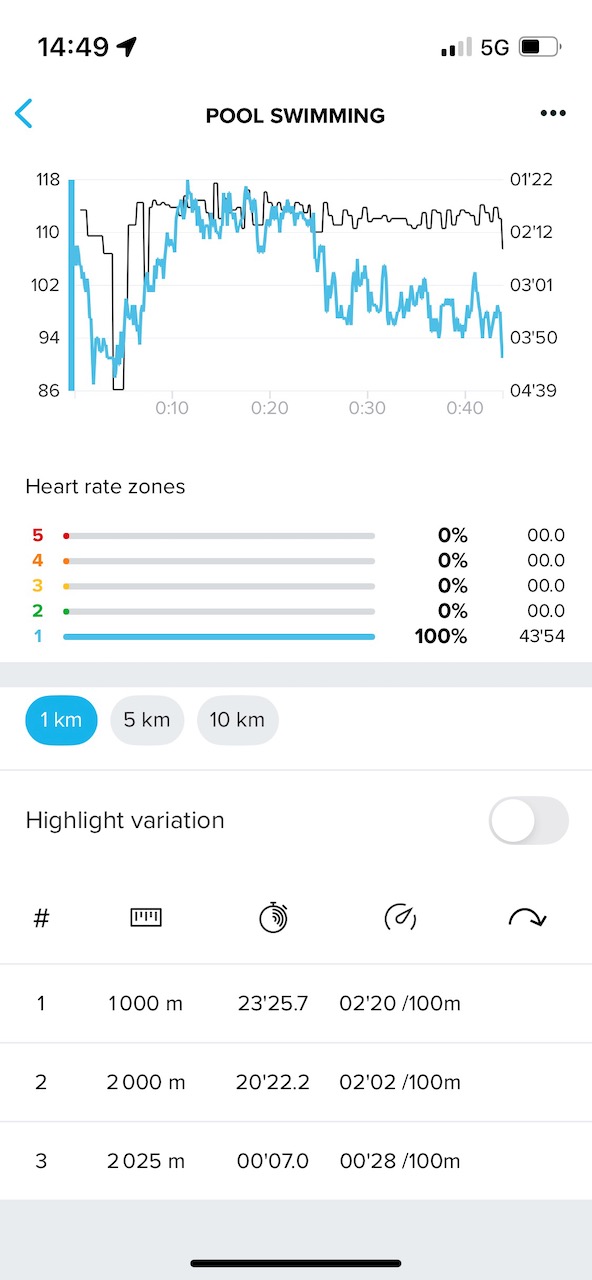

                      Here is a pool swim I just did a couple hours ago, where I swam 5x 50m, 3x 300m and finally 1x 1000m, all crawl with long glides after pushing from the wall. Notice as there is no breakdown into intervals whatsoever, no swim style detection and the last column (stroke average) is empty:
                      I’m not sure why another user here (@herlas) mentions above that this is a known issue and unsure “if this will come”, considering the product page advertises the watch as capable and supposed to do exactly these things … this is a deal breaker for me, as I expect to be swimming as much as running. But, I still have not found any clarity regarding these features: is the Suunto Run supposed to give metrics for pool swimming or not ? (just like any Garmin watch would…)
