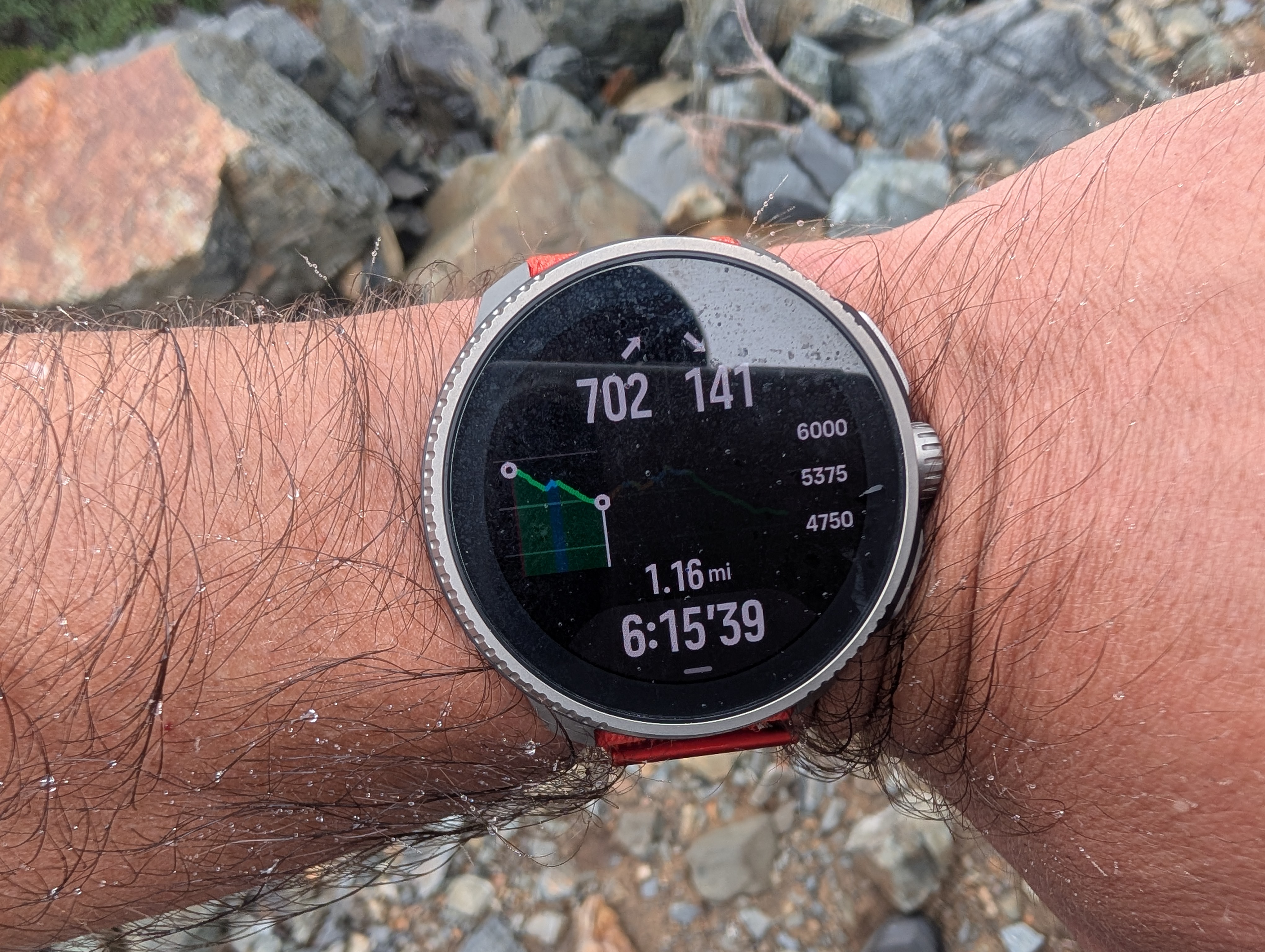

      The example of the zoom level #4 (the full profile) is shown in the photo below:
      At this point, you’d think it should be possible to zoom in twice - to zoom levels #2 and #1. Obviously, we cannot see three segments because there are only two remaining - from the current point to the last waypoint and from the last waypoint to the end.
      However in reality, the watch allows me to zoom in only once to zoom level #1 - to see the part of the profile from the current point to the last waypoint and where the second from the end climb ends. But there is no way to see the profile from the current point to the end at a zoomed in fashion - the watch doesn’t allow that. The same works at the beginning of the route but doesn’t work at the end of the route. One can argue that the entire remaining profile is already shown in the above view at the zoom level #4 so there is no need to zoom in any further. However, as you can see, the profile is really compressed and it is difficult to see any details. What I want to achieve and can’t is seeing only the highlighted, remaining part of the profile stretched horizontally as much as possible, which is the point of having the zoom in the first place, but that doesn’t work as desired.
      It seems the zooming logic is based on the number of remaining waypoints rather than profile “segments”, which I think is flawed because nobody is going to have a waypoint at the very end.
      Can this please be fixed? The zooming logic should work as if there was an additional waypoint at the very end of the route.

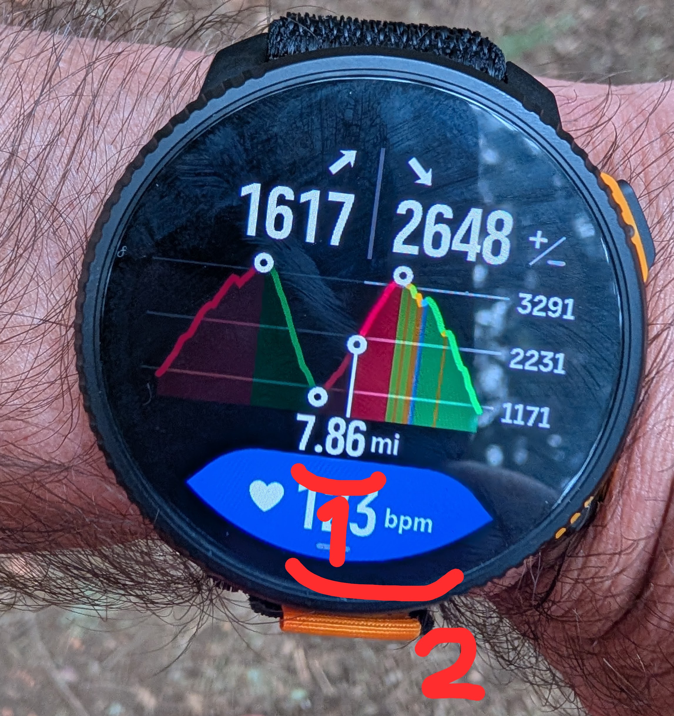

                          Also, if anyone from Suunto sees this, the way the profile is rendered makes it harder to use the feature. In my opinion, when the already covered part of the profile is rendered, the already visited waypoints should be less bright or not rendered at all because they no longer matter, but the profile line should be more visible to give a better sense of scale of where you are on the overall profile. As it is currently rendered, the already visited part of the profile is practically invisible.
                          Also, if possible the font for the remaining distance should be a bit larger - that is a very important data point. At the same time, the font used for the remaining climb and descent could be a bit smaller to give the profile a bit more vertical space.

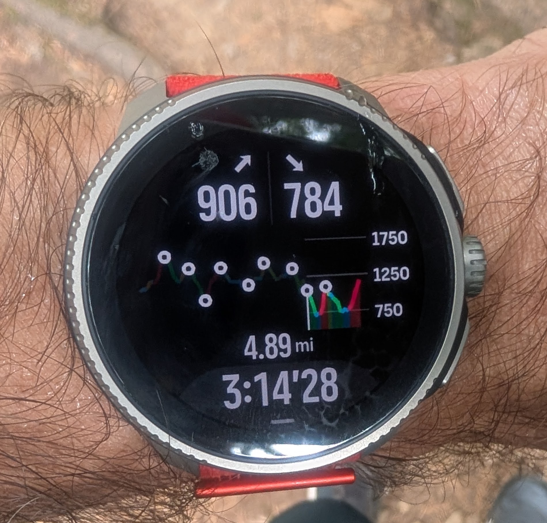

                                            Unfortunately, this feature is still not fixed in 2.53.42.
                                            Here is an example:
                                            To be clear, the small white circles are waypoints.
                                            From where I am I can switch to the zoom level 1 shown in the picture, but the zoom level 2 is not available. It was available in the first part of the run, for example showing the first climb and descent together or showing the first descent and the second run together. But it is impossible to zoom into the second climb and the second descent together - it either the entire elevation profile or just the segment to the nearest waypoint.
                                            Imagine these waypoints to be aid stations during a 100 mile ultramarathon. At the end of the race, we loose an ability to use middle zoom levels. So it is either a single segment or the entire profile, but the entire profile showing 100 miles isn’t usable because all climbs and descents are super compressed horizontally.
                                            Please give this fix a priority!
