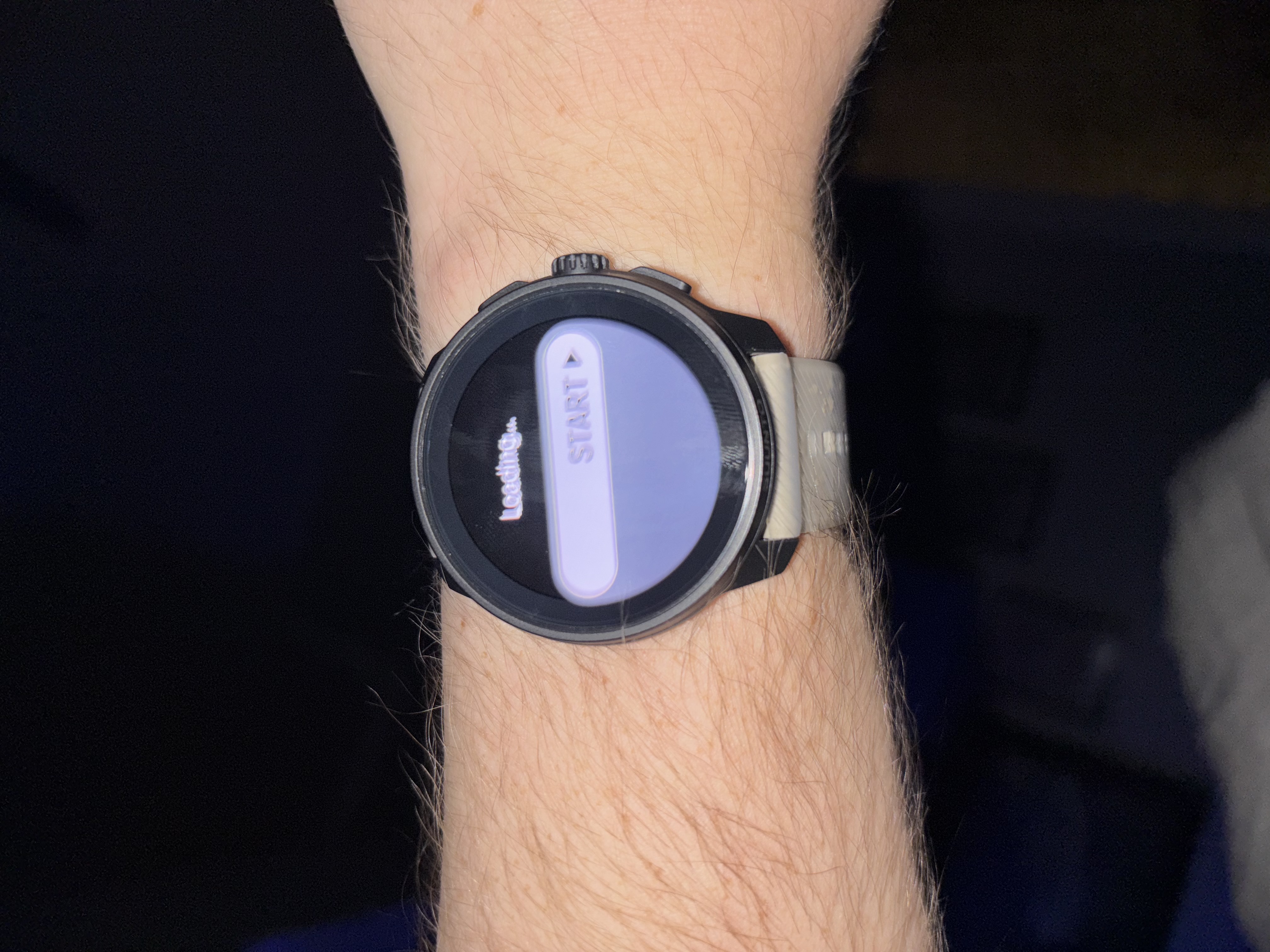

      Last night my Race S auto-updated itself to 2.44.46. After the update, it was a blank slate, requiring me to re-enter all of my personal data, re-sync the watch to the app (after removing it from my phone’s Bluetooth, turning my phone’s BT off/on again) and then needing to turn back on all of the features like heart rate and sleep tracking. During this process I had to turn the watch itself off and on again a few times as it would get stuck or just refuse to pair.
      After that, everything looked okay except for the workouts screen. I can’t even navigate to it in the watch because once I do the whole watch freezes and requires a restart, you can’t back out of the screen.
      I just got this watch a few weeks ago and have already updated it once, and it did a similar “wipe the watch” during that update as well. Is this expected? I want my watch to “just work”.

        @alp1n3 not expected at all, contact support as if your watch gets stuck after every update it may be defective

          @alp1n3 mine did the same. I went in to the app and created a custom sport app and this was the only way that made it work again for me.
          I went in and created a “Daily Run” profile with custom screens (probably wouldn’t even need to do that much) and it worked normally again.

            happened to me as well. my solution (after watch restart) was scrolling up, choose sport mode. than button for activity started to working.

                    @isazi It was a very, very bad update experience. Half factory reset, or something. Widgets (and order of them) were retained - once I had chosen Language etc as on a new watch - but all personal data was erased. Age, weight asf. AND Heart Rate zones… (and Pace/Power zones).
                    Worst was the freezing of the empty screen after pressing the ‘activity’ button (top, above wheel). Had to hold the button for 20 seconds to initiate a reboot. Tried that multiple times since I didn’t believe my own eyes: “How the heck could they break this so badly?”. Later did what others also did and created a quick “Sport mode customization” to fix that bug - did not think about starting by using the wheel upwards and using one of the defaults there…
