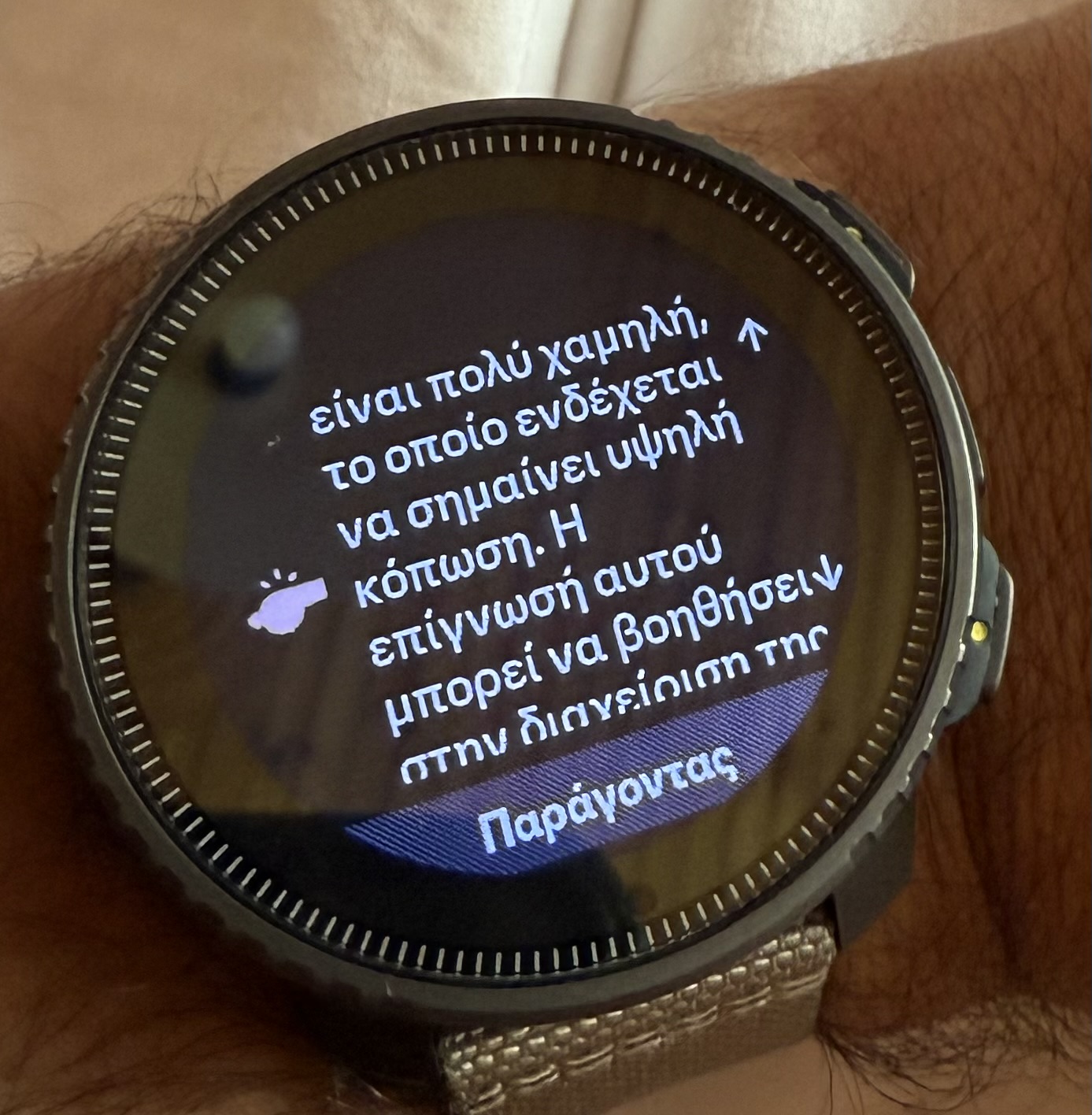

            Some things where text doesn’t fit within the vertical boundaries and not being visible in the new widget
