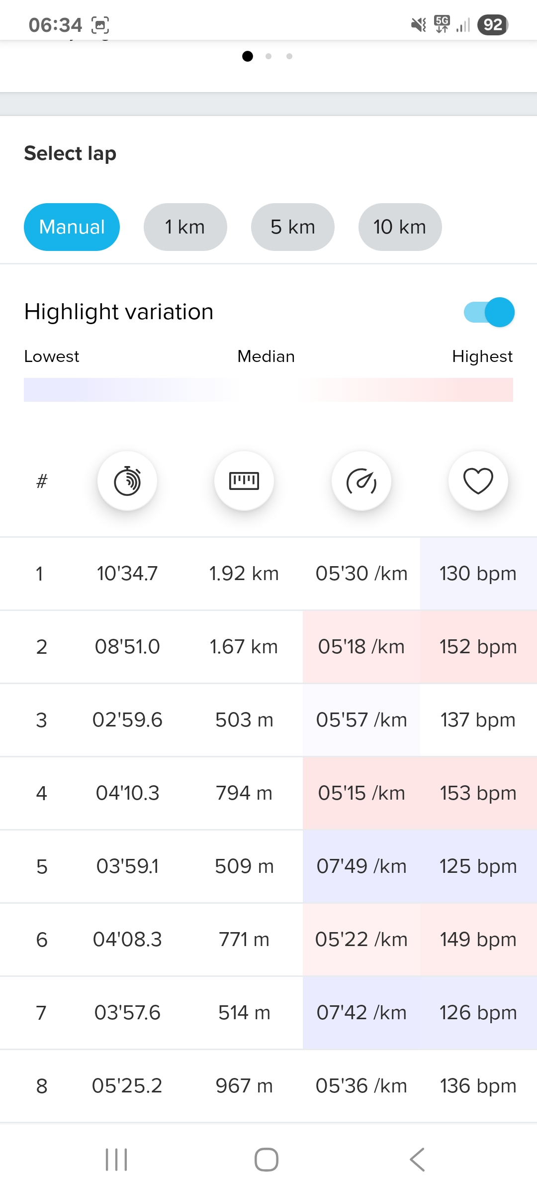

                  I did a run yesterday on the treadmill
                  2km@5:21
                  2km@4:25
                  0.4km@7:30
                  1km@4:08
                  0.4km@10:00
                  1km@4:08
                  0.4km@10:00
                  1km@5:21
                  All of it was done on 1% climb and I have a Norditrack commercial 1750 (not that it matters)
                  Here is how suunto recorded the pace:
                  As you can se only the first and the last interval are near the pace (as the last run was in that neighborhood), everything else is way off.
                  Karoo3 (2024)
                  Vertical allBlack (2023)
                  9 Peak Black (2022)
                  Spartan WHR Black (2017)
                  Ambit 2 Black (2013)
                  G 1 Reply Last reply Reply Quote 0
                  • G Offline
                    Gunnar Bronze Member @Ketoohs
                    @Ketoohs said in Treadmill - adjust distance bug or useless feature:
                    And you know why?
