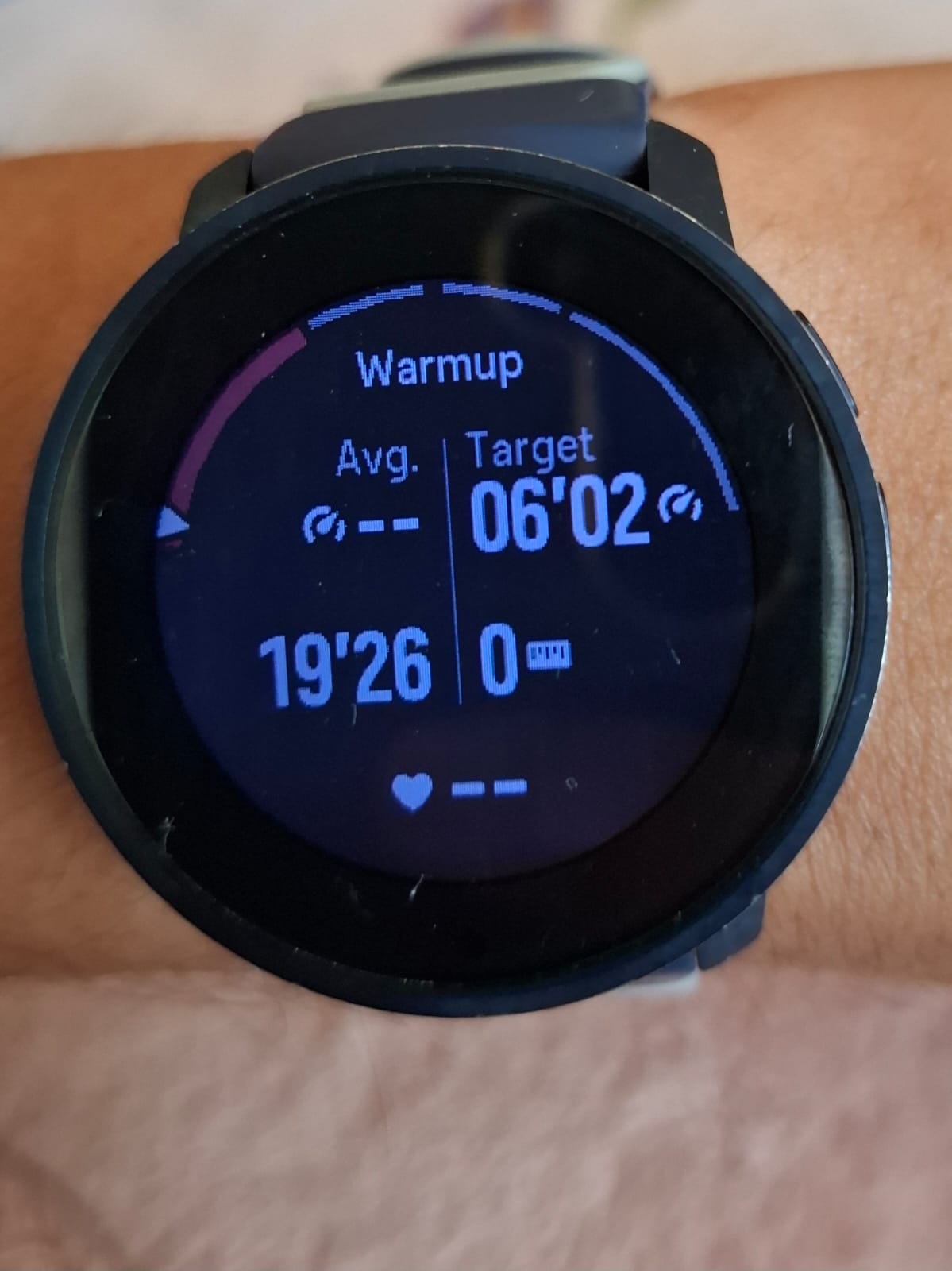

          Actually when you look at the interval screen using a structured workout the watch shows average pace, not current. At least for workouts created with third parties, not sure about SA. This is for S9PP it might be different for Race.

            @Francesco-Pagano Are you sure? At least for Heartrate it looks like its the current value, not average. I am using TrainingPeaks workouts

              @VoiGAS yes I checked multiple times with intervals.icu. It’s average pace if you have pace-based workouts, current HR and power (as much as power can be “instant”) for HR- and power-based workouts. The gauge still indicates where your current pace is in comparison to the target. Here’s a screenshot from my sofa 😄

                @Francesco-Pagano Very interesting, thank you!
