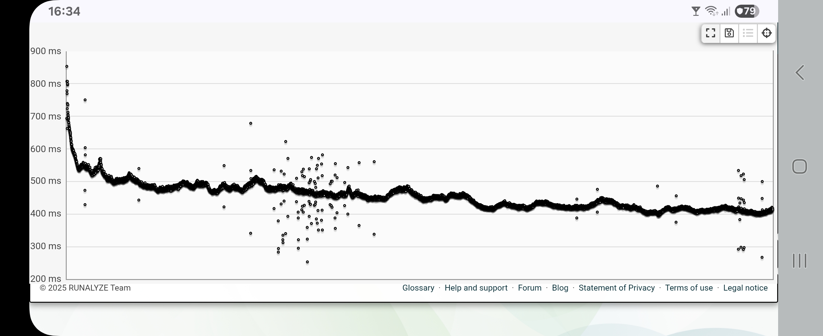

      This has worked well, with little problems regarding both Puls and Heart Rate Variability. A typical HRV curve looks like the Runalyze graph below, which only has 0,8 % Anomalies. And that is what Suunto ZoneSense really craves; reliable data:

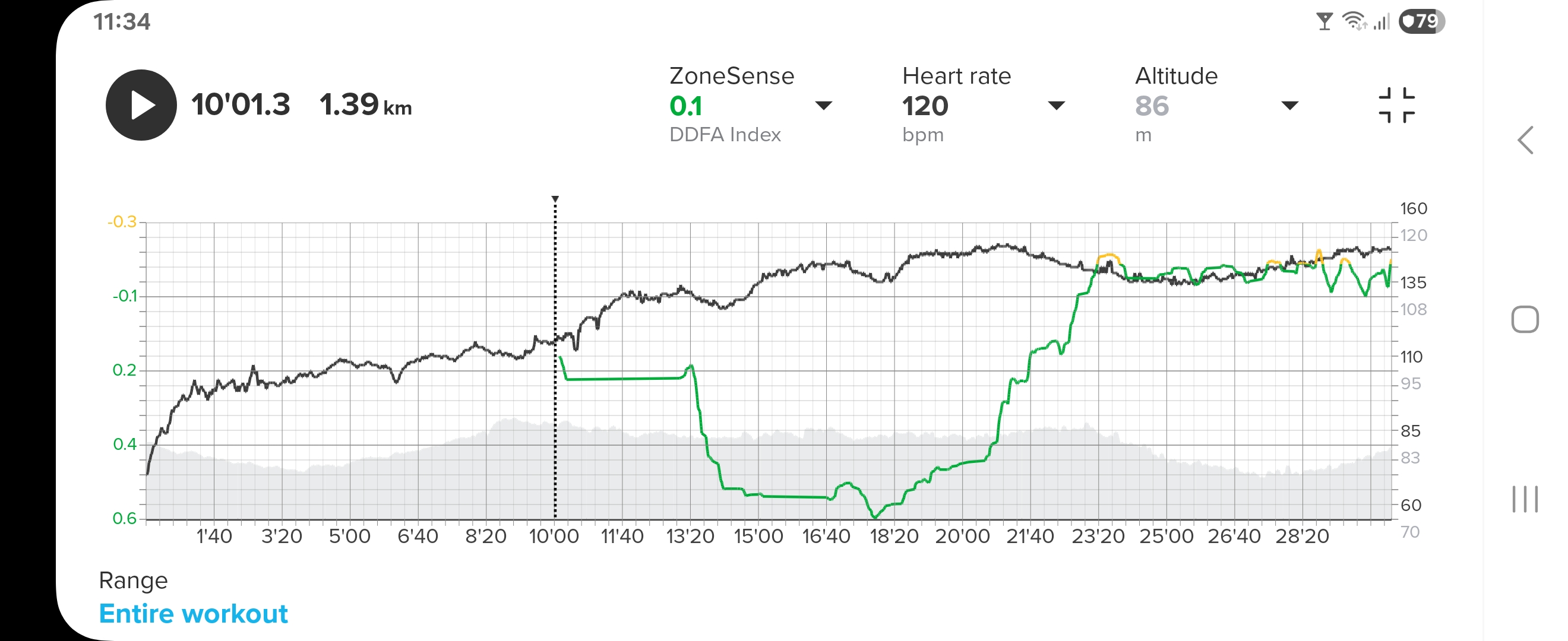

      Today I returned home after a short Run session and realised that I had snapped the HR module on upside down. Well, I thought, it shouldn’t make much of a difference since (to my knowledge) there are no other sensors present - like gyroscopes or accelerometers. But when looking at the ZoneSense graph I really stood corrected! This is not a normal result in my case:

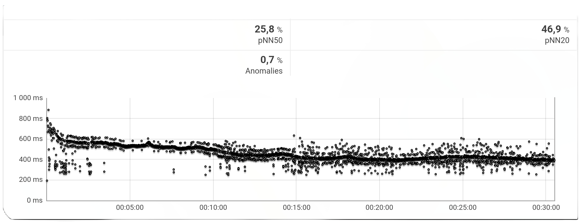

      And although Runalyze claim that the session only had 0,7 % Anomalies, the graph looks rather suspect:
      Using the ‘fill screen’ button to zoom in on the graph, we see even clearer that the main line is surrounded, above and below, by two fuzzy ‘ripple’ or ‘echo’ areas:
      So, not only are we in danger of getting bad HRV data through the usual channels like dry belts, poor belt contacts, static electricity, worn-out belts asf, with the Suunto belt, module orientation is imperative. This surprised me to such a degree that I felt compelled to write this forum post.

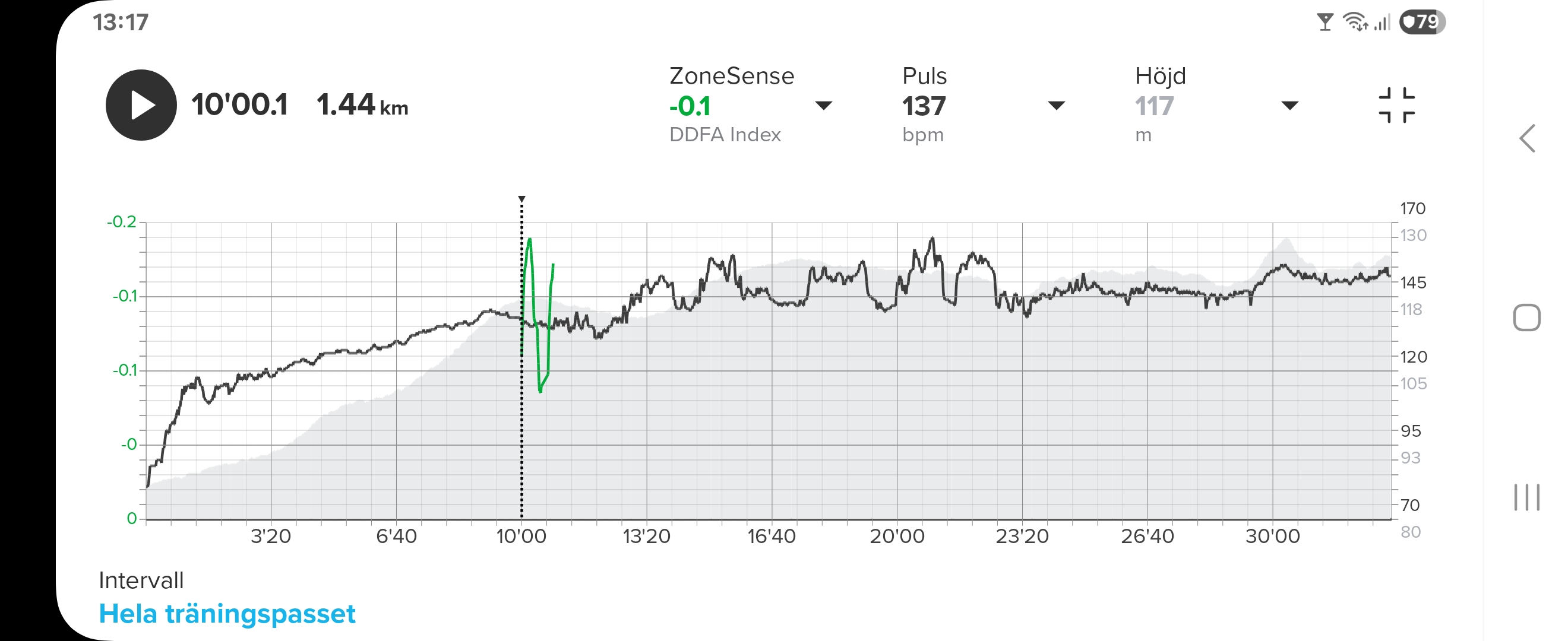

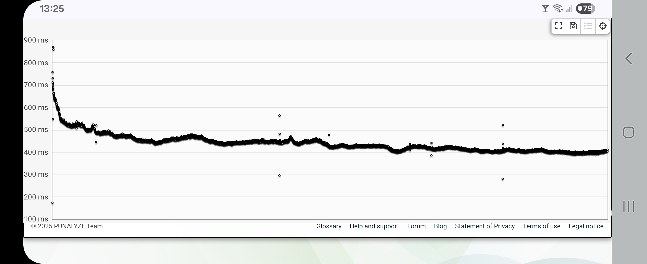

          The flipping result is indeed surprising. The example of a normal HRV graph I posted was from Saturday, chosen because of the Run session length being closer to today’s than the session length yesterday which I’ll provide as an OK evidence below. 0.0% Anomalies according to Runalyze:
          There are some scattered readings but nothing that affected ZoneSense:

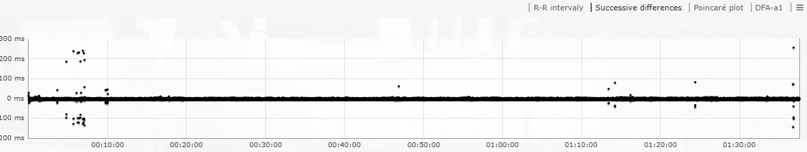

            @Inge-Nallsson I got this scattered reading when my heart is skipping. I have an implanted ECG monitor and have been diagnosed with ventricular extrasystole, along with occasional short pauses in my pulse. When I feel my heart skipping during running or cycling, and then later look at the R-R interval chart or successive differences chart, I can clearly see the symptoms at the exact moments I felt them. Many people have this condition and don’t feel anything. I’m “lucky” enough to feel every single extrasystole 🙂 — and sometimes it’s very annoying. It shouldn´t be dangerous if there are no other symptoms. But sometimes I got this reading even with no symptoms, when I feel good and that must be anomalies.
            This is run with my problems, 0.1% anomalies, successive differneces:
