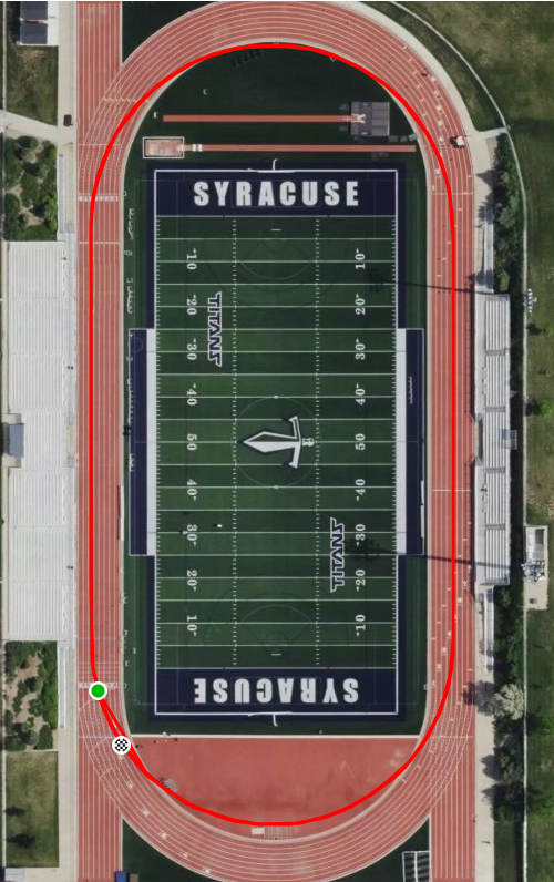

      With the recent update enabling lane calibration features with the track mode activity, I thought I would give it a try. I selected the basic track mode from the activity list, selected lane 1 to run in, then ran 4 laps around the track.
      Unfortunately as you can see, the GPS track isn’t aligned very well over lane 1 with my local high school track when looking at the satellite map on Strava. I’m guessing this is because Suunto is using different 400 m track dimensions than a typical United States high school track around an American football field? If so, can the dimensions be changed in the watch?
      Also, as has been common on my Ambit3 Peak, 9 Baro, and now the Race S, the first several seconds after pressing “Start” records 0 to the watch, including GPS coordinates. So in this activity, the first 8 seconds have a glitch GPS track from where I pressed start to when latitude/longitude coordinates are recorded.

          It’s probably the track isn’t an official athletics track. Trackmode doesn’t make gps more accurate. It just snaps you gpx to what it thinks is the track.
            Yeah, understood. I don’t know the precise dimensions of the track. I know that the IAAF permits three non-standard dimensions, including double-bend 400 meter tracks.
            I believe (but don’t know for certain) that this track is a double-bend with a 97.256 meter straightaway and inner curves of 102.744 meters. This is the common alternative for tracks that enclose an American football field.

                  Its not so much to snap it to track on a Satelite image that might be offset 😛
                  but rather for pace stats and distance
