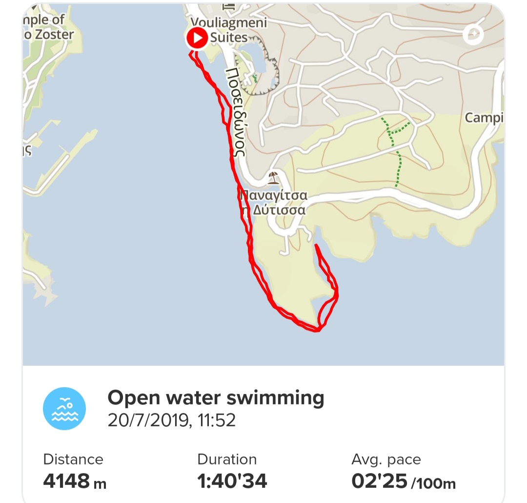

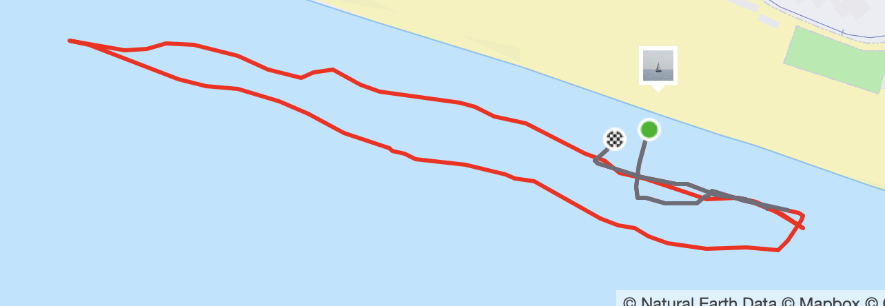

      In case anyone has forgotten what a good OWS track looks like, I used… another watch yesterday. I was using my FORM goggles, with their swim straight feature (shows a compass heading live as I swim, so I can be confident of swimming in a straight line).
      My inflammatory post aside, has everyone logged this with Suunto support, with a reference to this thread?

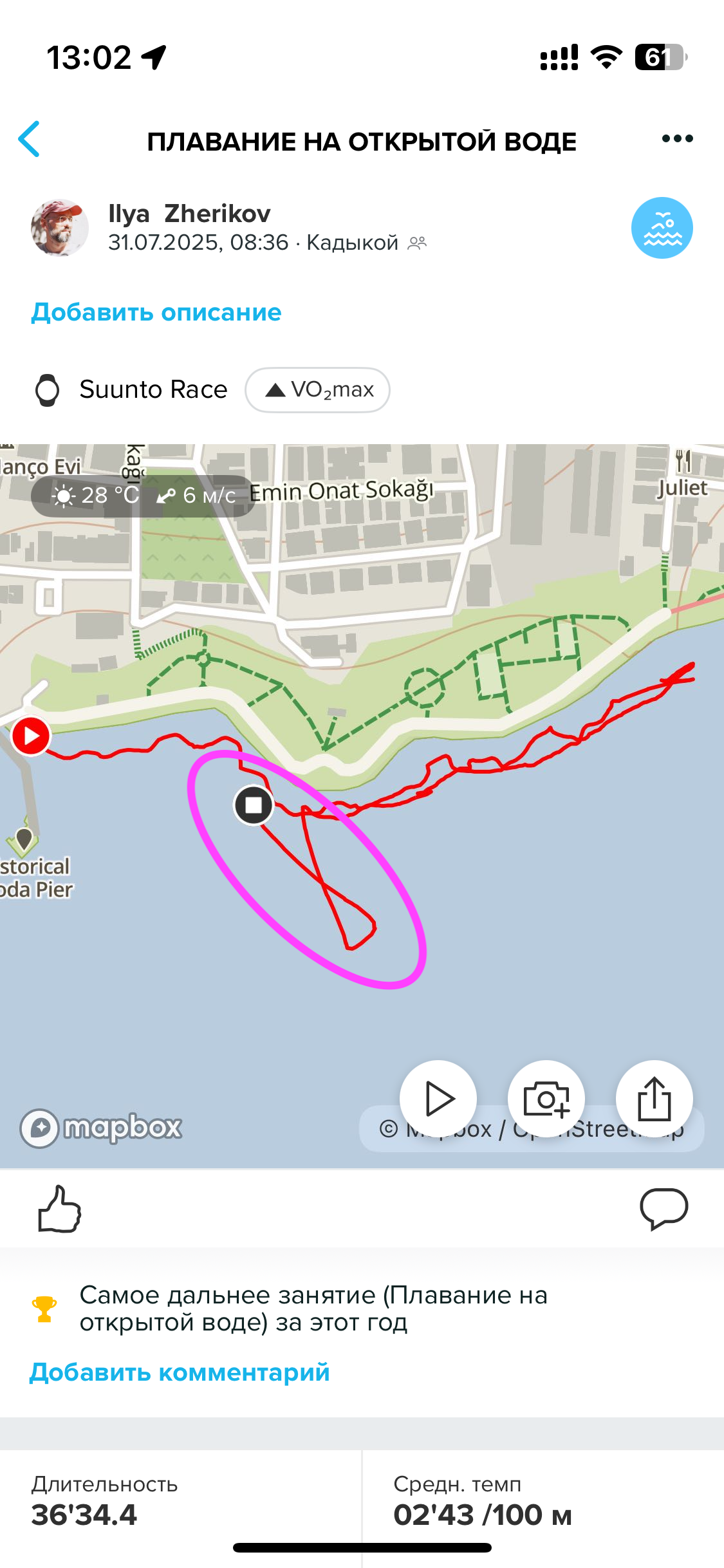

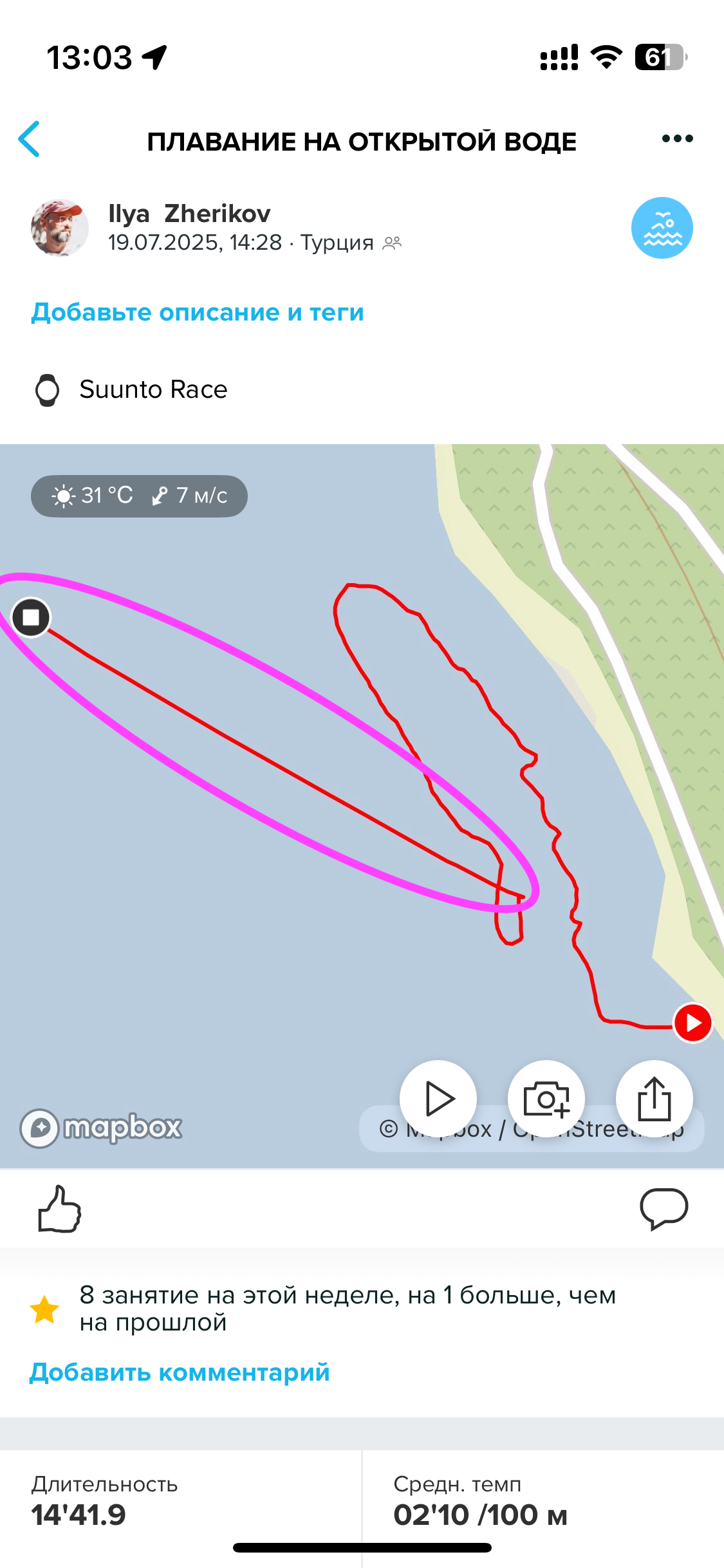

          I have exactly the same problem with my Suunto Race, even though I always sync the watch with the app before training, and I swim freestyle only.
          I had no such issues last summer, so it’s obviously connected to the latest firmware updates.
          I’ve reported the issue several times through the app, but never got a reply, nor even a confirmation that my reports were received.
          The whole situation really pisses me off, as swimming is almost the only sport I can do now (I had a bad knee injury, so no more running, cycling, or anything like that). At this point, I’m even starting to consider switching to Garmin, though I was generally happy with my watch before.

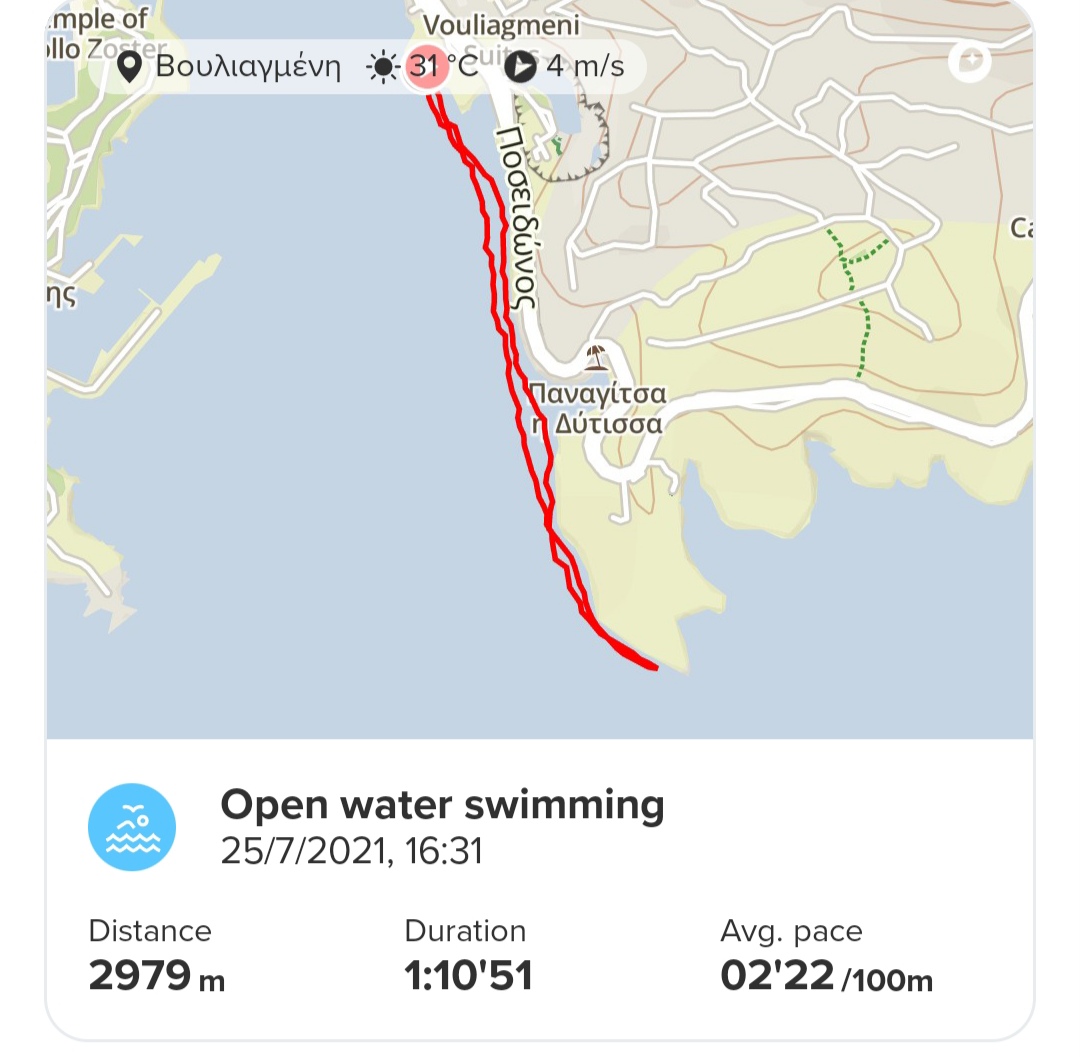

          • gerasimosG Offline
            gerasimos Bronze Member @Ilya Zherikov 0

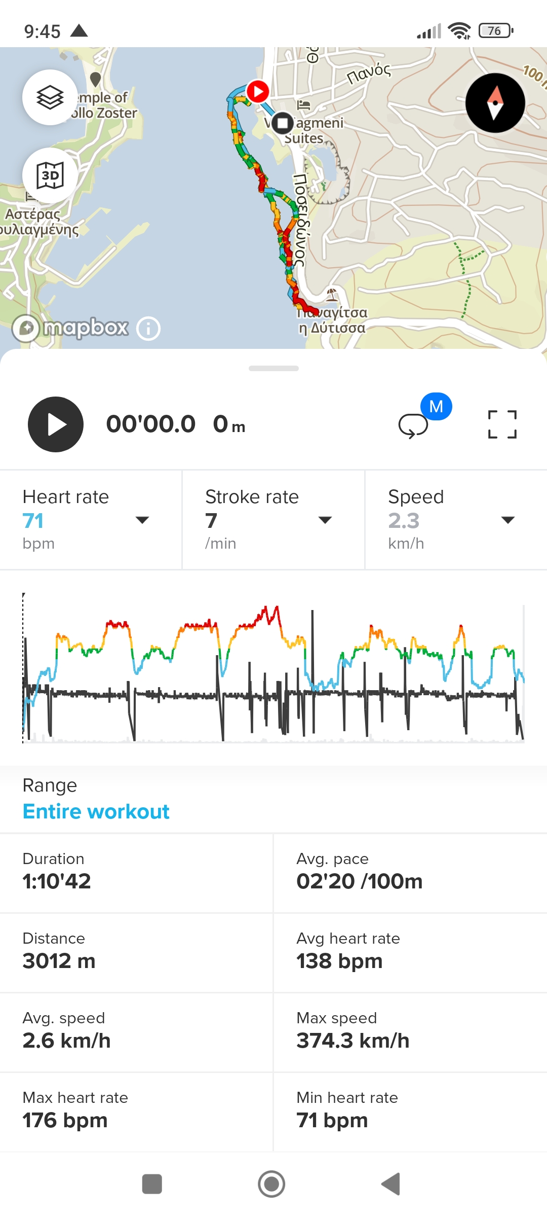

            @Ilya-Zherikov-0 I hope your knee heals quickly and you can get back to all your activities soon.
            It’s completely understandable to be frustrated with a situation like this. As for me, I’ve tried every possible test, (and triple check with others models in same hand)and the only thing left is to wait and see if a GPS fix come, If not, then unfortunately I’ll need to invest in a watch that’s reliable for open-water tracking. (For other activities SVti works absolutely perfect in every aspect)
            I really don’t want to keep it inside a swim buoy or carry two watches, merge .fit files…etc -even if that means accepting small deviations from the actual distance-
            But nothing like the crazy inaccuracies it’s been showing this year… It’s like my Suunto watch have caught a GNSS virus😄

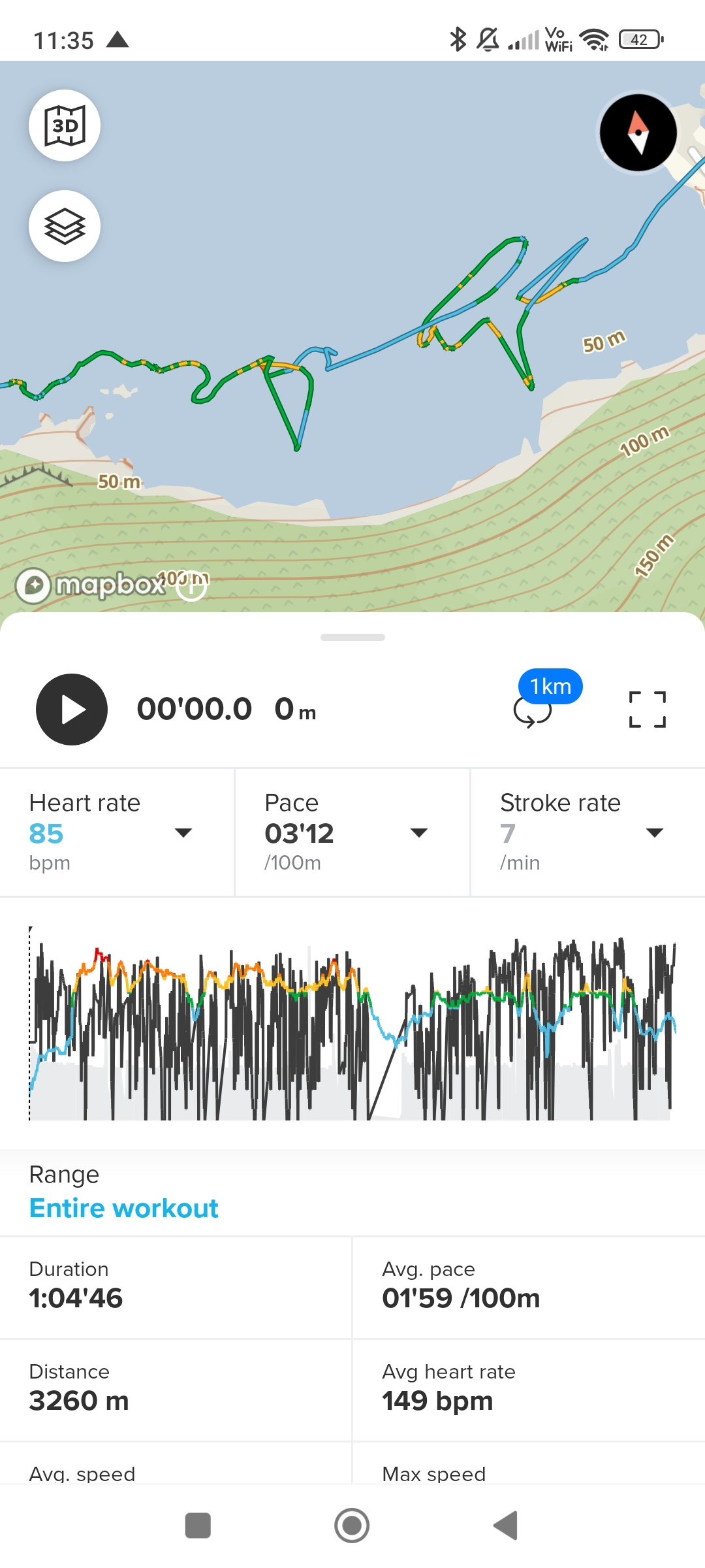

                          @gerasimos I totally get it that it is my fault that the watch could not receive a clean GPS signal and there was an interference from water. However, my point was that instead of telling me that there is abnormal data it should silently buffer until it can get a higher quality data. It is always better to skip some unreliable data than to record a bad data. It was obvious that my position jumped 500 meters in a second, which is not humanly impossible. Why did it record that?
                          Showing me a notification and asking me to respond while I am swimming is a really poor user experience. I couldn’t possibly read that while swimming and didn’t know how to respond so I just waited until the message went away.
                          That reminds me of a fiasco I had with Suunto 9 Baro several years ago during a nigh race. As a result of my experience, shortly after that I switched to Garmin. During the race it lost good GPS satellite reception so it popped a notification asking me what do to - I guess whether I was going to pause and wait for the signal or continue, but I couldn’t read that because of that happening during a night and the text being small and my eyes not being so good with night vision anymore. The text looked blurry to me and I could not read it, so I didn’t know how to respond and was afraid to press a wrong button and stop recording. Second, because I was running hard with less than two miles remaining to the finish, I didn’t really want to stop and figure out what to do with the watch. It was terrible because the pop-up was obstructing all the data and not going away for like 10 minutes.
                          The point is, these watches should do the most reasonable thing without asking. A user may be racing or riding a bike on a challenging terrain, and not able to stop and respond.

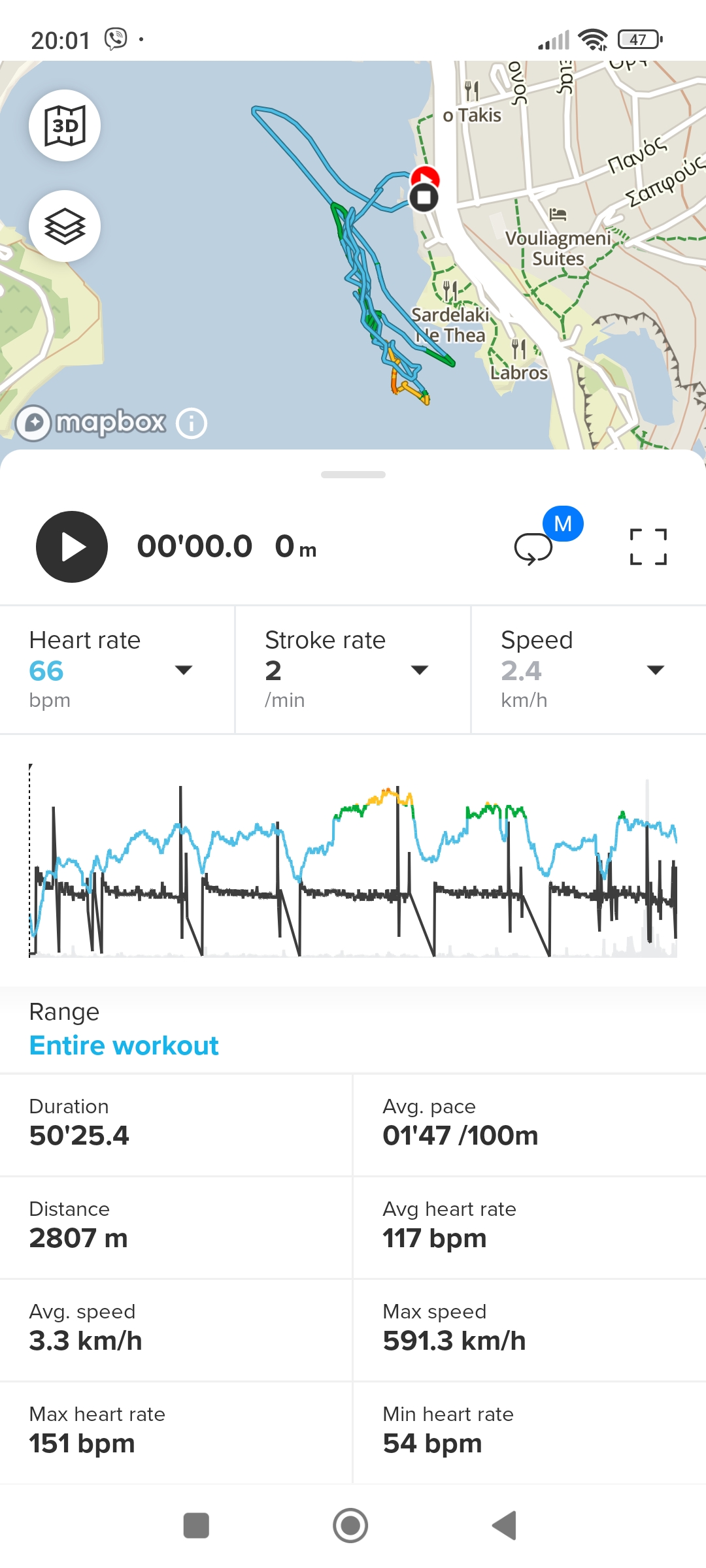

                            gerasimos Bronze Member @sky-runner

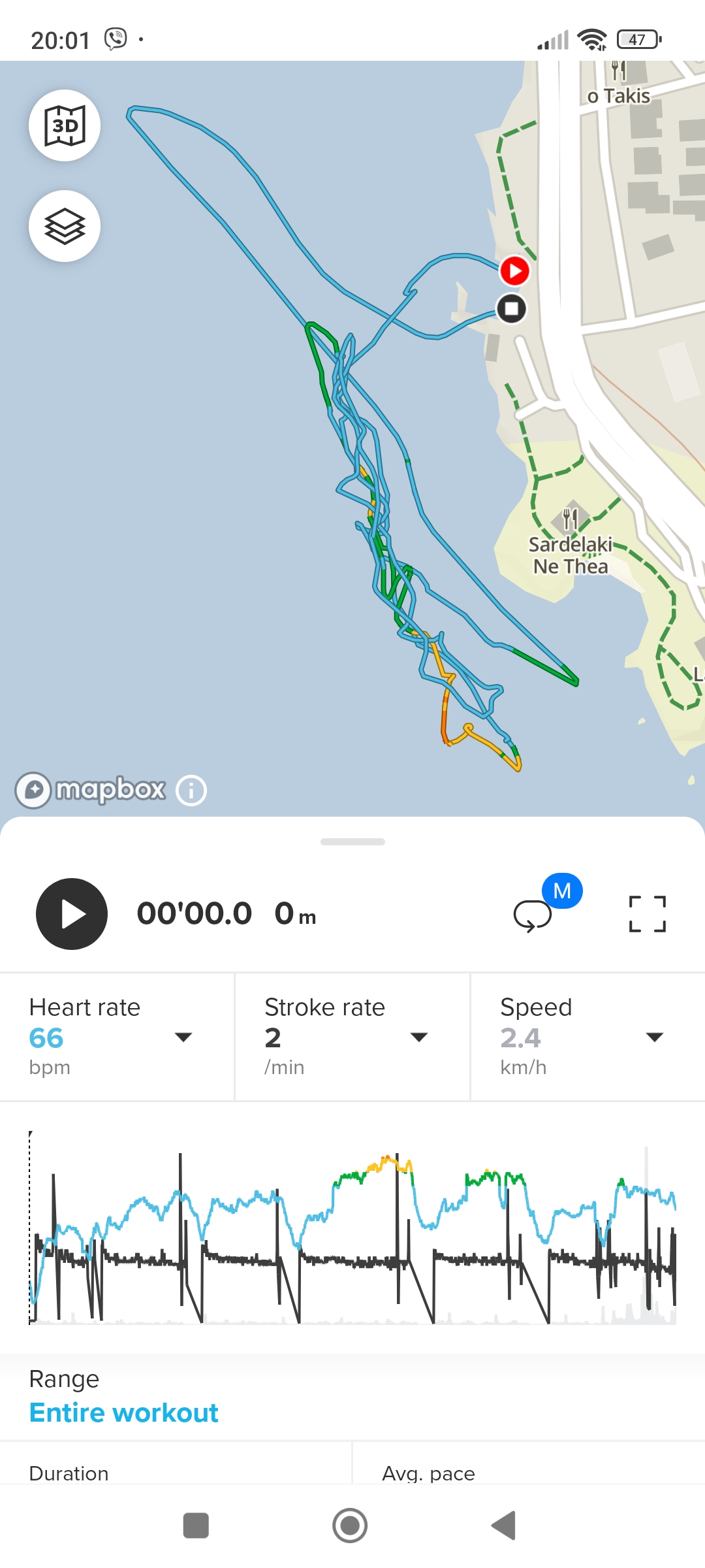

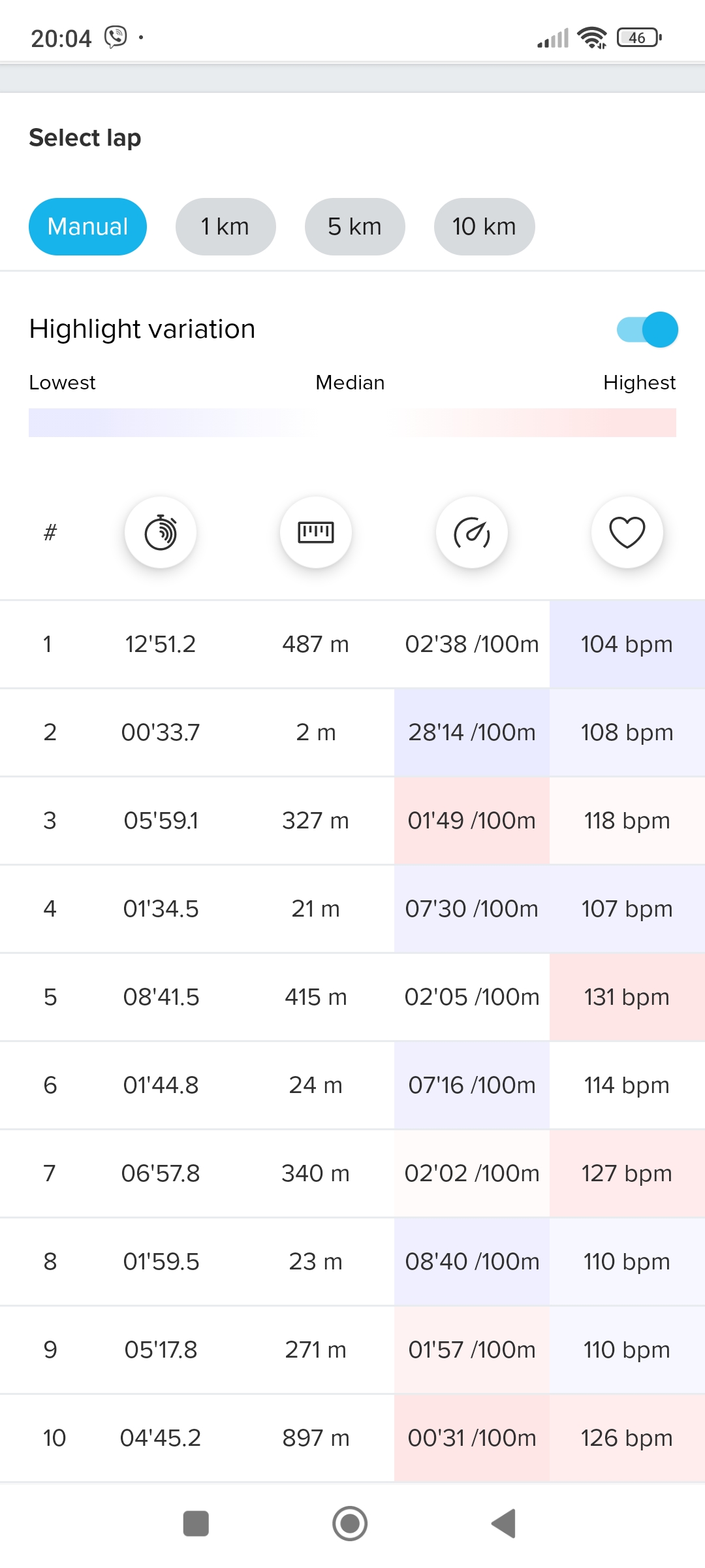

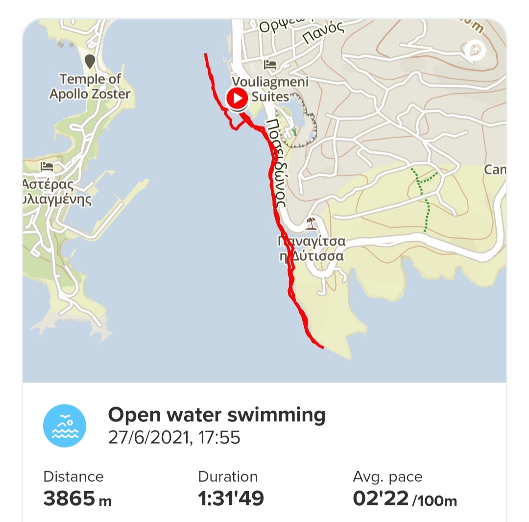

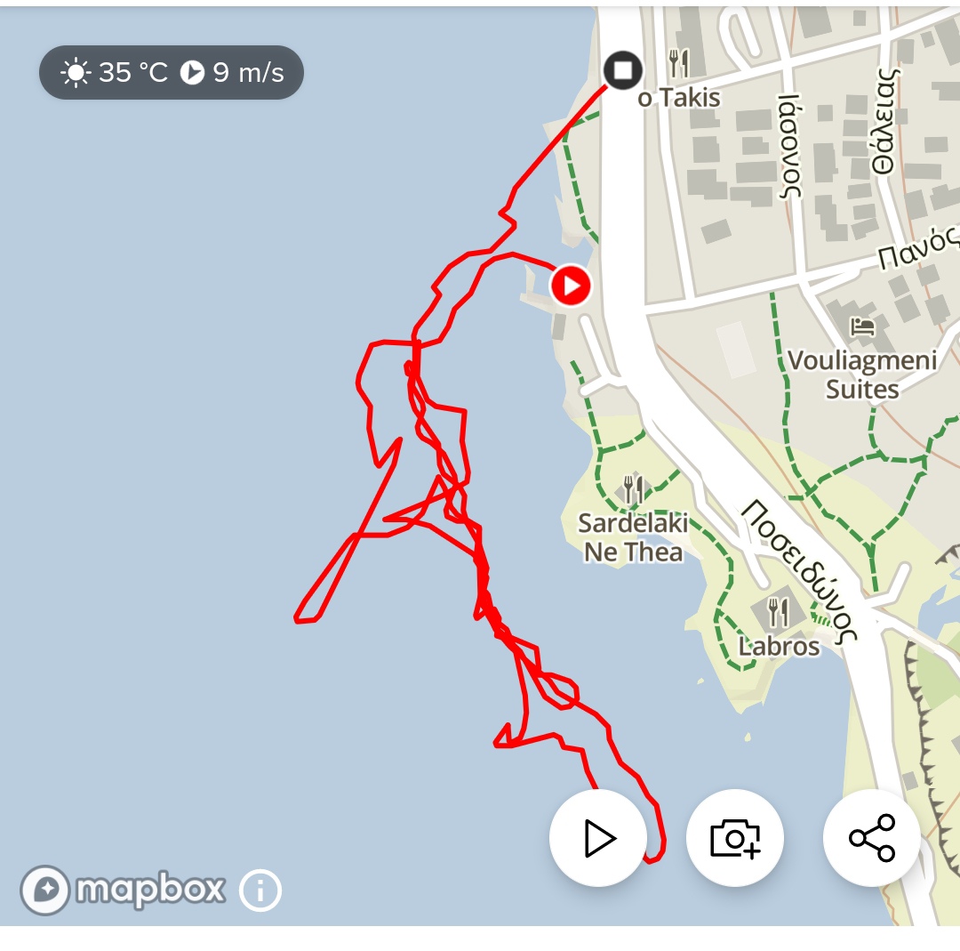

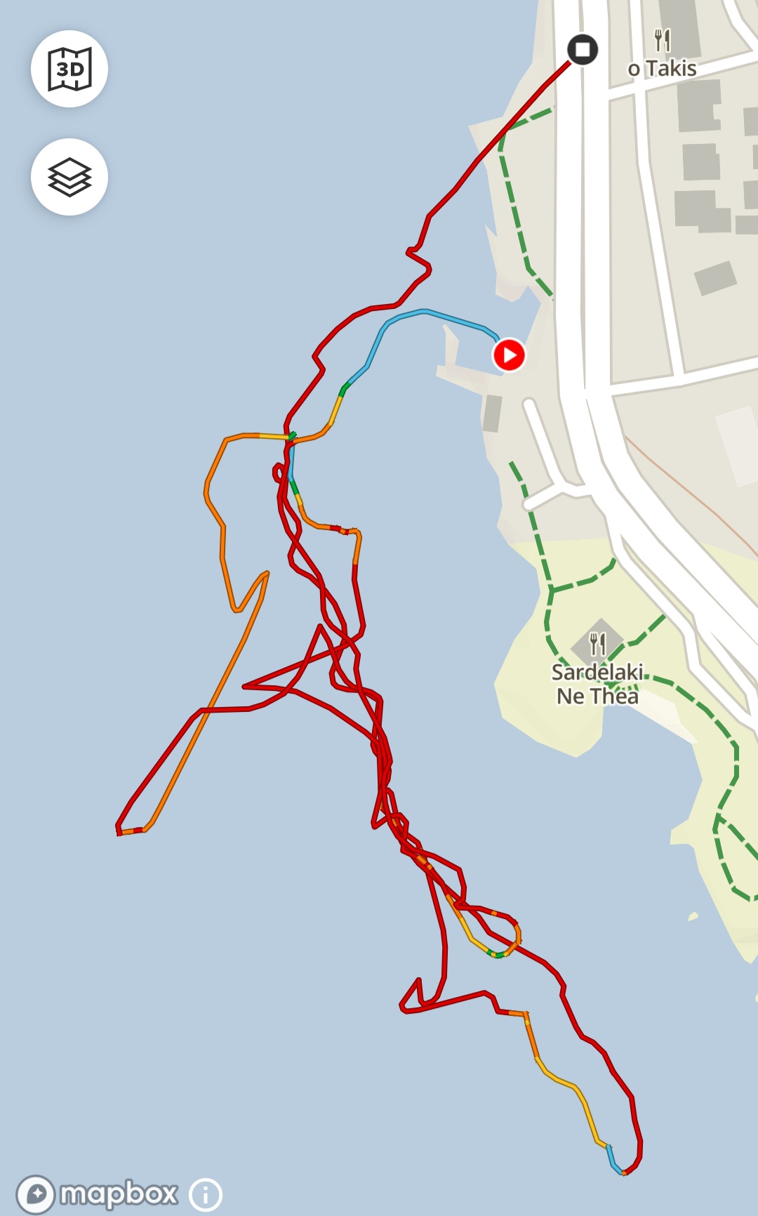

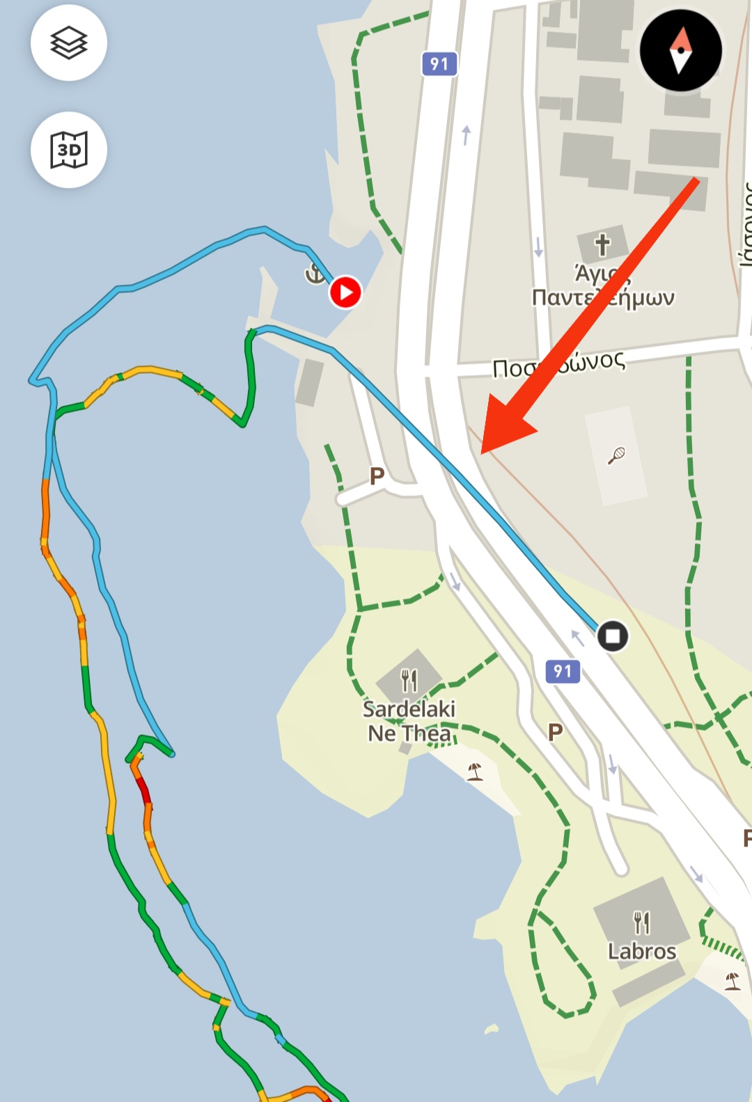

                            @sky-runner Yeah, I get that GPS jump too, quite a few times actually, and it usually happens right at the end of the activity when I get out of the water and stop the watch.
                            Like in this example my last swim— I stopped it exactly where I started, but it added around 300m going up in the road… Super annoying when that happens, especially in a race. At this point showed me hitting max speed 374 km/h — I’m a swimming hovercraft dragster😄
                            Suunto Vertical Ti
                            Suunto S9 gen1
                            Suunto Ambit3 peak

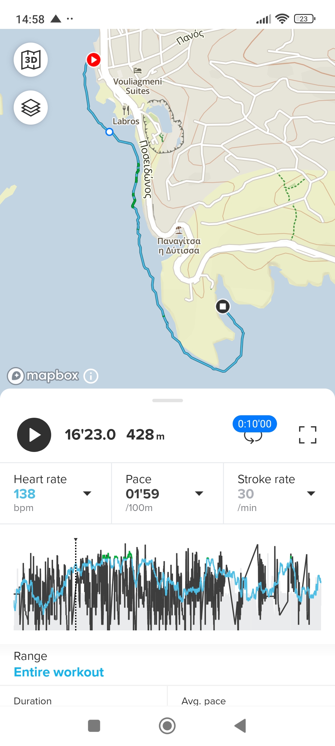

                              Improvements and bug fixes:
                              -Improved swim style detection in pool swimming
                              -Improved accuracy with updated GNSS firmware
                              “Has anyone noticed any difference or improvement after the latest 2.44.46 update in open water swimming?”

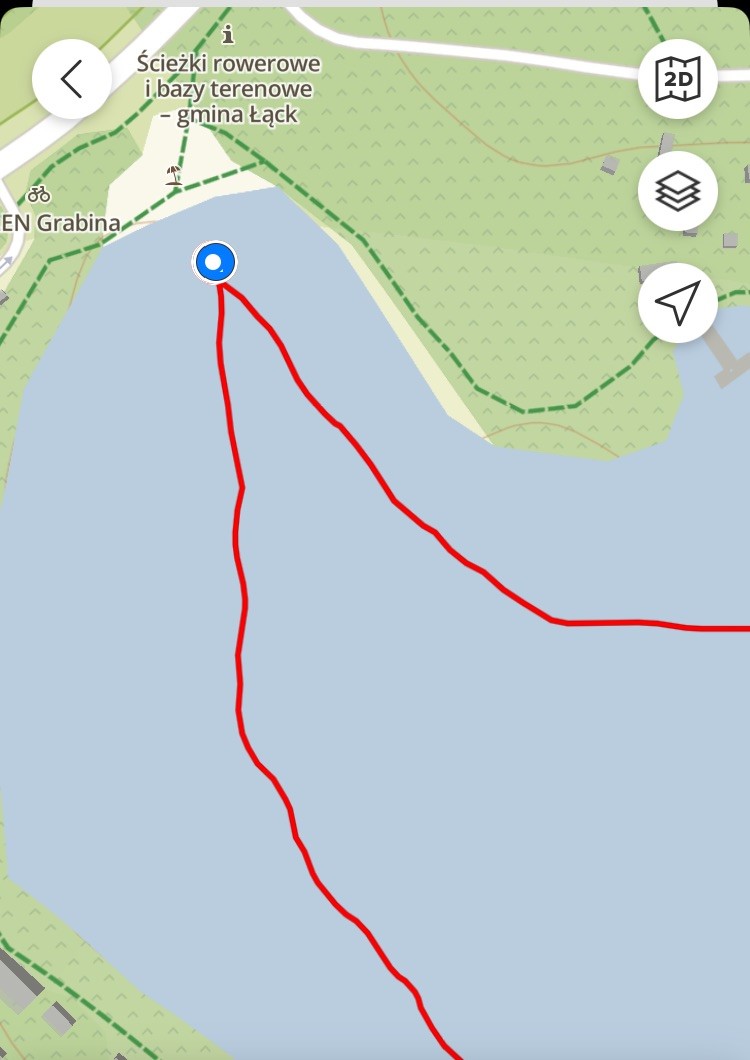

                                          It seems that after updating the firmware (2.40.56), Ocean has the same problem with swimming.
