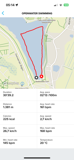

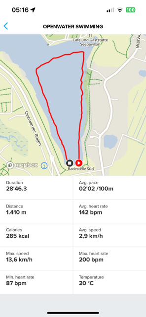

        @racesuser Sure.
        Just last Sunday.
        My friend and me at the same event. Both with Race S (she: steel, me: TI version):

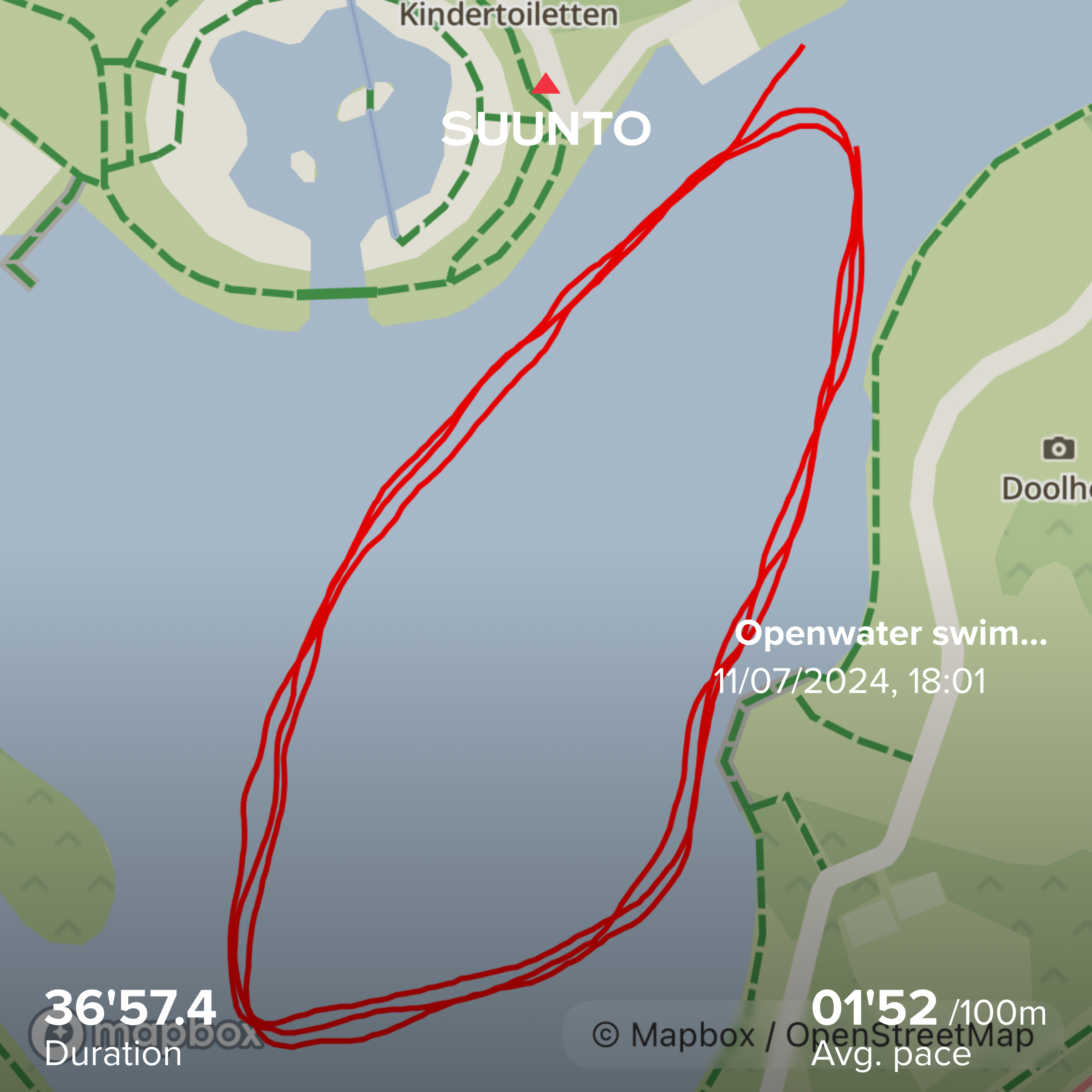

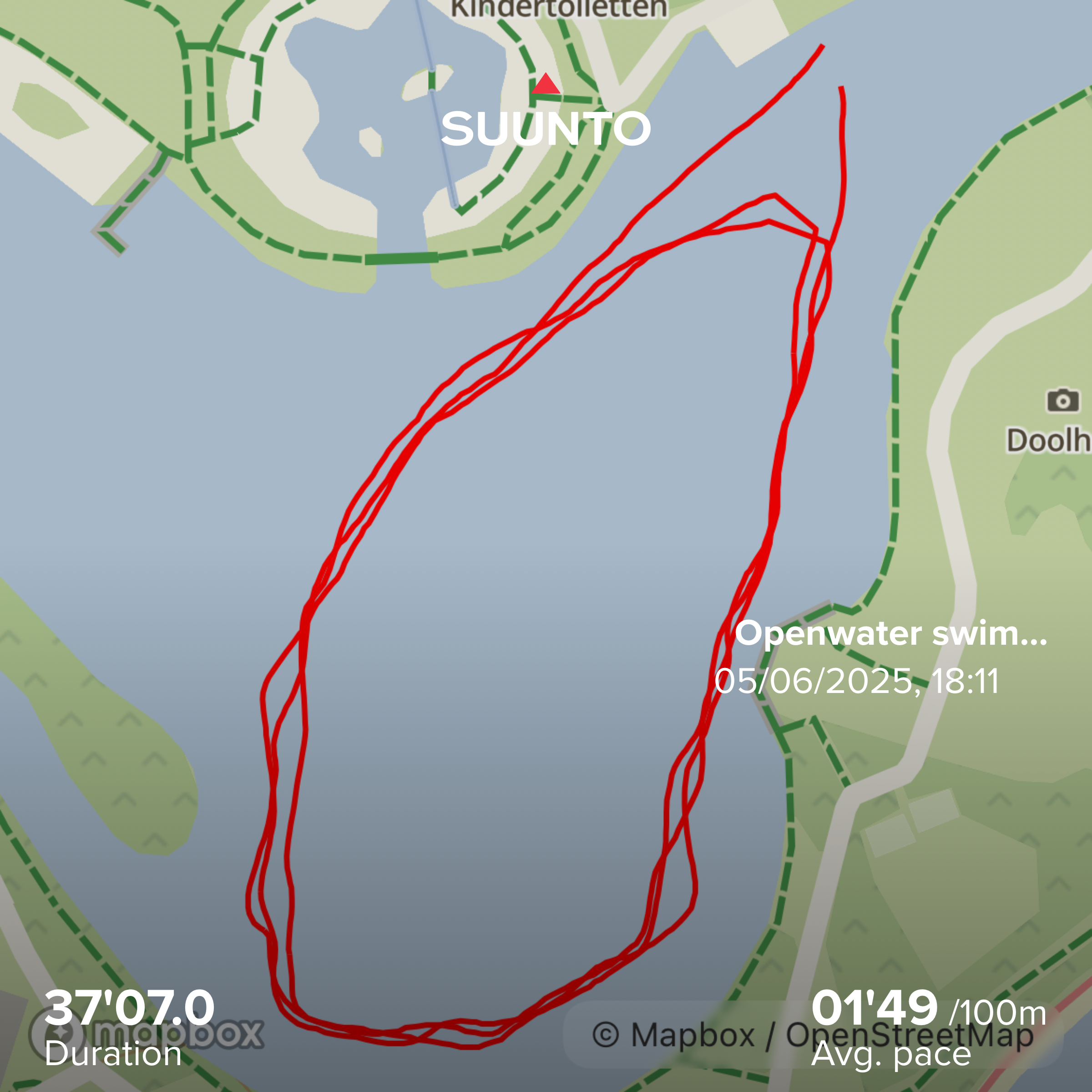

          @racesuser my measurements are pretty successful too… See below 2 swims, one year apart, first with the vertical, second withy Race S. Difference is marginal…
