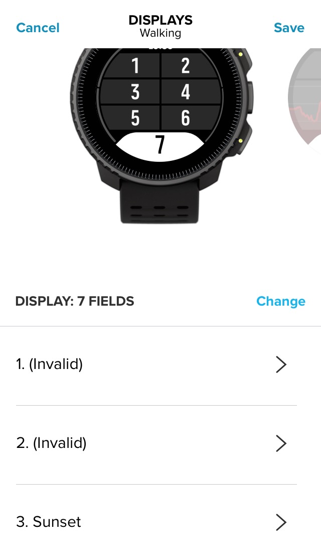

      @herlas said in Software Update 2.43.8/.12 (2025 Q2):
      @Stefano-M64 also baseline and cumulative values shouldn’t be displayed at all, they’re going to hide those again, that’s a bug 🙂
      OK perfect, thanks everybody!
