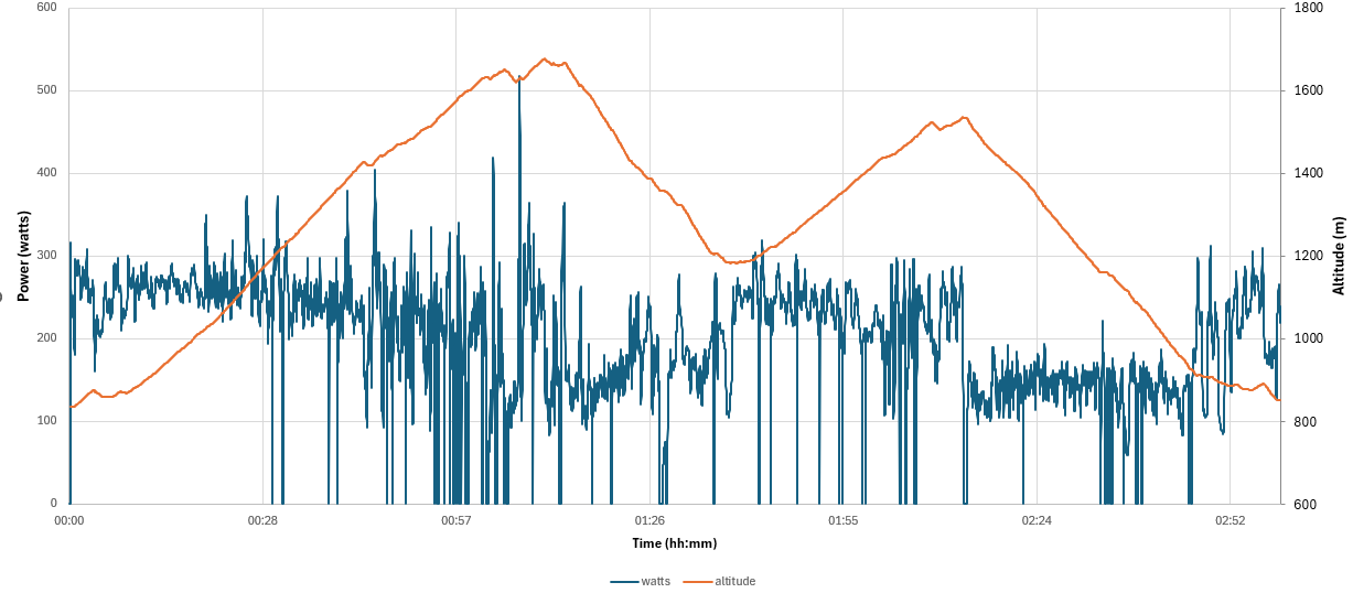

                            • srykeS Offline
                              sryke @atoponce
                              @atoponce said in Software Update 2.43.8/.12 (2025 Q2):
                              I just ran with 2.40.44 and didn’t see any power drops on the display. I was getting it with 2.43.8 however. But 2.40.44 worked for me.
                              FYI - today, 2.40.44
                              VoiGASV GiPFELKiNDG 2 Replies Last reply Reply Quote 0

                                @sryke Wow, all those drops were failures? You didn’t stop during the run? If yes, then power is not usable with this bug.
                                In my case I see drops on the watch, but not in the app - strange. But I don’t trust the values after having the drops on the watch and reading experiences like yours…

                                    @VoiGAS
                                    Most drops are failures, I did compare it to the Stryd fit file data.
                                    @GiPFELKiND
                                    And you’re certain that this is really the Stryd pod power stream? Everytime I do not see any drops in the data is when I get an overall different wattage in the Suunto and Stryd files. My assumption is that the Race S sometimes does not read the stream from Stryd but uses its own wrist estimated power. Despite having a connection with the pod.
                                    GiPFELKiNDG R 2 Replies Last reply Reply Quote 0

                                        runsgrun @sryke
                                        @sryke said in Software Update 2.43.8/.12 (2025 Q2):
                                        @VoiGAS
                                        @GiPFELKiND
                                        @sryke this makes me curious about the comparing the power algorithm between Suunto and Stryd. I might do a test run without connecting both and see how they differ.
