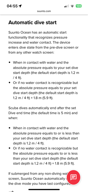

        @dalbertlebrun not strange at all.
        It is all described in the manual: https://www.suunto.com/Support/Product-support/suunto_ocean/suunto_ocean/scuba-diving/dive-setup/

          Thank you @Egika that must be it. If that is by design then I would ask for an enhancement request.
          I can understand having an automatic dive depth start, but it would be nice to be able to turn off that automatic setting. Especially when you aren’t in the scuba diving activity.
          I don’t want to go into scuba diving mode every time I jump into a pool. It throws off the surface time stats.

            @dalbertlebrun This works as intended, but I agree it is a bit silly for most users. On this forum it has been suggested previously that the user could choose what happens in water:
            1. nothing
            2. autostart in pre-selected water activity mode (scube, freedive, snorkeling, open-water swimming etc.)
            3. autostart in last used water activity
