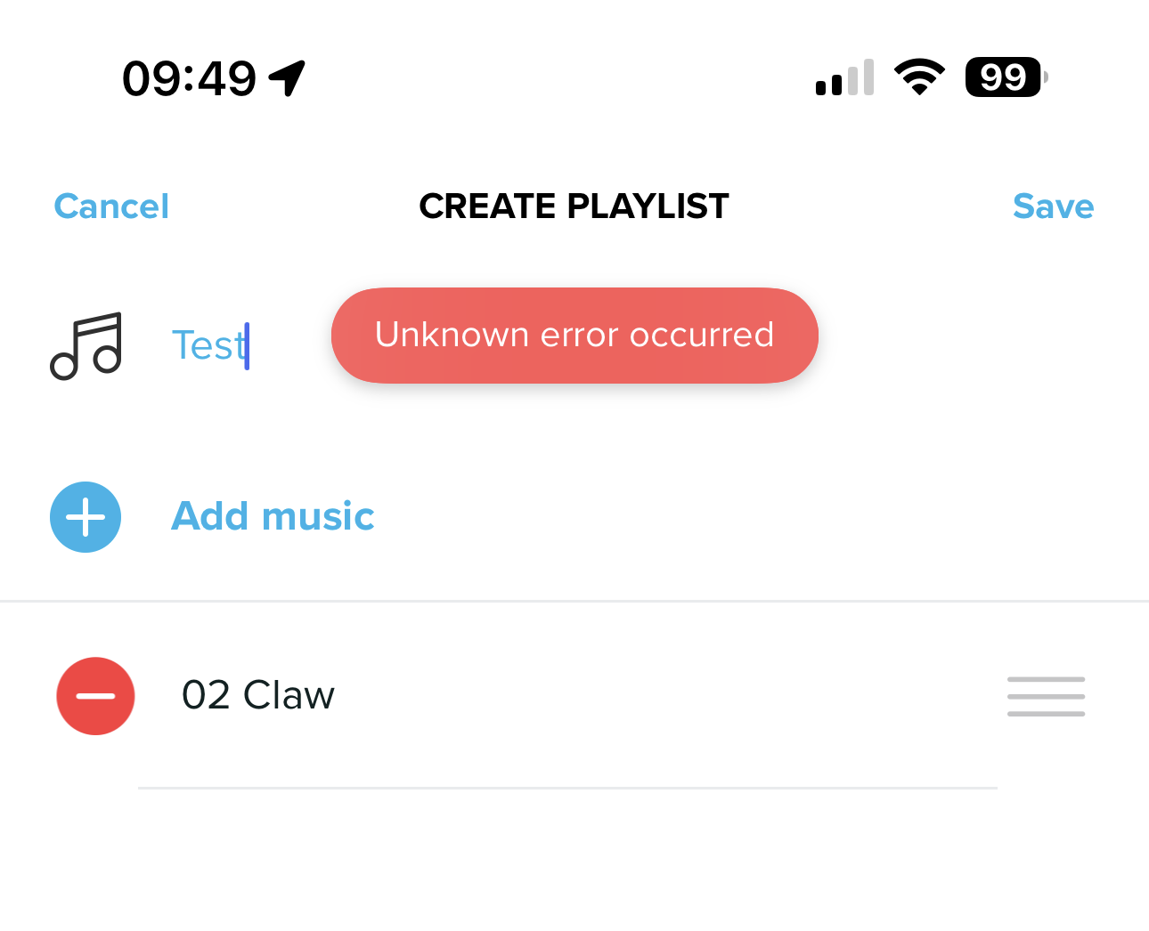

                I’ve had a bunch of issues with music management on my Run watch. Initially it seemed ok with the first batch of mp3s, but then when adding more it started to see that the watch interface wouldn’t show newly copied files and they also were not showing in the app when I tried to create a playlist, only the original batch were showing even though the new files were definitely there in the Music folder.
                I decided to start from fresh again and deleting everything from teh Music folder. Then all 50 files showed up on the watch “Library/All Songs” menu, and in the Suunto iOS app. The actual folder was empty though so the files didn’t exist on the watch and were therefore not playable… 🙃
                Then when I added a few mp3s again, it sorted itself out and they showed up on the watch and in the Suunto app, with the others that had been deleted now gone.
                It all seems really inconsistent though, and at times newly copied songs would only show up when I paired my Airpods to the watch. And I also sometimes get “unknown error occured” when trying to create new playlists, but eventually it works. I can’t consitently reproduce it but it happens a lot.
                Hopefully this will all be improved with updates soon, as right now it’s a pretty bad ux.

                    Just added some new tracks and confirmed that after copying the mp3 files via windows explorer and disconnecting the watch, they don’t show up on the watch interface or iOS app until I connect my Airpods to the watch. Then when I try to create a playlist in the iOS app, I get the “unknown error occured”, until I disconnect my Airpods, then playlist creation works! 😅

                          Right, so “unknown error occured” appears to happen if the media player menu/app is open on the watch. Go back to home screen and playlists can be created/edited. That appears to solve that part.
