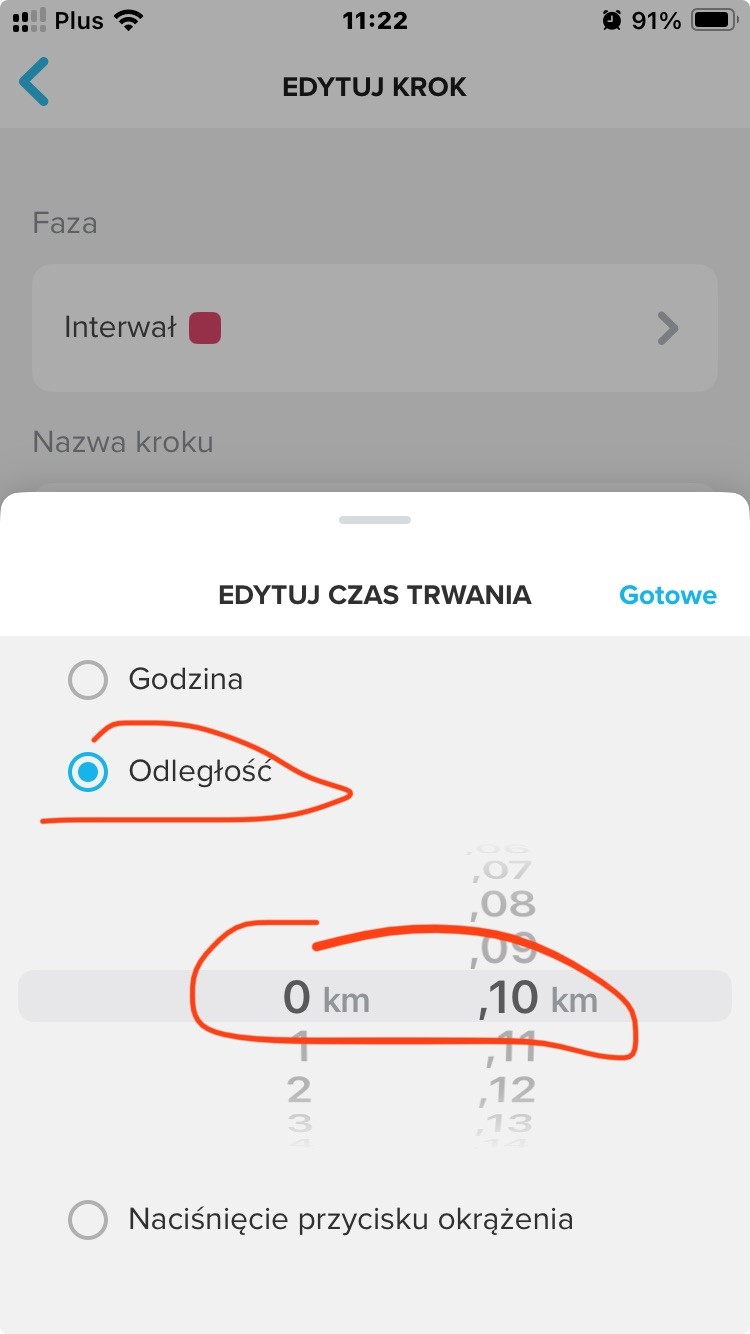

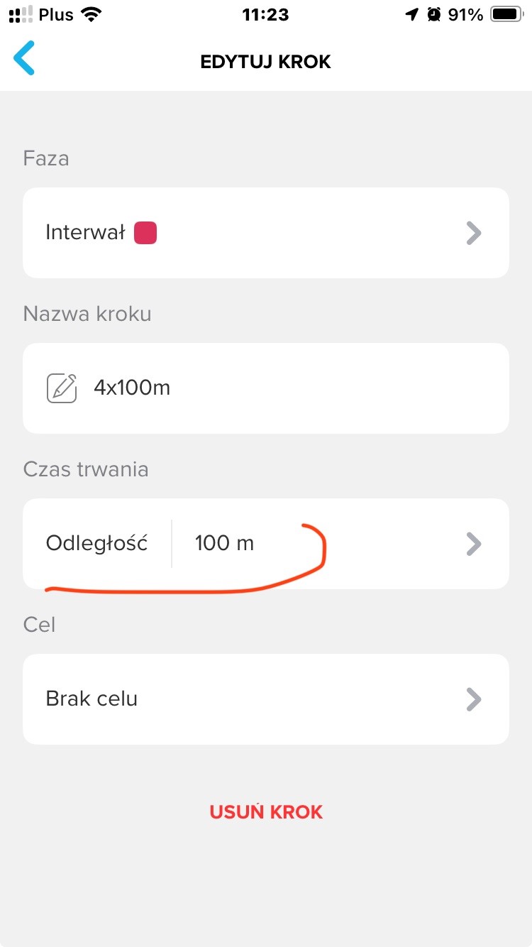

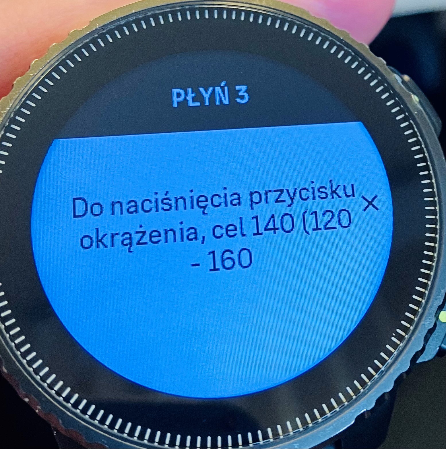

            Yes, use “non specific sport activity” and everything will be ok.
            You can set automatic distance of 100m or initiate end of 100m with button.
            Pause time can also be selected automatically or set interesting time (for example: 1 min)
            Example attached.

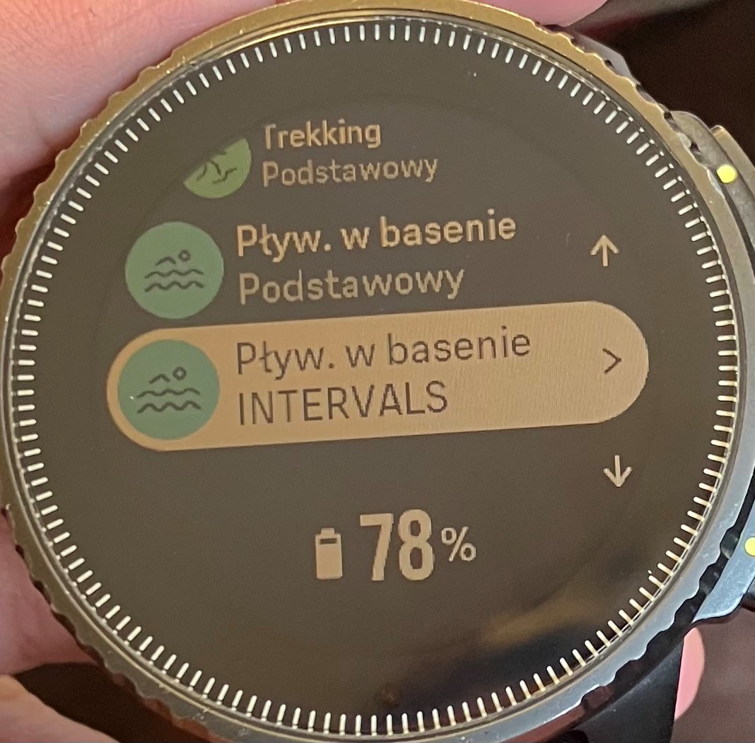

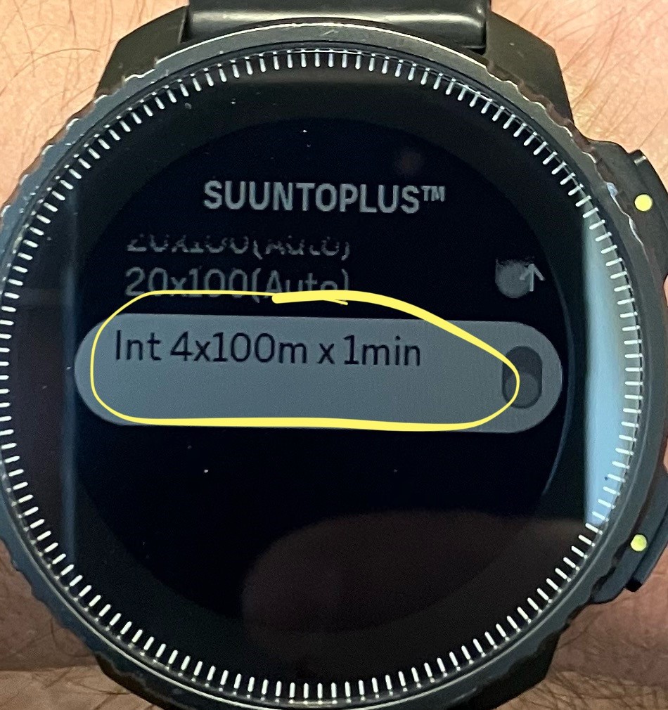

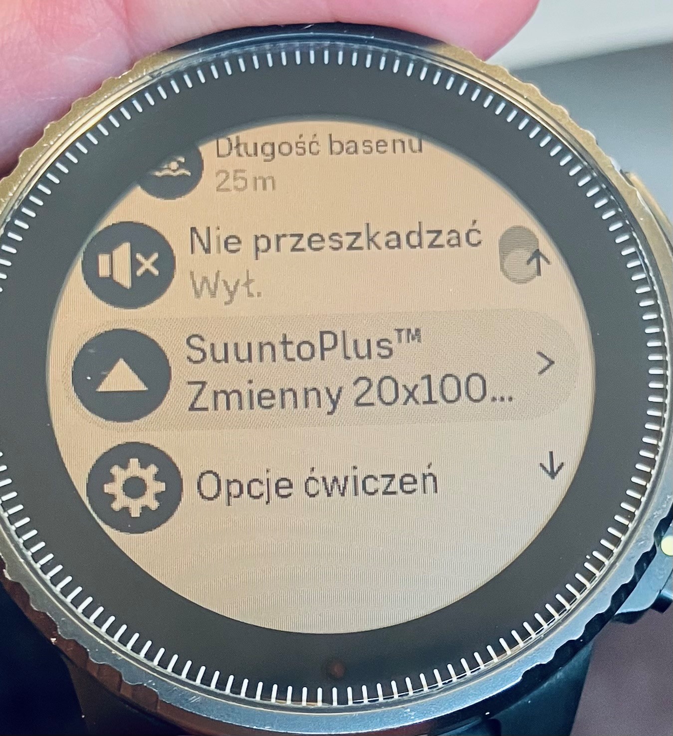

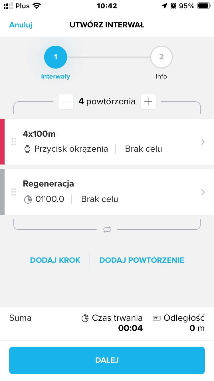

                I’ve been using intervals in swimming for years and it works great.
                You set the pool length in the “pool swimming” activity.
                Intervals is in SuuntoPlus and it’s an add-on to the main activity.
                1. Create an interval workout.
                2. Sync the watch with the app.
                3. Select the “Pool swimming” activity.
                4. Add the interval workout to the “Pool swimming” activity.
                5. Start swimming. Scroll through the screens if necessary.
                The watch doesn’t use GPS, only accelerometers to detect pool length and swimming styles.
                You can use intervals manually or automatically.

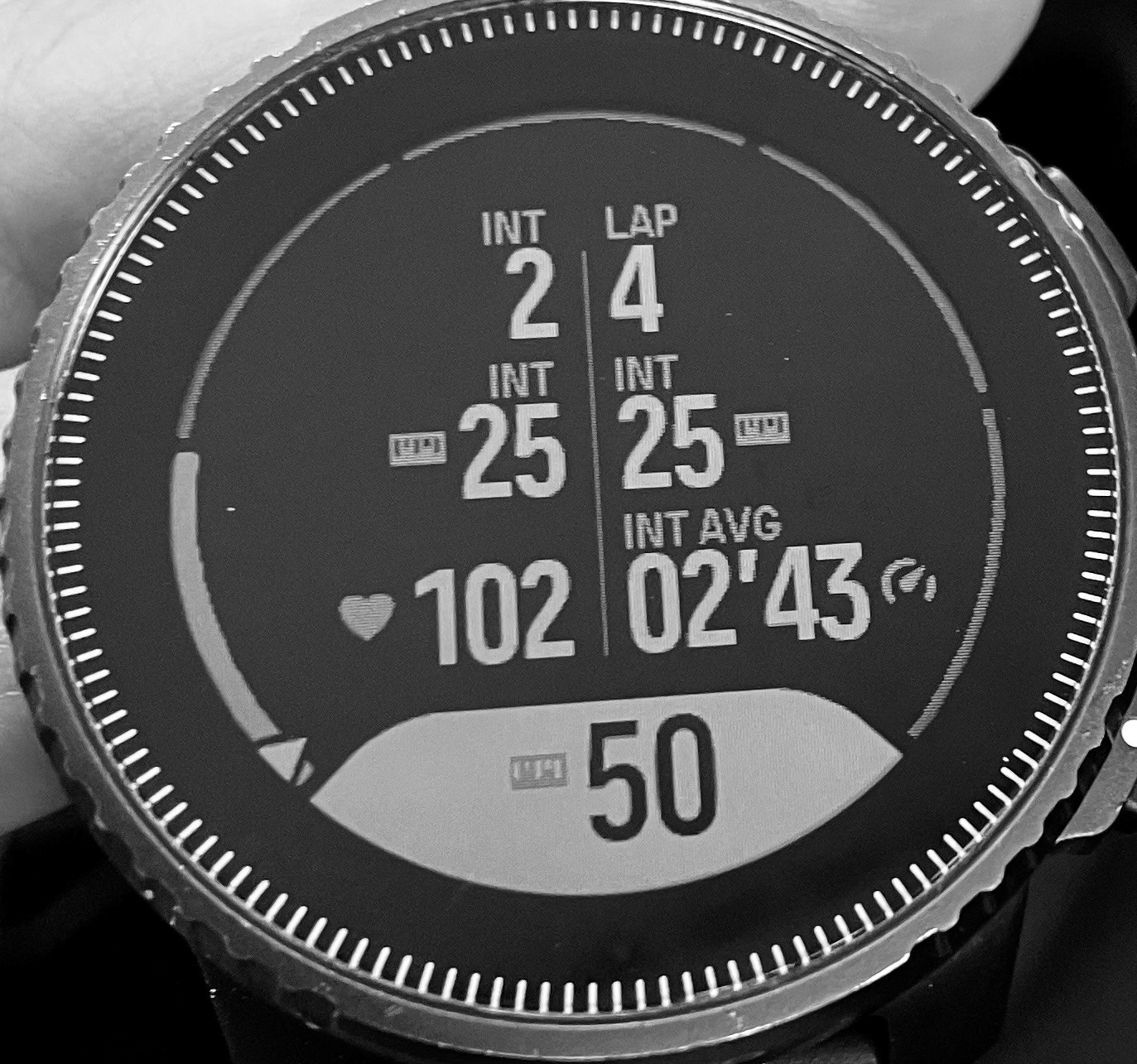

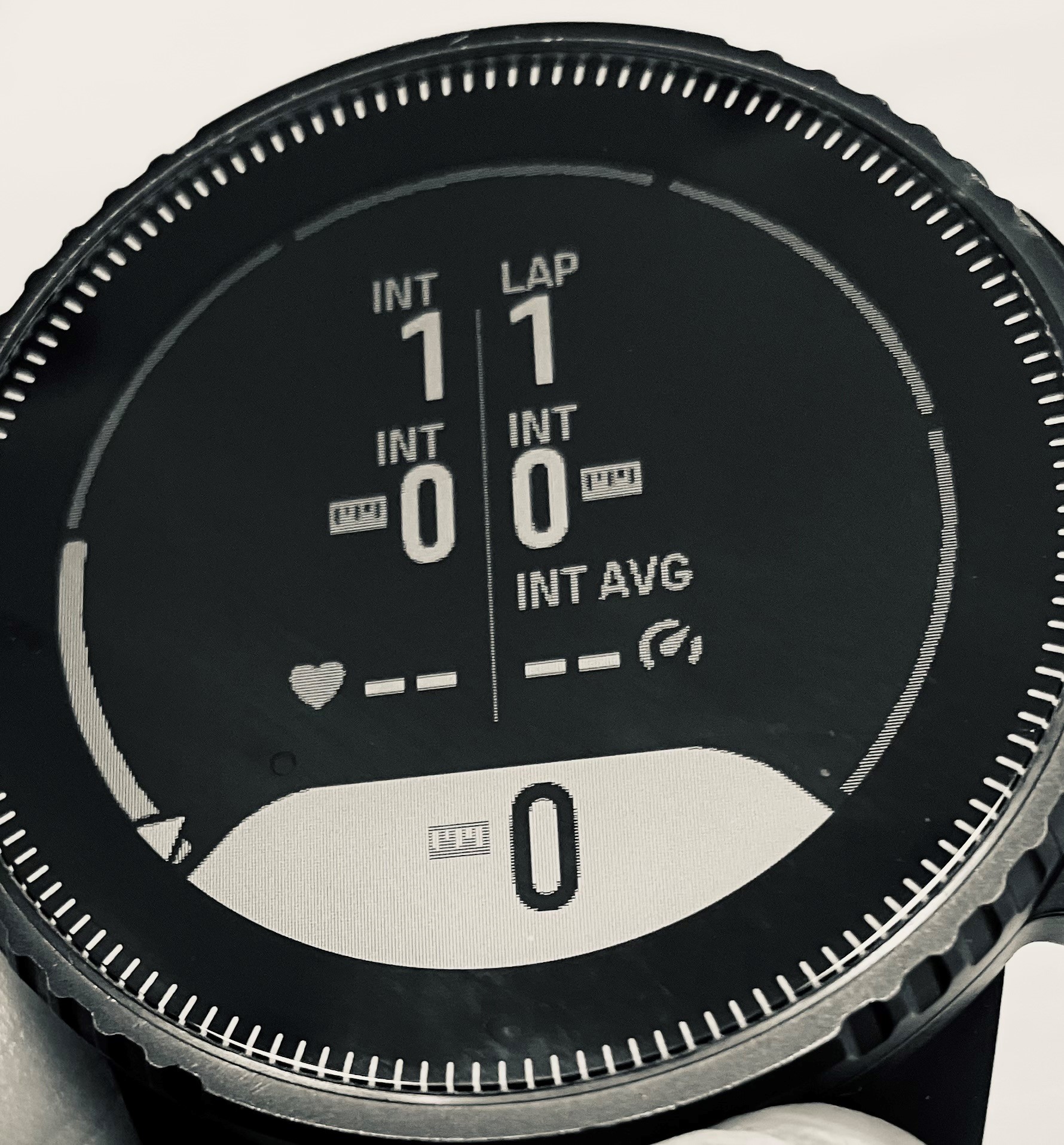

                Sample Interval Screen:
                You can create your own interval screens according to your needs.
                Additional screens:
