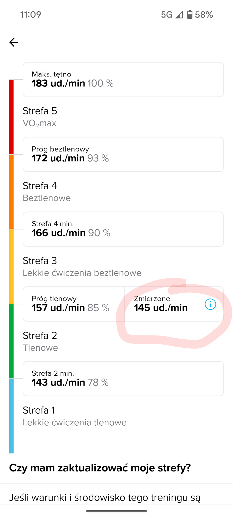

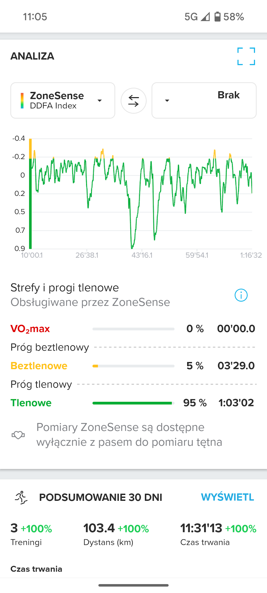

      Hi!
      Here are some quick thoughts on Suunto’s ZoneSense technology with the Vertical Titanium Solar watch – I’ve been testing it for a week.
      In theory, ZoneSense is supposed to check aerobic, anaerobic, and VO2Max zones in real time WITHOUT KNOWING the runner’s heart rate zones based on HRV measurement, i.e., very accurately. Any heart rate monitor is required (I use Polar H10).
      And if the runner has no idea about zones, which in THEORY allows them to train according to their goals - aerobic, endurance, anaerobic.
      In my case, where I know my zones:
      Z1 to 143
      Z2 to 157
      Z3 to 165
      Z4 to 172
      Z5 to 186
      After training, Suunto CORRECTLY indicated the Z1 aerobic zone at 145 beats (I did the tests in March, so they may have changed a bit since then, but I’ve also done an Ultra, so Z1 may have increased and the LT threshold in Z2/Z3 may have decreased by 2 points).

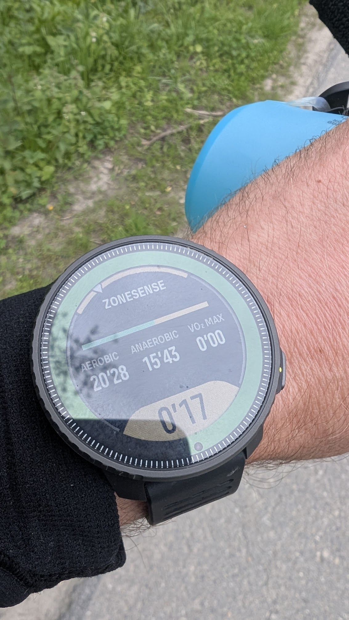

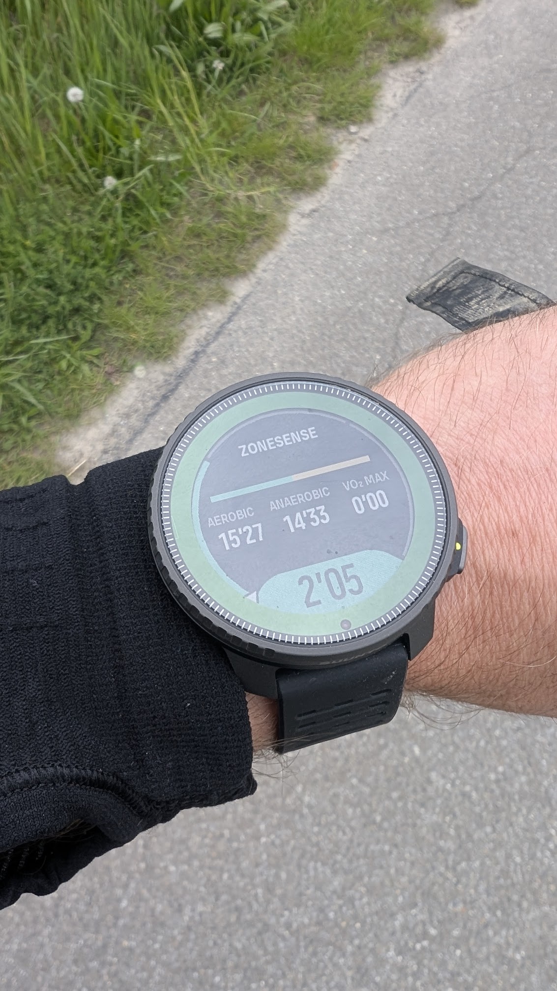

      • doing intervals: today, at 10x100m, it only showed that I had entered the anaerobic zone on the third interval

        @Adrian.S ZoneSense detects LT1 and LT2 for that specific time and your conditions you are in. They will change through the day, even within a workout.
        The 145 is LT1, that is the upper limit of Z2 in the classic model. Maybe it wasn’t the best day.
        I had this threshold detected as low as 139 and as high as 162 and my workout at that time felt similar to this.
        The idea behind it is to forget about the zones and concentrate on aerobic, anaerobic and VO2max.
        Regarding your intervals - 100m is too short for ZoneSense to be effectively used. It needs about 2 minutes to correspond to your conditions.
        With the top button you can cycle through 4 different screens of ZoneSense. One of them gives you HR and Pace, what I often use…
