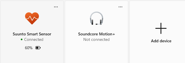

          you can try to connect the belt to a device that shows the battery level of other connected Bluetooth devices (headphones …), for example a PC
          in my case the connection last for just few seconds, then the Suunto Smart Sensor disconnects, however it’s enough to check the battery level.
