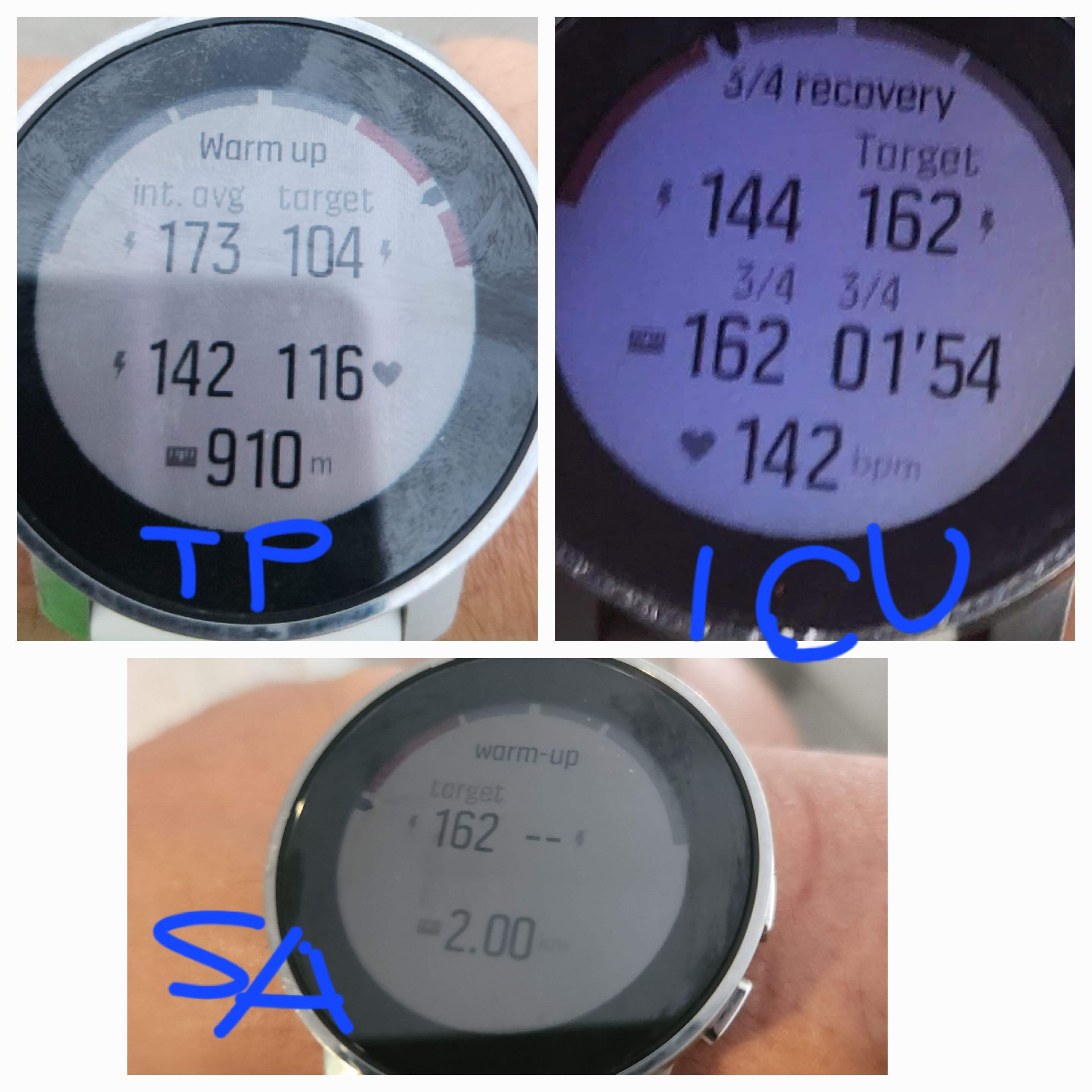

            • herlasH Online
              herlas Silver Members
              It’d be great to be able to customize structured workout screens, having said that, in my opinion TP has the best layout of out them all.
              Highlight, it shows Int. Avg vs target at the top and my favorite remaining distancie or time in current step at the bottom, where you can easily spot while surviving the workout 😉
