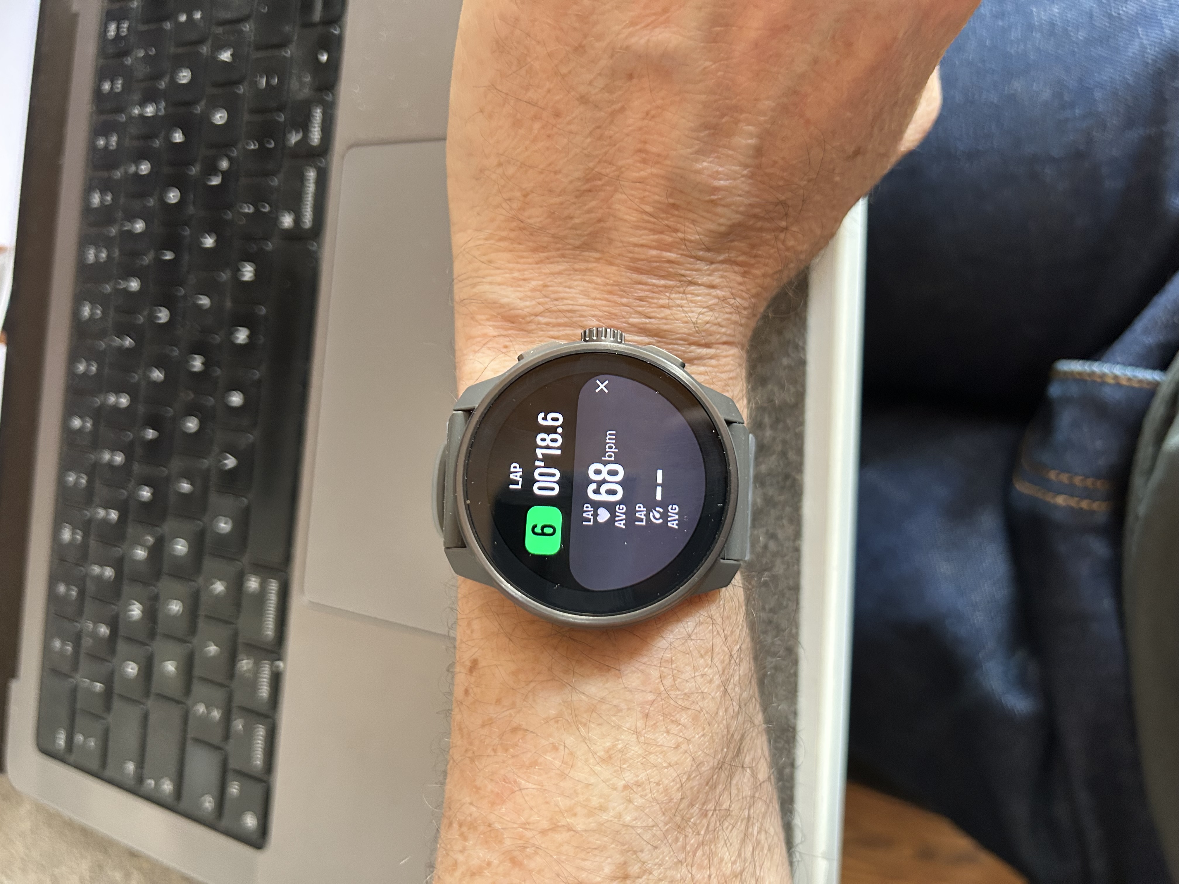

      Hi there, I would like to have an activity for tracking a HYROX race but unfortunately I struggling to get this working.
      I used the App to create a new Sportmode with a very simple screen with 4 data fields:
      1. Currect Lap Number
      2. Current Lap time
      3. Heartrate
      4. My overall activity time
      So far so good, I can start the activity and if I press the lower Button I get a new Lap:

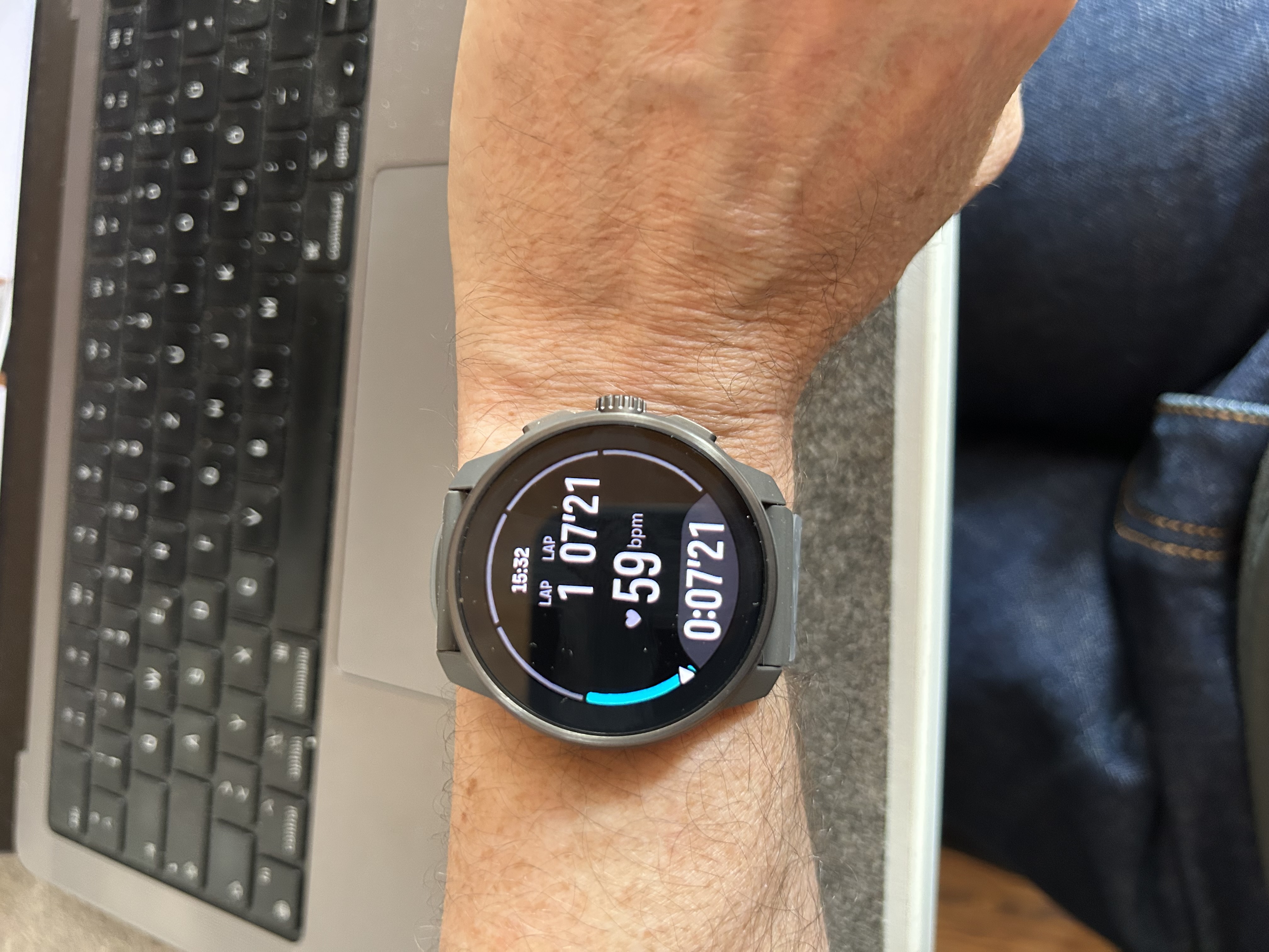

      But the Lab is NOT shown on the main screen:
      The main screen just shows Lap 1 and the total time as the Lap time … what I am doing wrong here?
