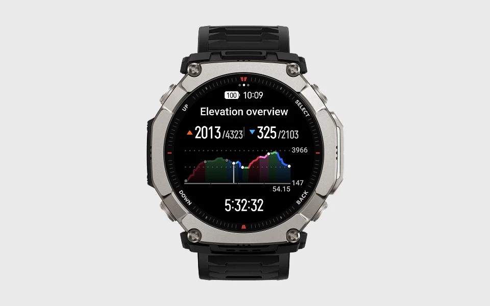

            I’m still learning about the Climb Guidance with my Race 2 but this is also also already implemented by Amazfit in their very new Climb screens:
            ![alt text](01adf467-4a8a-4fd5-b985-e2a241ffa406-1776091421416578332154588355410.jpg
            And this:
            https://forum.suunto.com/topic/15009/climb-guidance-improvement
            You can even configure the remaining ascent and descent between waypoints as datafields.
            I’d love to see those improvements in the Vertical 2/Race 2
