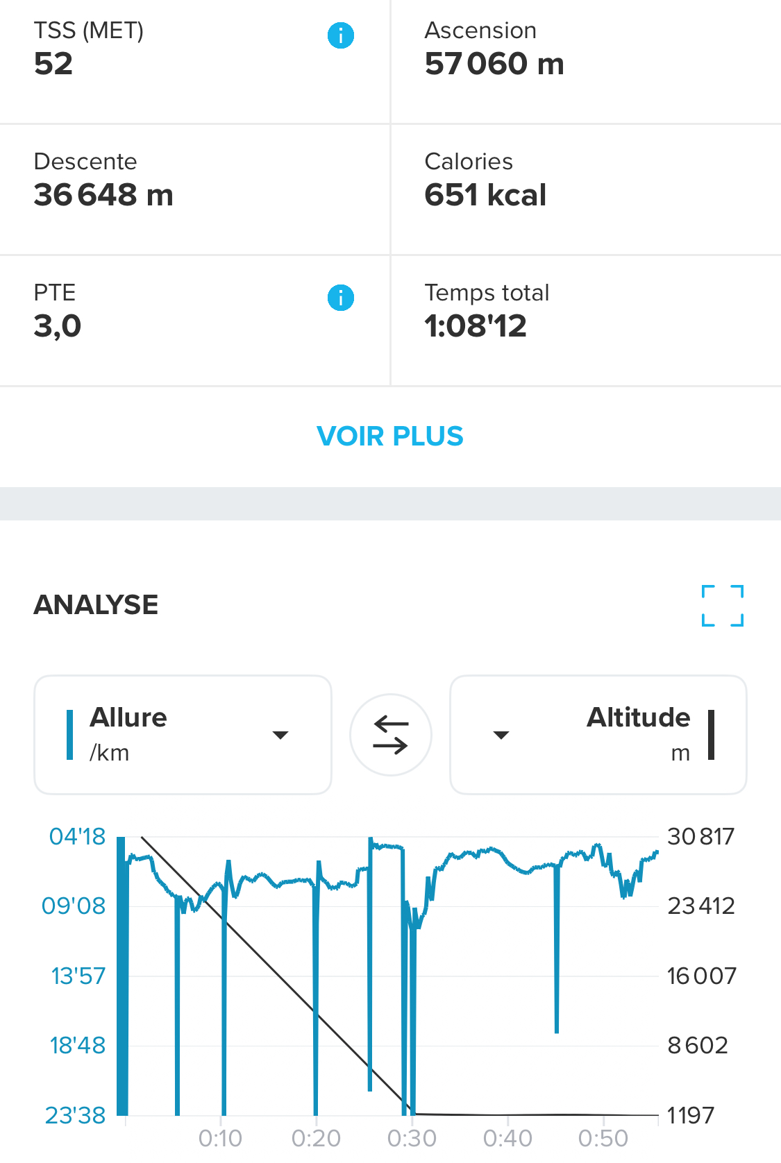

      @thanasis I have been using the A3P intensively and even if liked it a lot, it was far less reliable than my SV
      All my friends using the A3P have encountered barometric sensor failures after few years. Twice sensor replacement for me, uncountered altitude pbs. Wind and cold temperature especially make altimeter measurement totally wrong. Nothing compare to SV issue discussed here (even if I’ve never had the issue with my SV)
      Example of « wrong » altitude measurement from this week, with A3P of a friend :

        Hi thanks 🙏
        However this seems like a hardware failure right? I am not sure I am referring to the same issue
        What I am referring to is not a failure but a significant change ( in my case a sudden increase by 60-80-150m( of the altitude when there is air or maybe rain

          @thanasis right but I also had altitude problems in windy conditions with the A3p ; for me it was not handling good in cold and windy conditions, way worst than SV does with wind.
