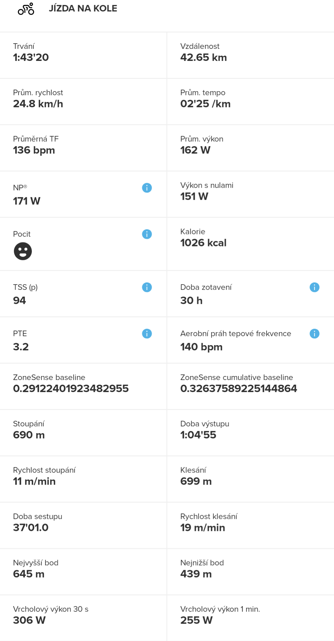

                                      • AudaxjoeA Offline
                                        Audaxjoe
                                        Strange readings on last bike ride! Zonesense baseline. It is this something new? I certainly can’t remember seeing it before.
                                        Suunto Vertical
                                        Suunto 9 BARO
                                        Garmin Fenix 3, 5
                                        Suunto Vector
                                        Jan SuchánekJ SquirrelS 2 Replies Last reply Reply Quote 0
                                        • Jan SuchánekJ Offline
                                          Jan Suchánek @Audaxjoe
                                          @Audaxjoe also got that yesterday on bike:
                                          • SquirrelS Offline
                                            Squirrel Bronze Member @Audaxjoe
                                            @Audaxjoe said in ZoneSense:
                                            Already mentioned in https://forum.suunto.com/post/169982
                                            It’s unintended and will be fixed in next app release.
