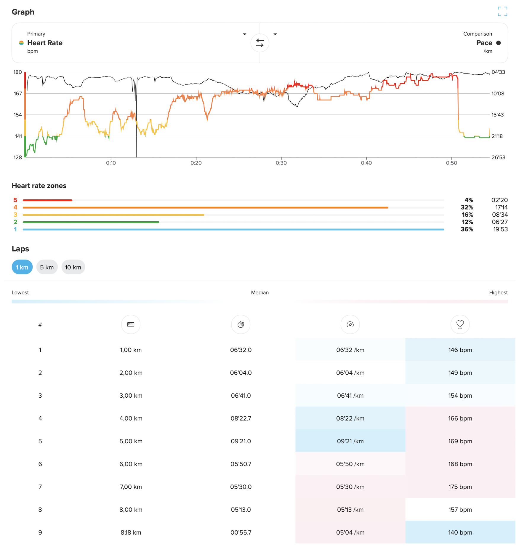

        Almost 2 years later and I see the same discrepancies. Might be a coincidence but I use the H10 as well. Suunto says I was in Zone 1 during 36% of the activity - I was constantly above, even when I started. The line chart (and the Laps section) seems to tell the true story here, despite some signal drop outs (was a hot day). In line with this Zone 1 haluzination, Suunto calculated an average heart rate of 127 which is absurd too given the line chart.
        Any idea where this is coming from and when it will be fixed? Screenshot 2026-07-27 at 23.13.17.png.

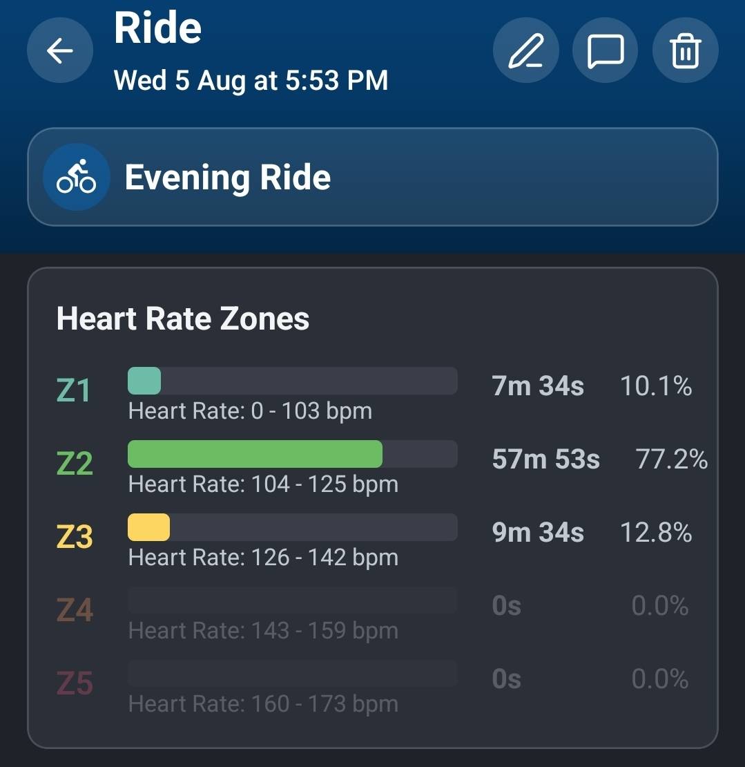

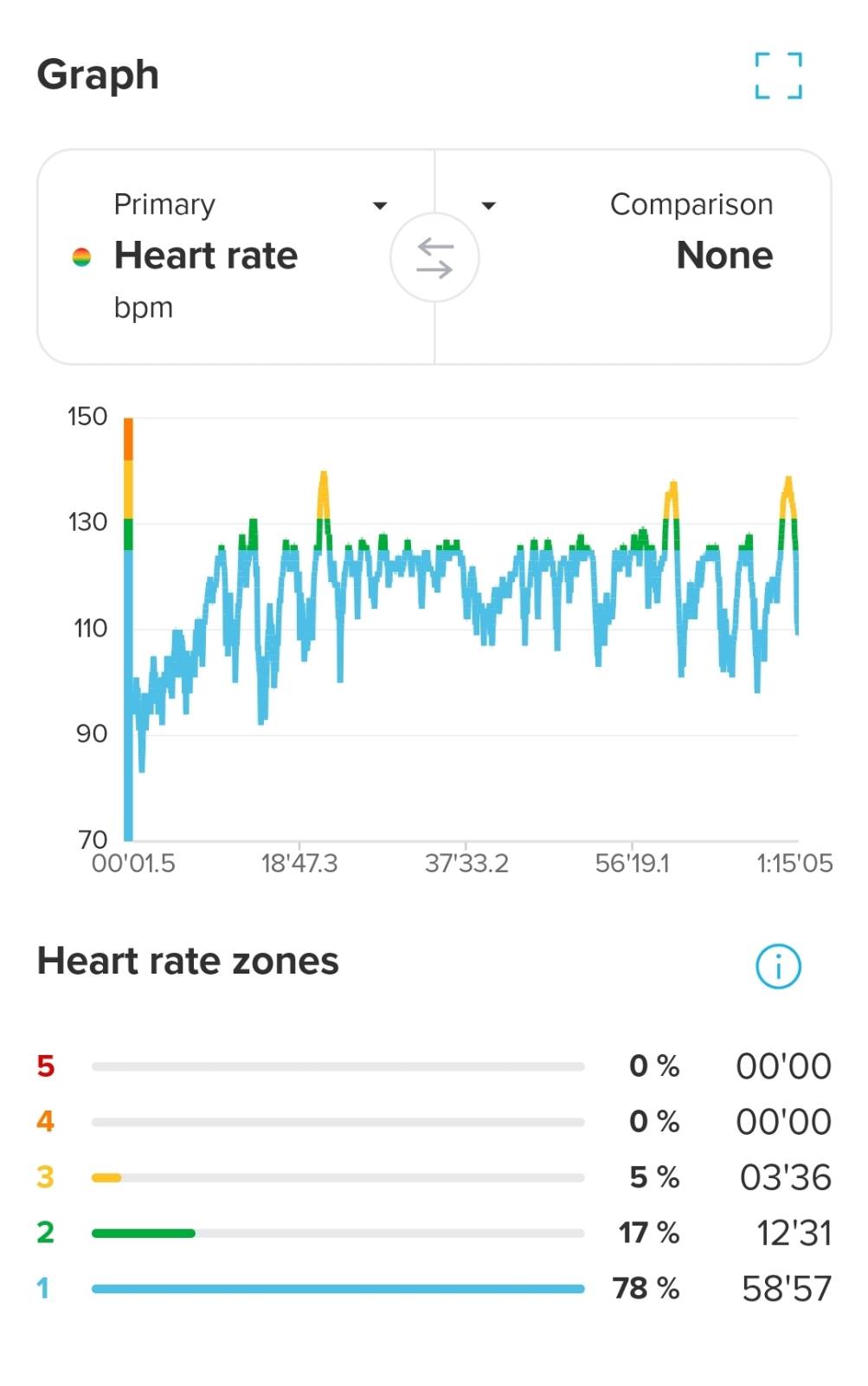

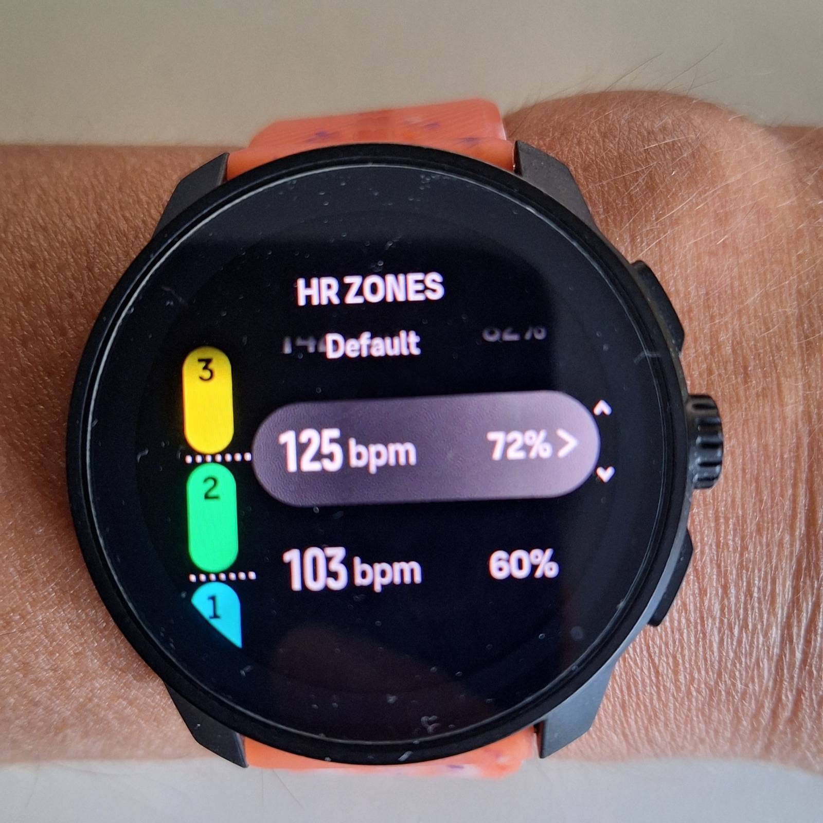

                    I’ve noticed that something seems to be wrong with the HR zone data as well. On my Suunto Race watch, I have Zone 2 set to 103–125 bpm. Yesterday I went for a bike ride and intentionally stayed in Zone 2. However, my Suunto watch shows that I spent most of the ride in Zone 1, which is incorrect. On the other hand, Intervals.icu correctly shows that I spent most of the time in Zone 2.
                    I’m using a Garmin HRM 200 chest strap to measure my heart rate, but I don’t think that’s the issue. From what I can see, the problem is that the heart rate zones in the Suunto app are incorrect.
                    As I mentioned, I set my HR zones directly on the watch. Do I need to configure them somewhere else as well? I’ve only had the watch for about a week, so I’m still getting familiar with all its features.

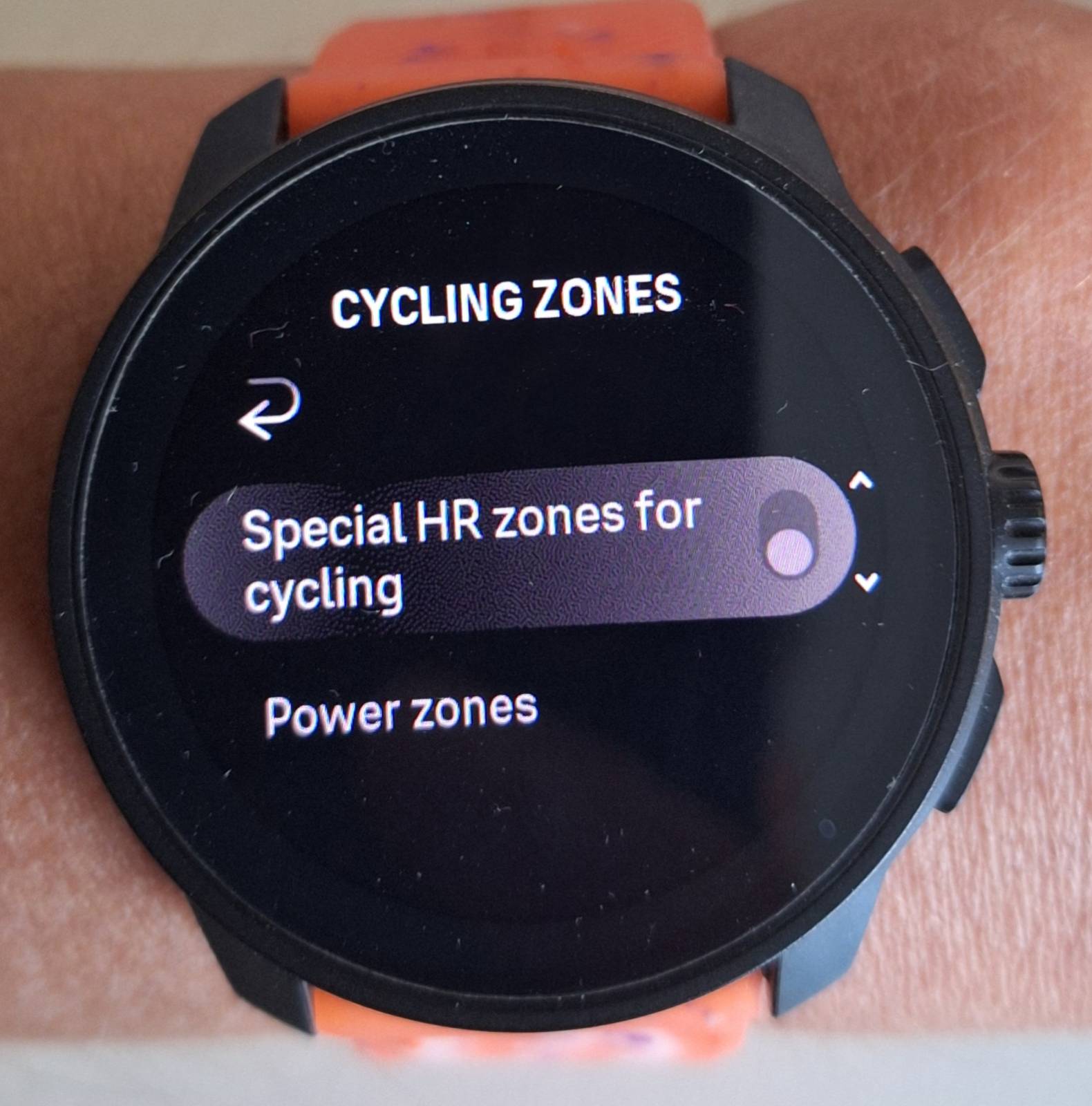

                      @sunter do you have, by any chance, custom HR cycling zones on your watch?
