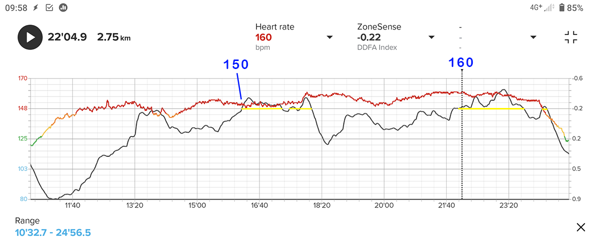

      @timecode it happened me the first time a few weeks ago. I didnt wet the belt before my run. I guess the connection was good enough for HR but not the r-r data. After a while probably my sweat made the connection better or something?
      isaziI timecodeT 2 Replies Last reply Reply Quote 2
      • isaziI Offline
        isazi Moderator @SamuelP
        @SamuelP indeed, if the data is too noisy it is not used for ZoneSense, data needs to be quite clean to be used.

          @SamuelP good hint, thanks. I will try it again tomorrow and keep this in mind.

                    @Brad_Olwin just fyi, today I ran again with the HR strap and as you can see time spent in each zone on the watch is different as in the app. There’s again a gap at the end. I am sure it’s not an issue with the strap, it’s wet, fairly new and a brand new battery.
                    Brad_OlwinB SportsfreundS 2 Replies Last reply Reply Quote 2
                    • Brad_OlwinB Offline
                      Brad_Olwin Moderator @timecode
                      @timecode the watch is real time and the app calculates from synced data. Those are very similar IMHO 30s ± for VO2M does not seem like much.
                      Don’t know about the end, perhaps R-R data is noisy from strap drying or static from tech shirt, don’t know. I have not seen this in my experience.
                      Vector/T6c/Ambit 3 Peak/S5 Copper/S3/S7 Ti/S9 baro Ti/S9P Ti/S9PP Ti/Vertical Ti/Race Ti/RaceS/Ocean/Wing
                      timecodeT 1 Reply Last reply Reply Quote 0
                      • timecodeT Offline
                        timecode @Brad_Olwin
                        @Brad_Olwin ah ok, I thought data in watch == data in SA. Good to know, thanks. Will “investigate” further.
