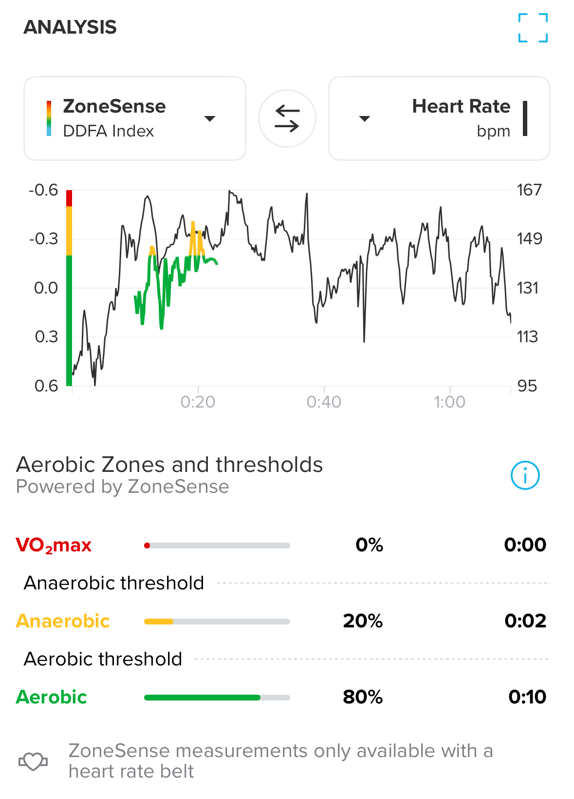

                            This keeps happening when using Zonesense a lot. I am able to see data on my watch during an activity, but in the app the graph looks like this. HR strap is connected, HR data is there. Any idea why this is happening?
                            Brad_OlwinB SamuelPS 2 Replies Last reply Reply Quote 1

                              @timecode Is this true for all exercises? Do you have old ones with a strap prior to ZS release? Those will show ZS as well.

                                @Brad_Olwin it’s not every exercise, sometimes it’s like this - there’s a chunk missing at the end of the excercise or some drops:
                                Today I was checking Zonesense quite often on my watch during the excercise and I saw data. It’s just missing in the app.
                                brechtvbB Brad_OlwinB 2 Replies Last reply Reply Quote 0

                                  @timecode sometimes I have the impression by opening the big graph or swapping the data in the display for other measurements, more data (complete) pops up, odd, and a bug in the end.

                                    @timecode it happened me the first time a few weeks ago. I didnt wet the belt before my run. I guess the connection was good enough for HR but not the r-r data. After a while probably my sweat made the connection better or something?

                                      @SamuelP indeed, if the data is too noisy it is not used for ZoneSense, data needs to be quite clean to be used.

                                          @isazi would be nice if suunto app could tell the quality of the data(like runalyze), would help with all the confusion 😅

                                            @timecode If the HR belt dries and/or you have a tech shirt and dry belt it can cause problems. I thoroughly wet my belt before I run and I typically sweat enough that the belt stays wet. If you stop and dry out it could also be an issue.
