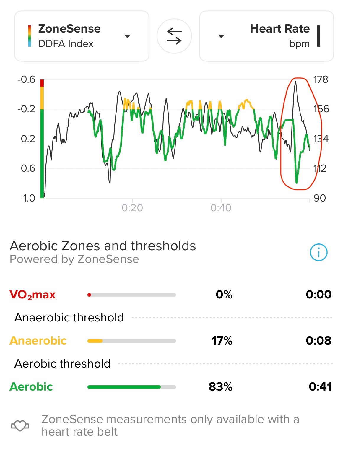

                          • timecodeT Offline
                            timecode @thanasis
                            @thanasis this happened to me just now. My HR was 176, Zonesense shows a huge drop. Not sure how to read that.
                            Brad_OlwinB 1 Reply Last reply Reply Quote 1
                            • Brad_OlwinB Offline
                              Brad_Olwin Moderator @timecode
                              @timecode ZS needs minutes to adjust. What you saw is normal. Your HR dropped a lot before it rapidly elevated at the end of your graph. ZS appropriately dropped then started rising. You were not long enough at a high HR! This has been stated many, many times here.
